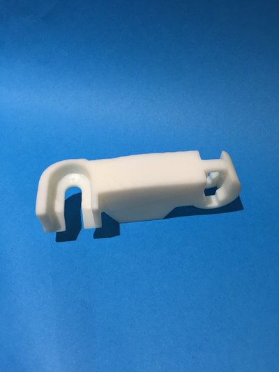

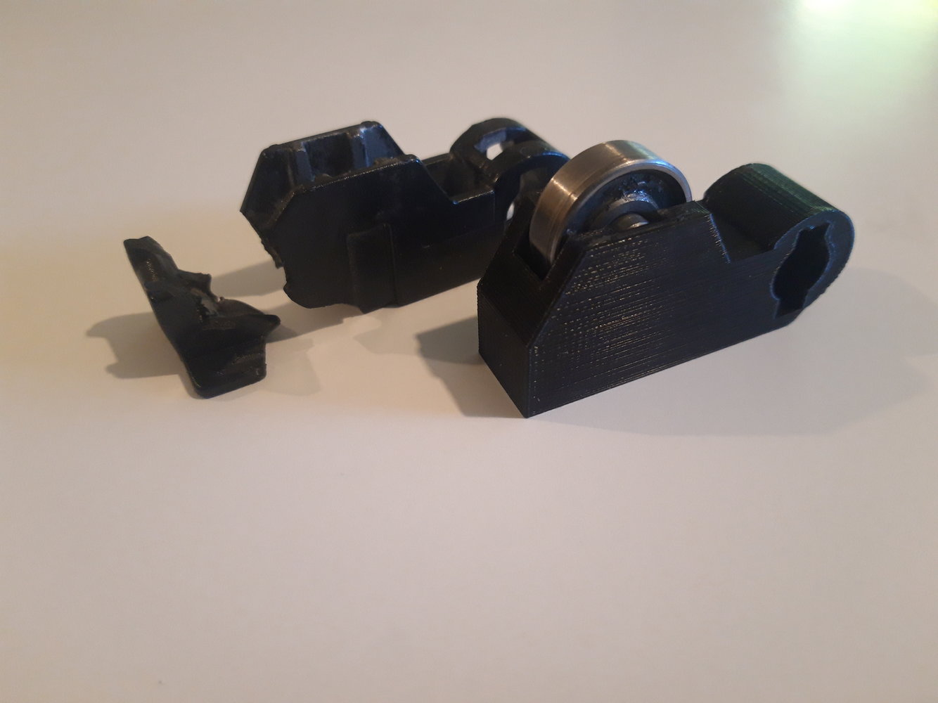

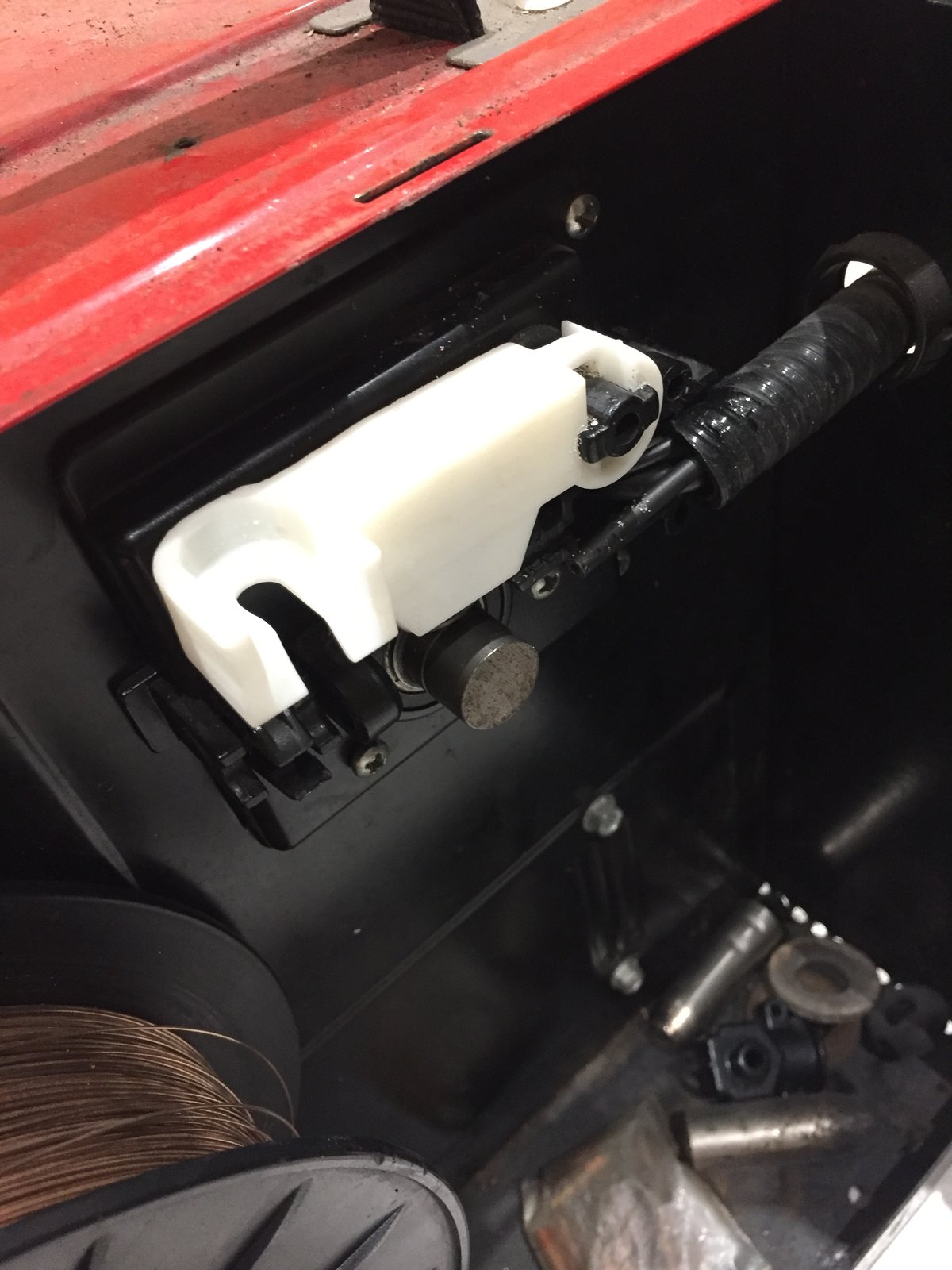

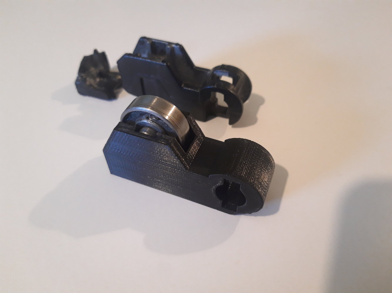

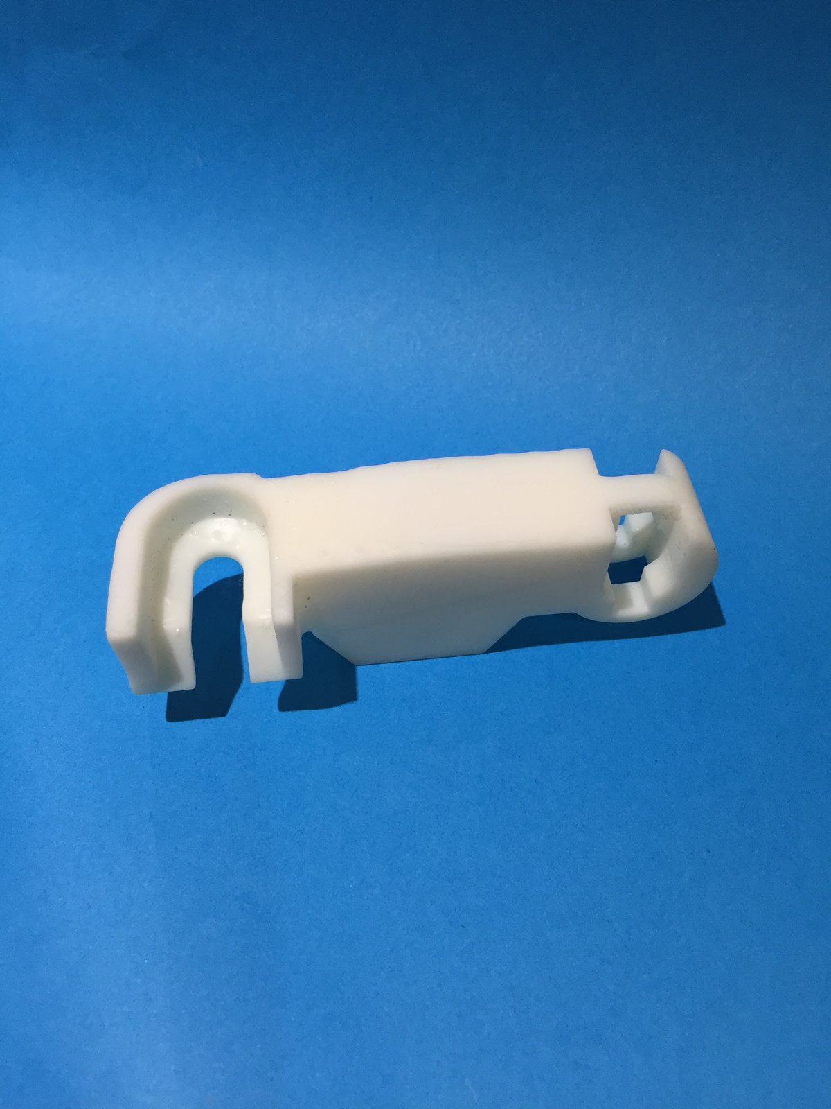

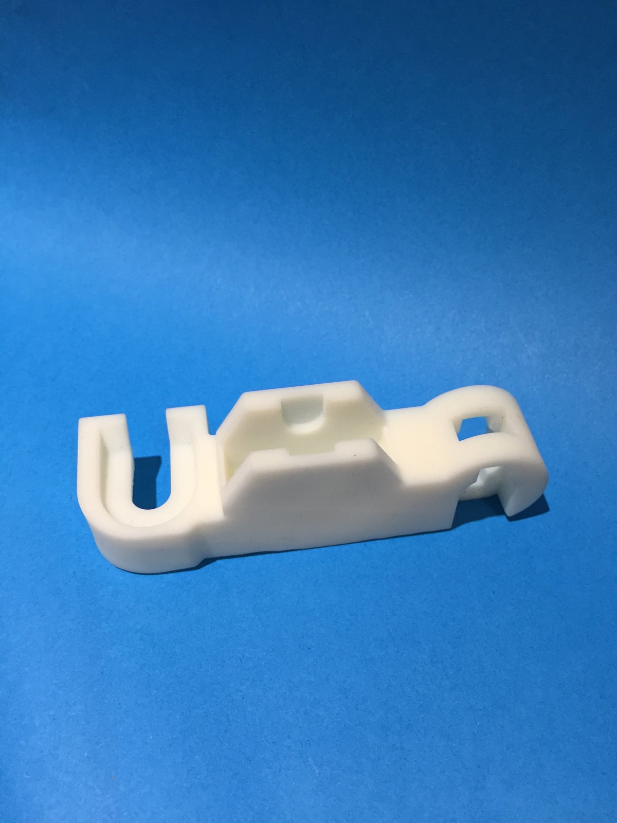

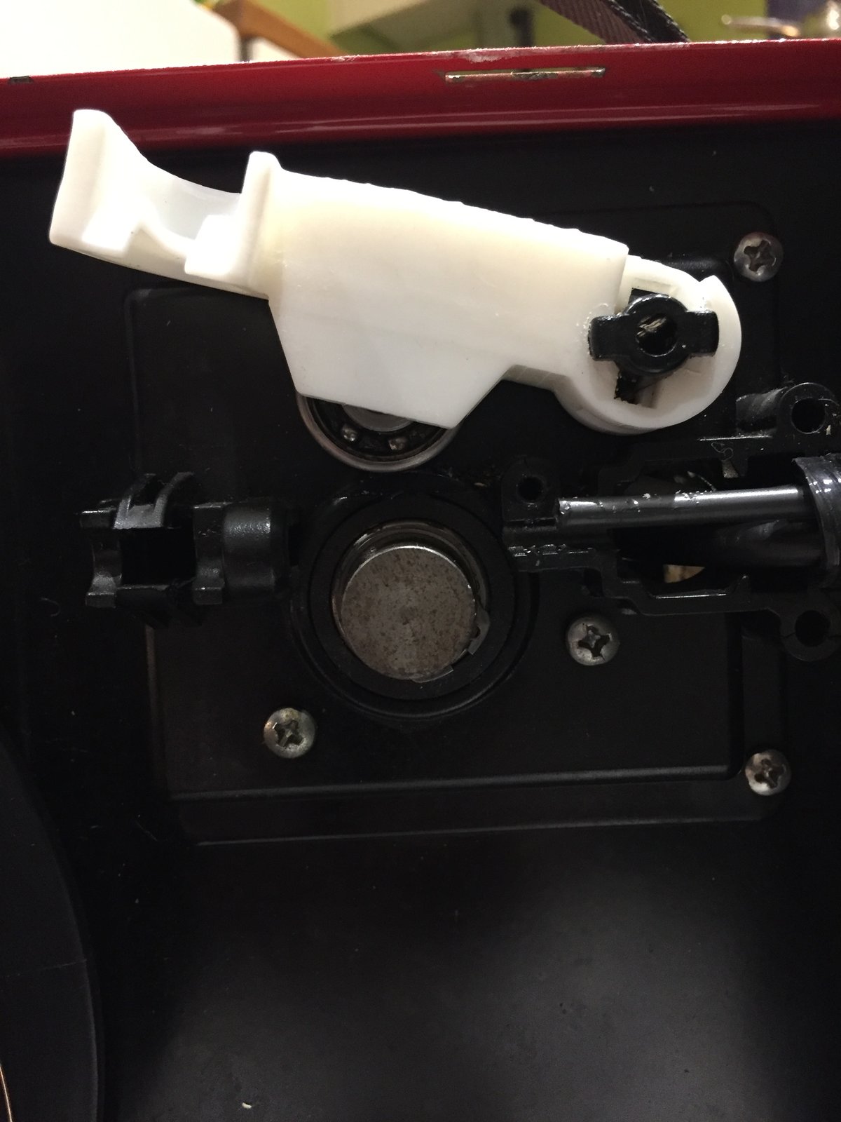

I finally got my Snap-on mig welder 130 turbo working after the wire feed tensioner broke.
What a nightmare you can’t get these parts anywhere not even for the Cebora 130 turbo and BOC mig master 130, which I’ve been told have the same parts.

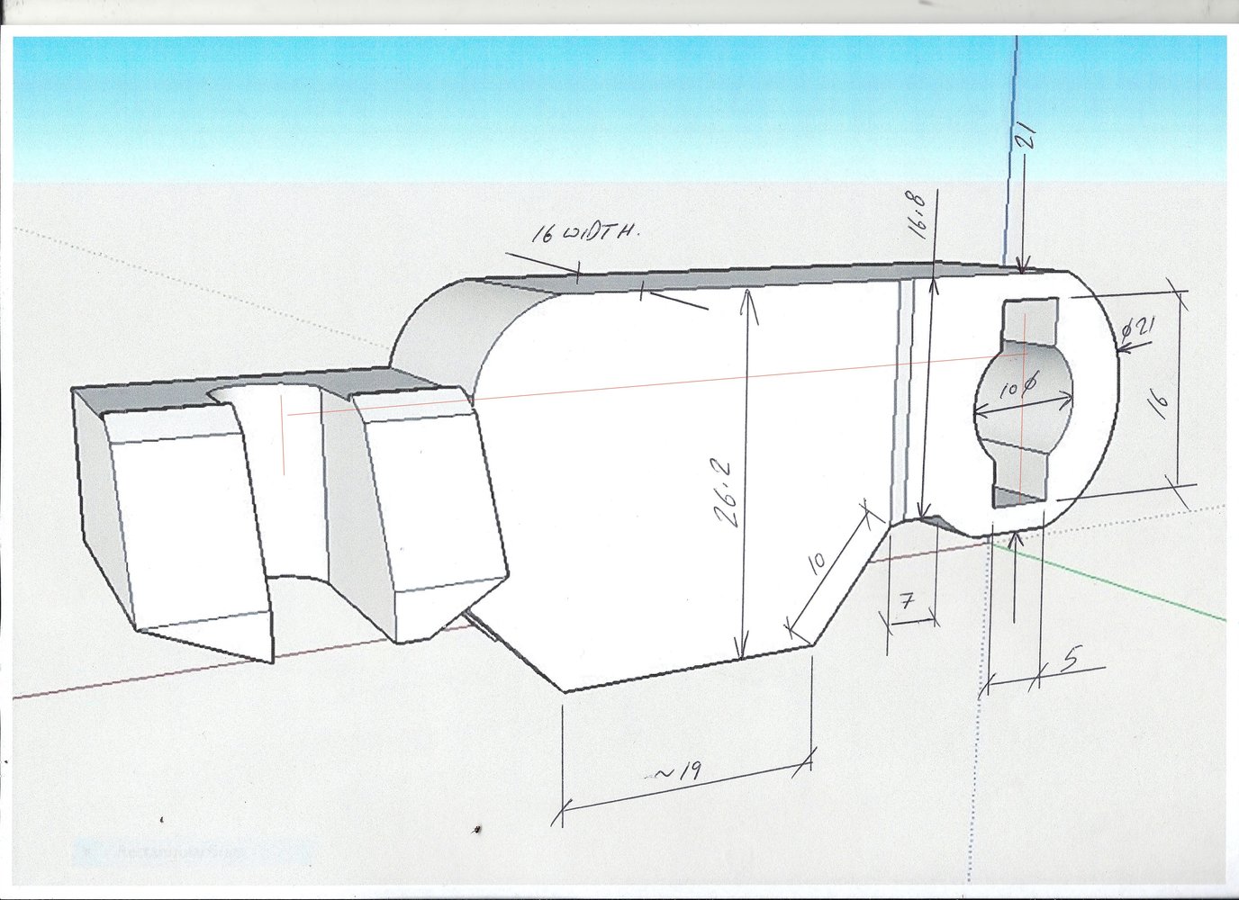

So had to make my own
Has any one else had this problem?

, and congratulations on your [fast] fix
need to do the same to mine, crappy plastic
also been told here they are a rebranded Cig130 twin
