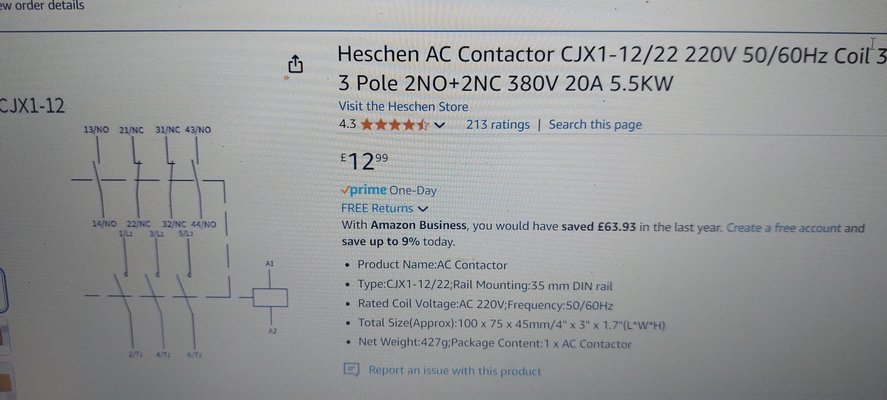

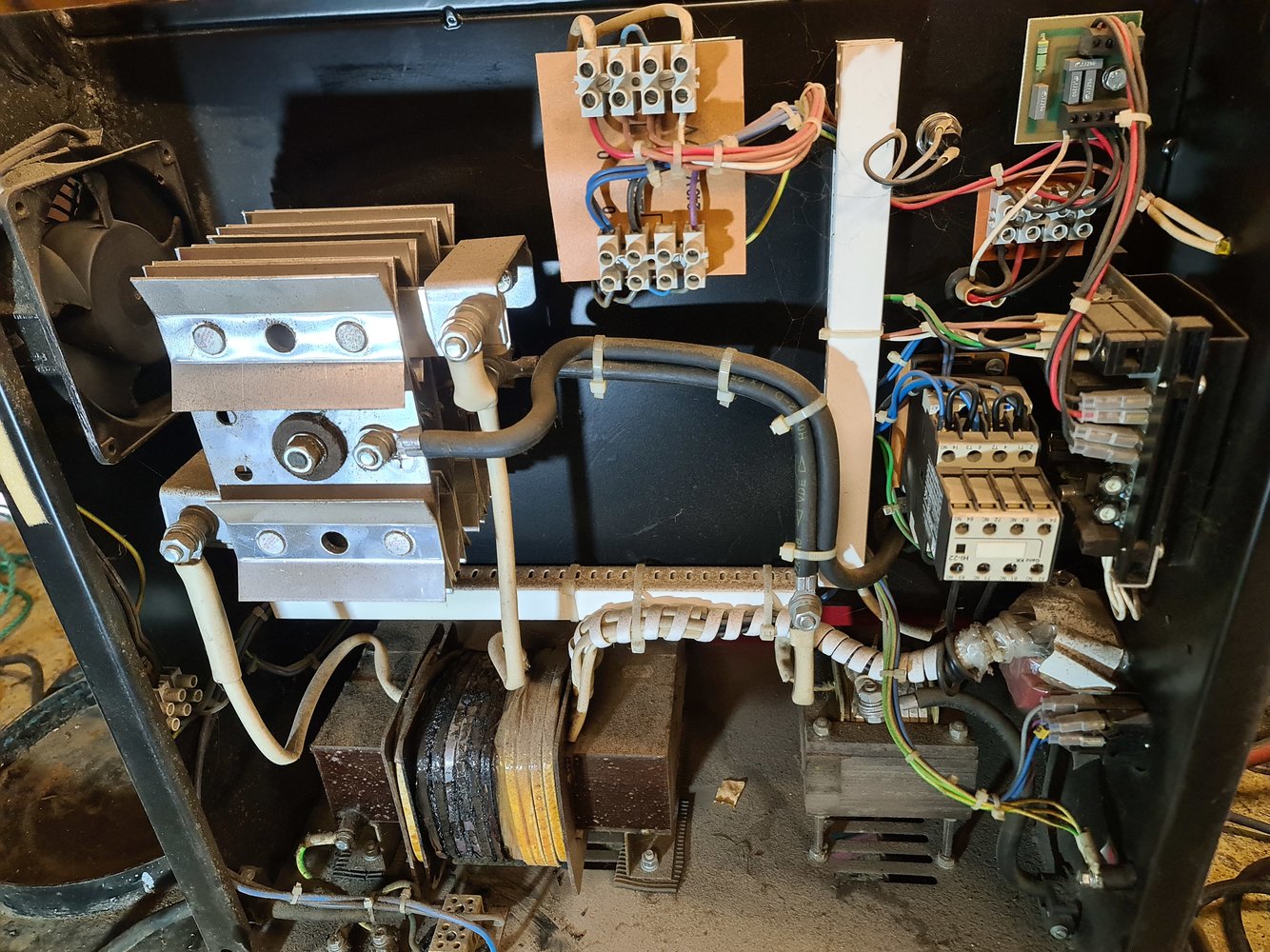

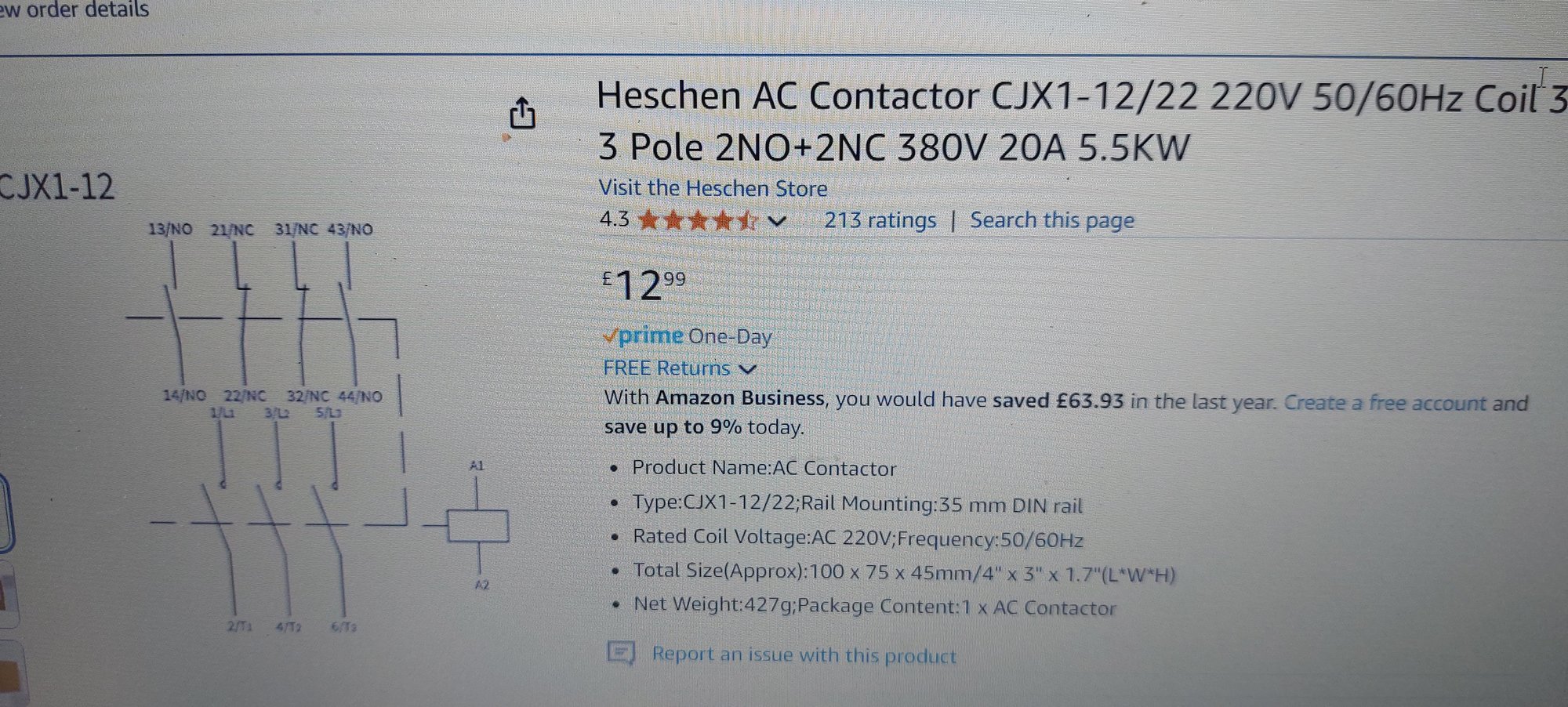

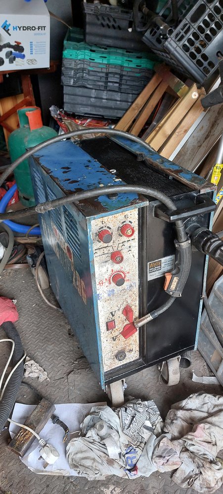

I have wirefeed and clunk from contactor and 240 volts on its coil.So it works ( appart from contactor contacts.
@eddie49not many contactors ( in my cheapskate price range) that have nc aux contacts. Amazon have 20amp with 2 aux nc and 2 no and I had a 10% off and have 2 25w 1 ohm resistors too.Note that the contactor has additional Normally Closed contacts, which put the bleed resistor across the capacitor bank at idle. There are actually two sets of NC contacts, with each end the resistor supported by the terminal screws.
Start bid was £35 but as I had to coordinate pick up and relatives visit I thought buy it now was best.I don't know the Spot and Stitch timer values - probably a few seconds I guess.
Rather than 1 Ohm ( a typo perhaps? ), the bleed resistor should be 27 Ohms:

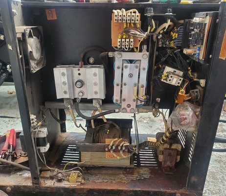

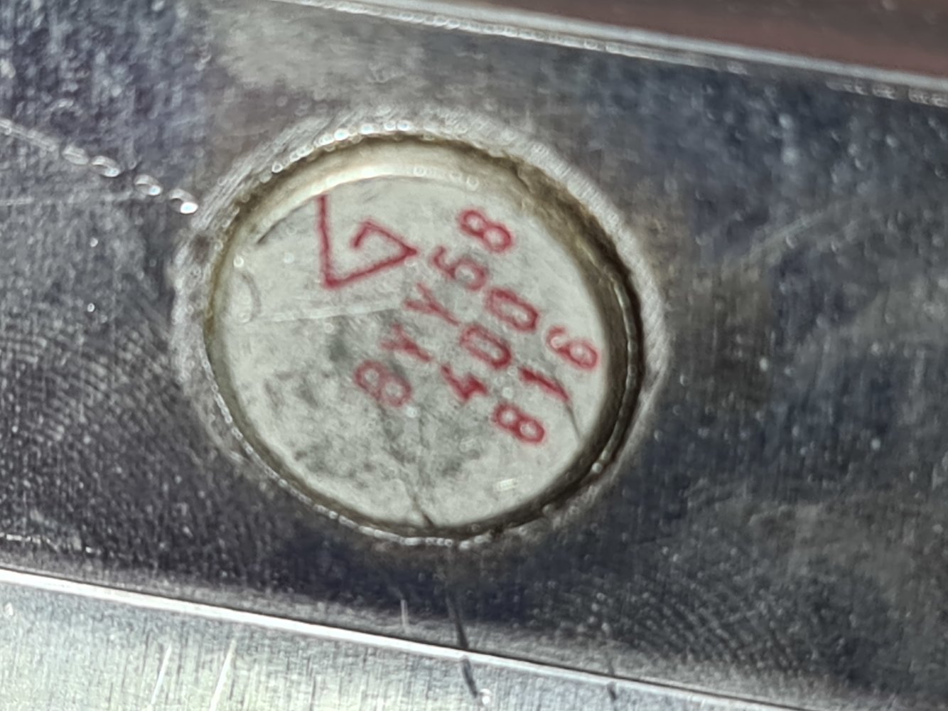

An Eland MIG for £50 is a really good bargain - especially since it apparently works!Tradesmig 245 mystery component
Was inside my tradesmig investigating wire feed issues which I believe is the pot and have a new one coming tomorrow but while there spotted what I think is some kind of 'add on' resistor which has at some point broken one of its legs as it was just left hanging. . Any ideas as to its...www.mig-welding.co.uk
Whilst waiting for window to swap contactor my mind drifted to " bells and whistles"Start bid was £35 but as I had to coordinate pick up and relatives visit I thought buy it now was best.
I was looking at capacitor prices and there's more than £50 worth albeit old.

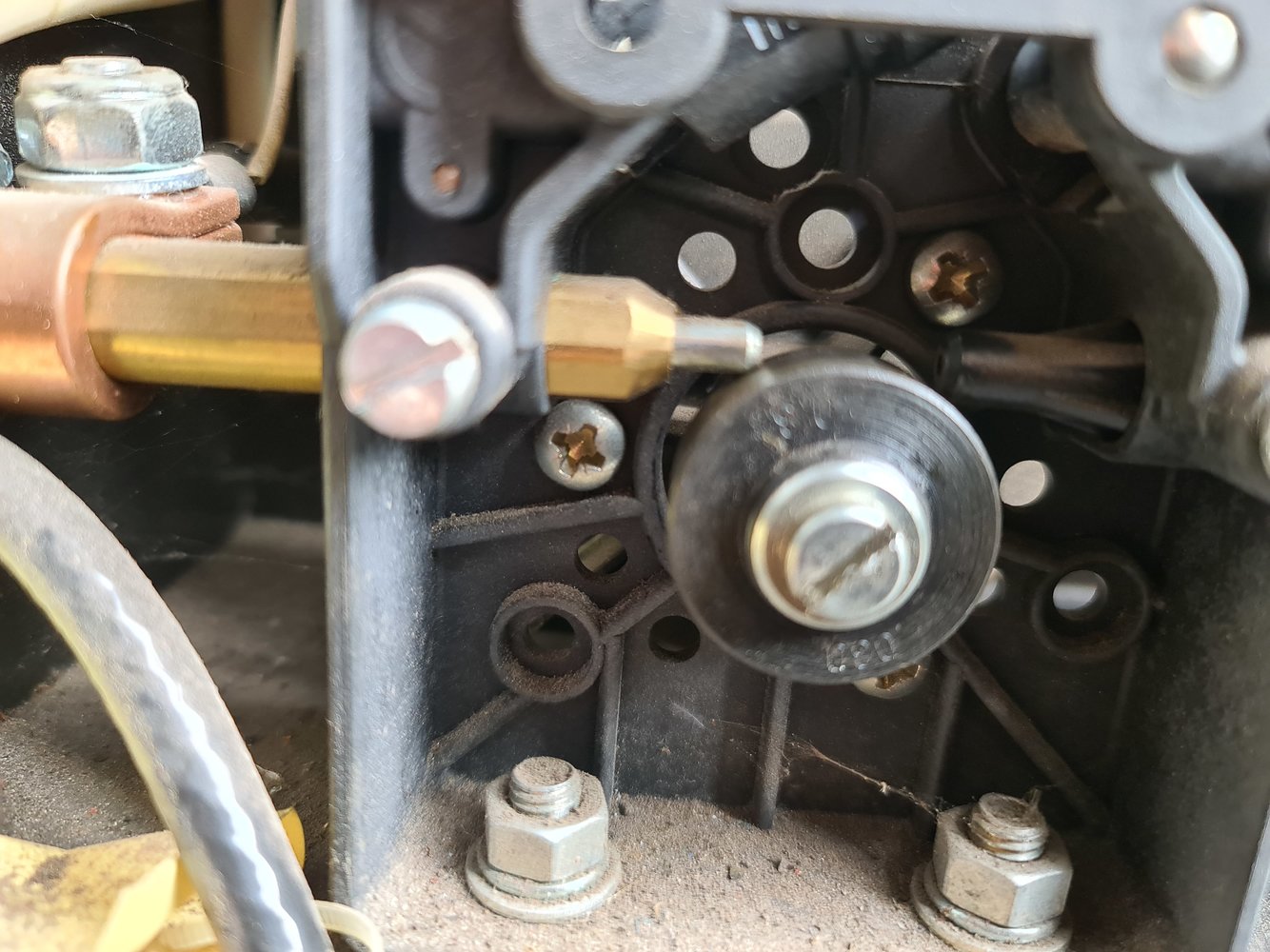

Hopefully get bits fitted tomorrow. I only have .8/1 drive roller and .7kg .8 wire but sure I can bodge for a test

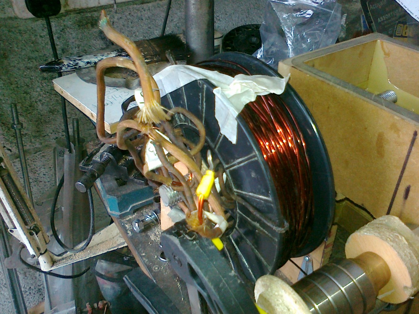

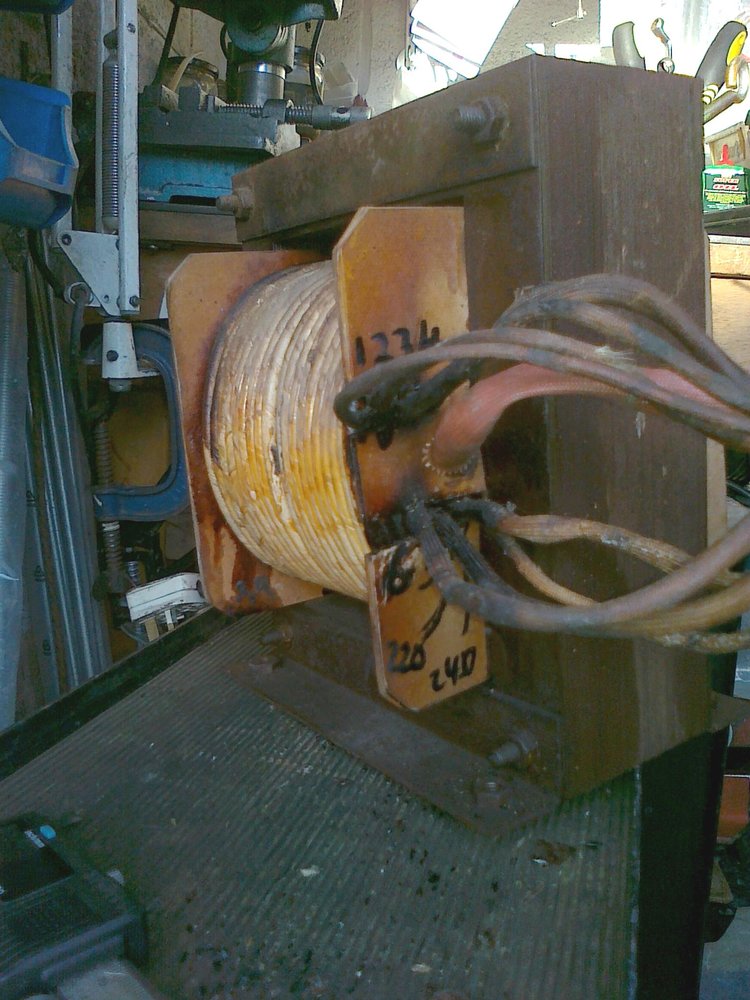

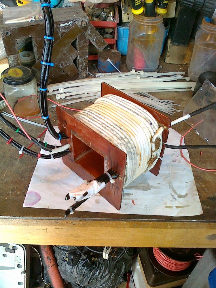

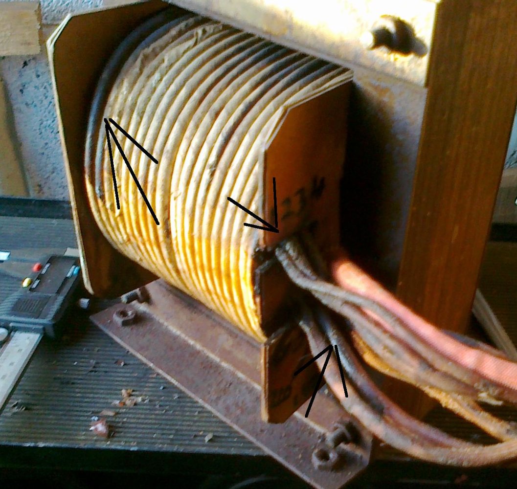

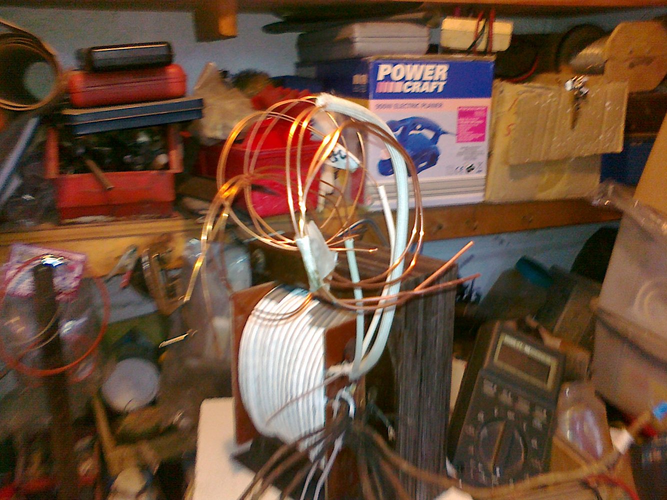

That does look fun doesn't it. Haven't fully tried the eland but think it was better choice! Although you have to say he was honest......OR ..just rewind the original burnt primary with copper (and fix the rectifier diodes) .....that sounds like an exciting project

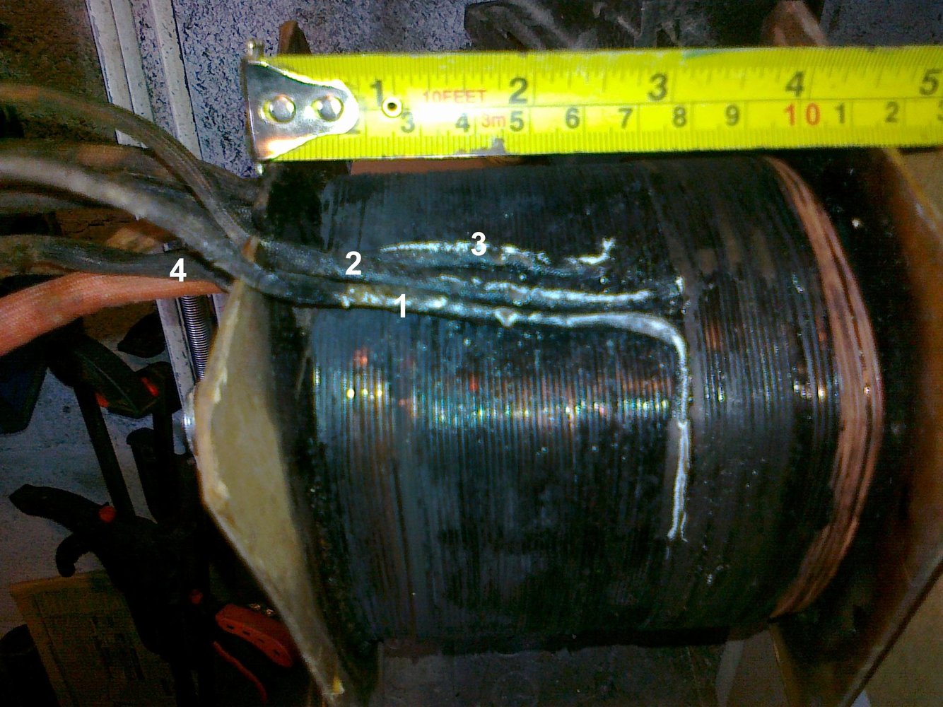

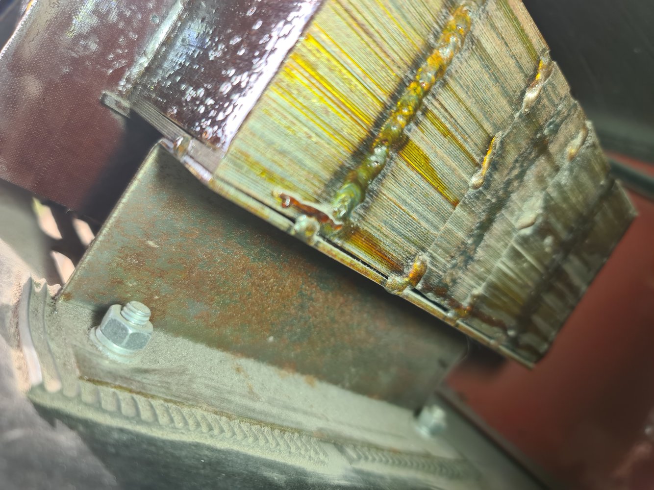

Good point. I originally bought this as a spares machine for an autolynx 3 that I have (that one produces some sublime welds) ......but I then started to see a learning opportunity in actually repairing the spares machine. I know that doesn't make strict sense but I do car restorations so I'm applying that mindset to welding machines, rightly or wrongly . So I'm not thinking purely economics here, but more about creating sustainable quality and broadening skills to boot. I do need something like a 101 in the theory of transformer welders so I'll gladly receive suggestions/links about this...Unless you are interested in repairing this welder yourself then it is beyond economic repair, old migs are cheap and if you like this model find another second hand and make a good one out of the two. The overheated windings are probably not the cause of the problem.
