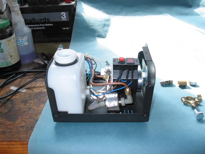

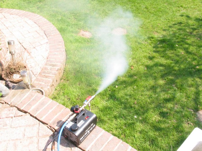

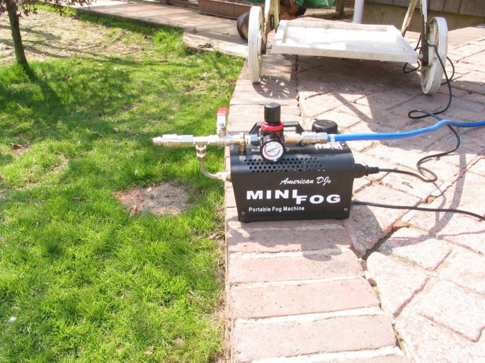

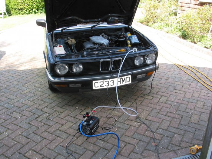

Here's one I made from an American DJ MiniFog. The regulator keeps the fog pressure down to 5-10psi. It worked pretty well but I was a bit concerned about the amount of moisture that it left in the inlet and therefore cylinders.
Do you reckon it would be ok to use baby oil to create actual smoke?
