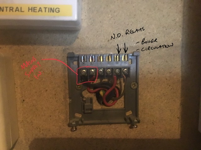

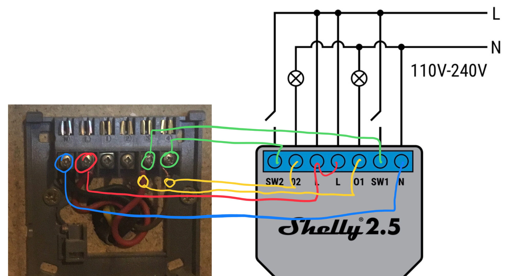

I haven’t used a Shelly but would have thought that the green connections wouldn’t be needed, just the yellow ones you have marked. Auto control from the controller and wifi from the Shelly in parallel. Are the SW connections for manual control for example a light switch as I don’t think you would need them
Yes it’s for manual control but if I take the output from the timer panel then it will act as a switch - I.e. if the wifi isn’t available it’ll still work the original way (important for W.A.F)
