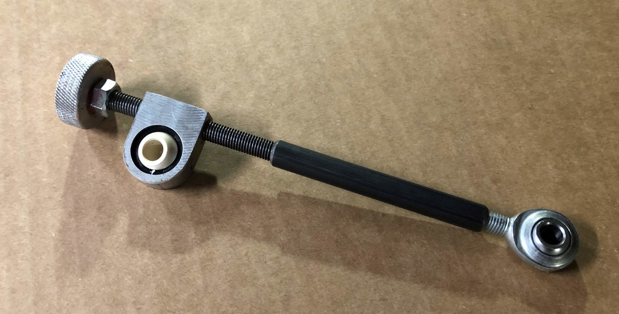

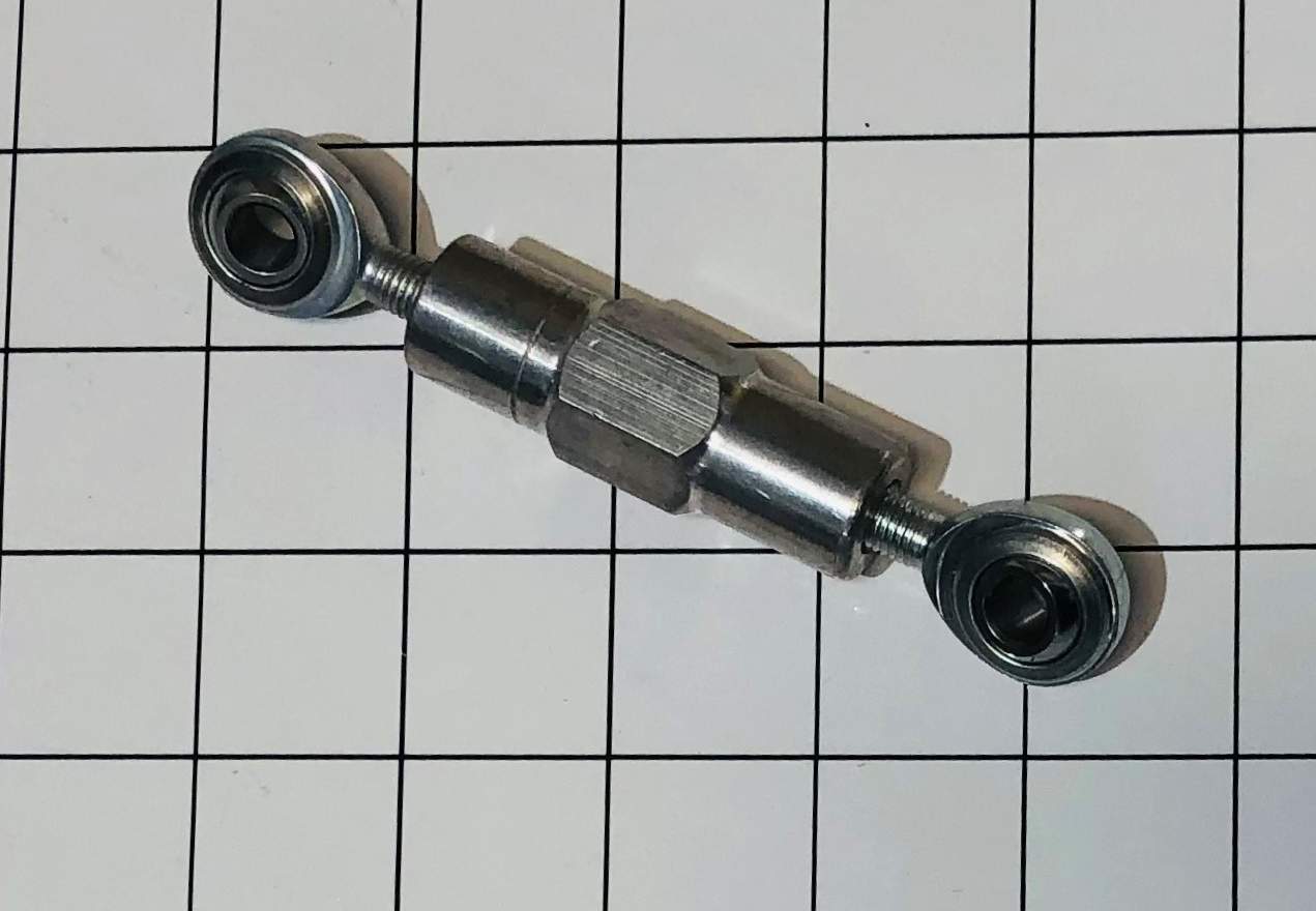

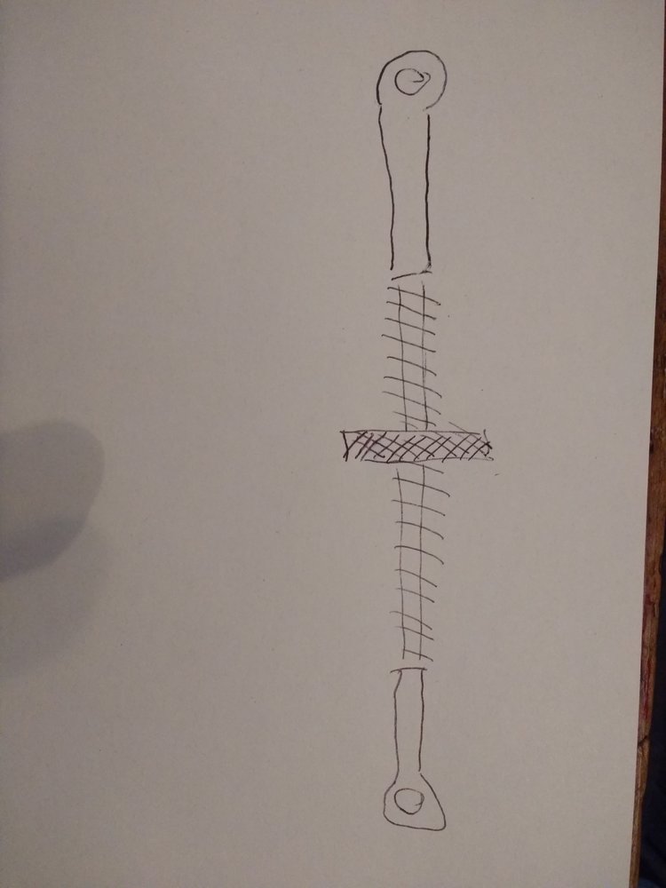

Just found these on zoro also -
www.zoro.co.uk
(theres the matching RH ones also)
They sell RH and LH threadded bar also, so i could get some of that, and, possibly, friction weld a knurled "somthing" in the middle, and get a nice looking repair for more than pocket change, but not the £500 or so it will cost me to buy the parts from the manufacturer (whom ive found still exists)
These are the original parts -
Believe me, id rather just buy them, but each arm requires two of the top one, and one of the bottom one, at just under 40usd each, and then an 18usd bracket (which is just a trimmed bit of angle really)
times 4, as there are 4 arms.
So im looking at about £500 once the vat etc is on there.
Zoro wont be cheap, but it wont be half a grand either.
Dunlop BTL FPL-M06 F39 M6X1.00 LH Female Nylon Lin| at Zoro
Dunlop BTL - FPL-M06 F39 M6X1.00 LH Female Nylon Liner available at Zoro.co.uk - UK's Leading Supplier of DIY Tools and Supplies'
