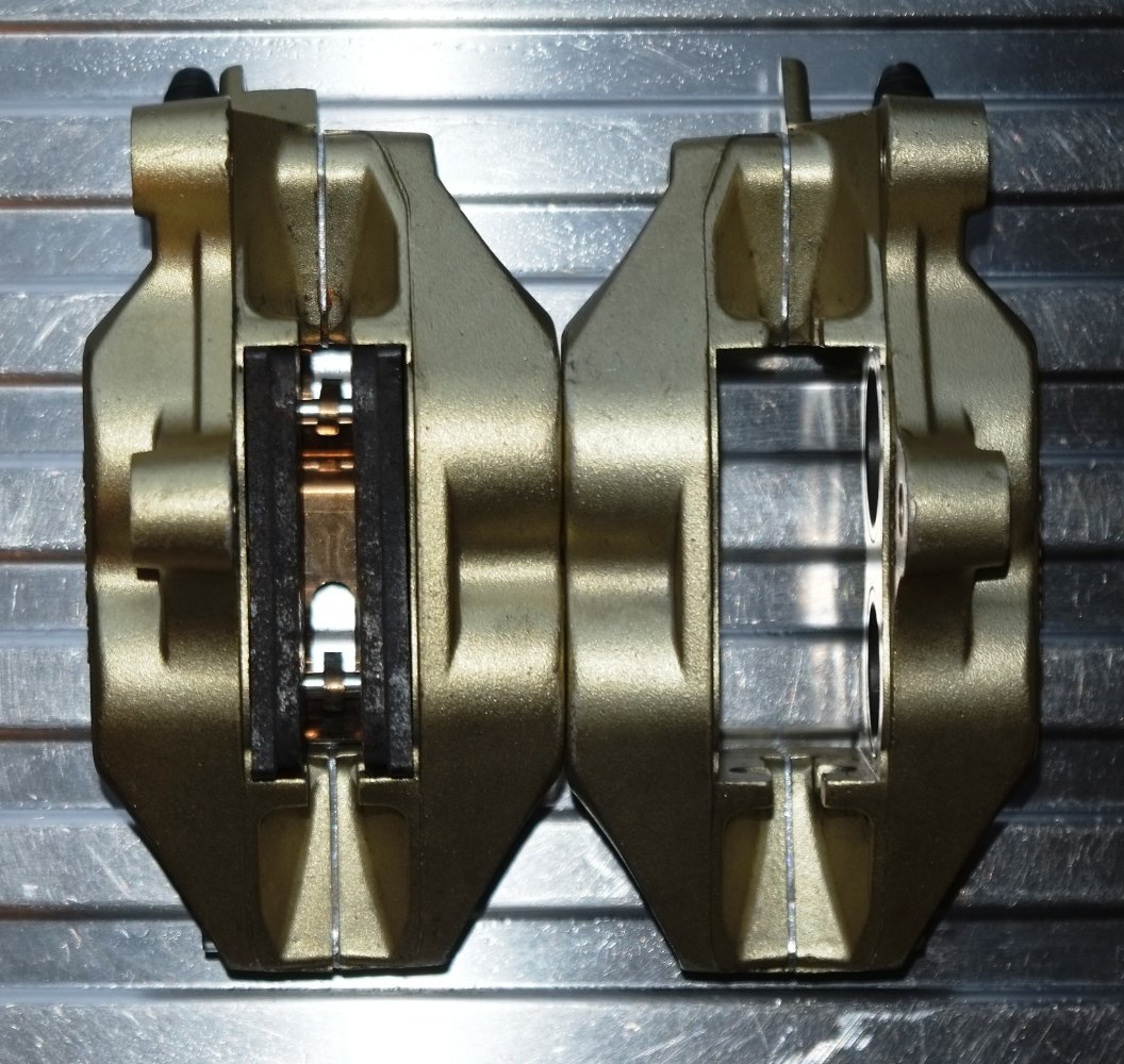

So you can make a seal that will go right through the new piece.of aluminium that will be the same o/d as the recess for the original one?
If you can't produce the drawing you could post the caliper to me
I've been down the route of skimming pads before and I've no intention of doing it again. You either wind up with inadequate backing material or inadequate pad material.

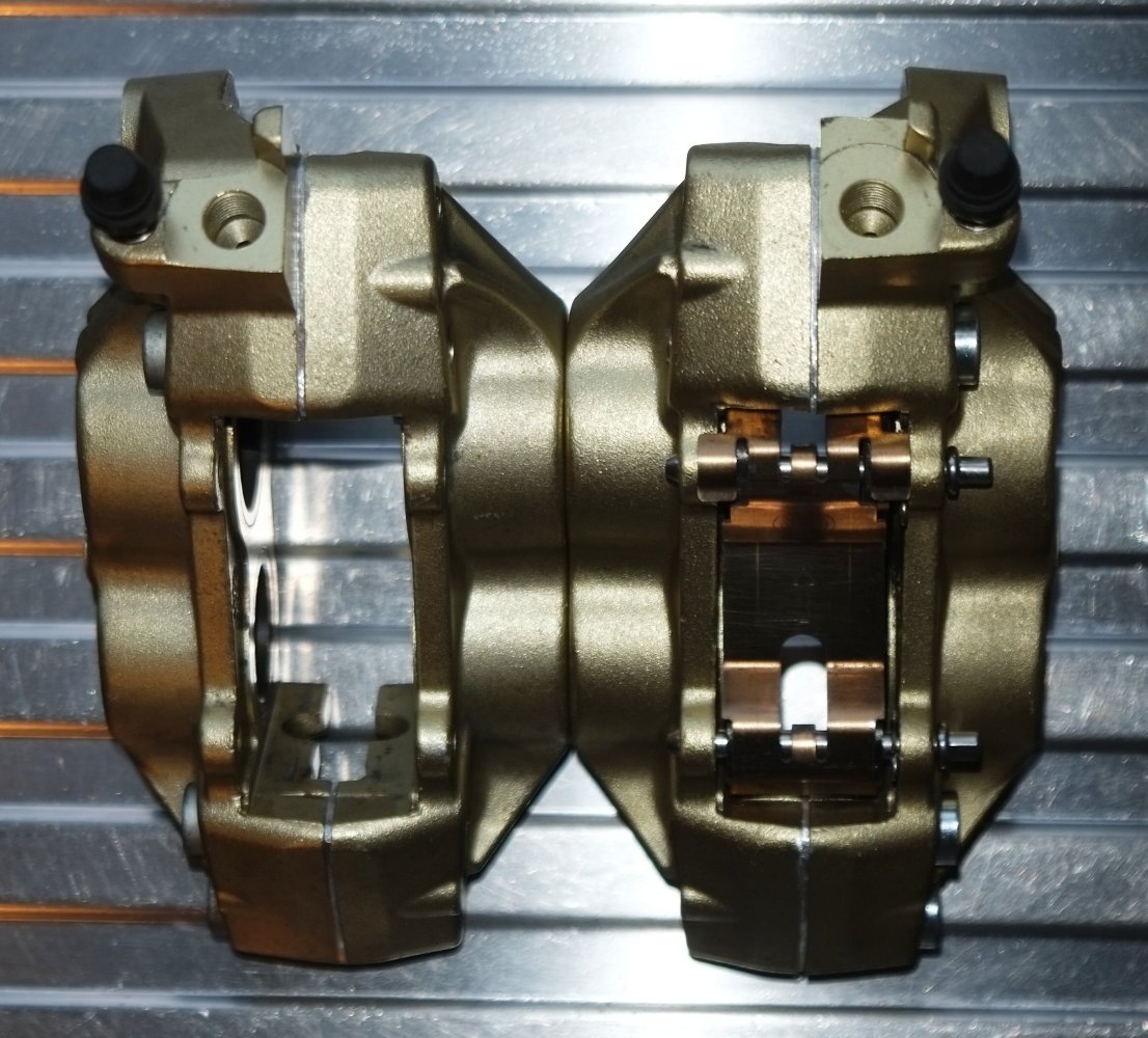

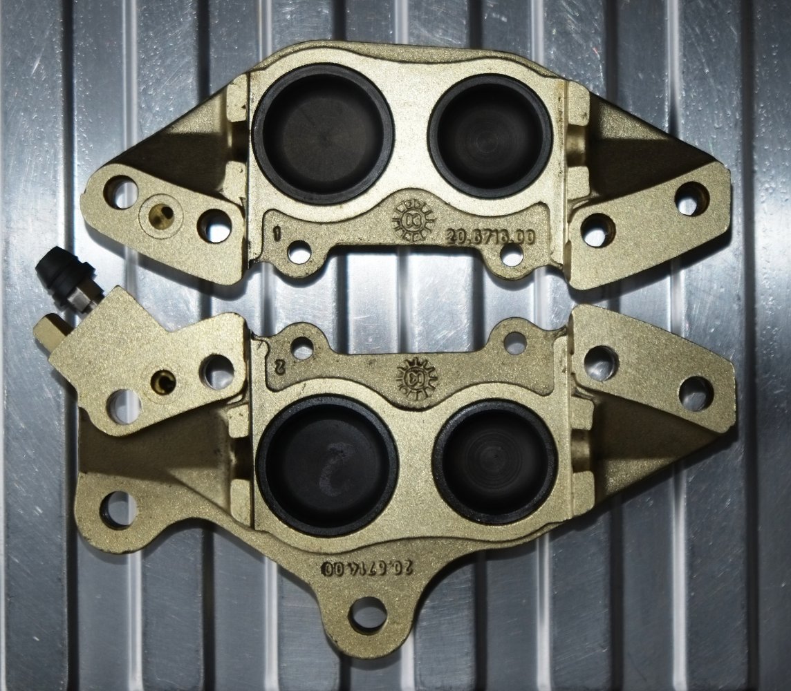

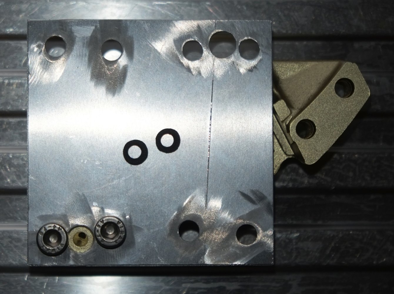

That's how I'd do it.Here's a photo of both halves of the RH caliper. Only the 'inside' half of the caliper has a groove machined to accept the sealing o-ring; you can just make out the witness mark of the o-ring on the 'outside' half. The groove on the inside half is machined to a depth of 1.2mm to accommodate the o-ring. With the 1.2mm distance piece in place the groove depth increases to 2.4mm, so I propose to use some EPDM mat with a nominal depth of 2.5mm to make o-rings to seal the two halves plus distance piece. I already have the EPDM mat, and an 'o-ring' made in this manner has worked perfectly on a different set of calipers for well over a thousand miles.

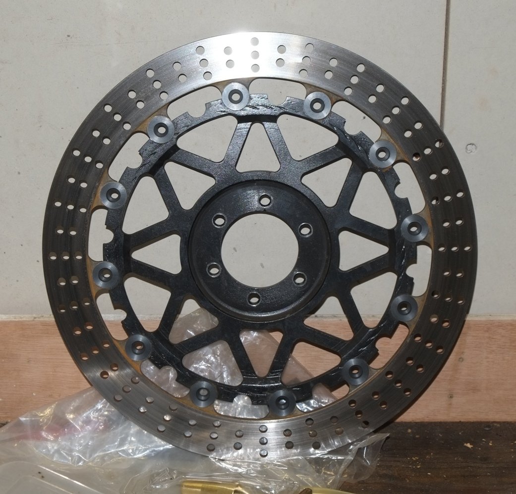

Some time in the (hopefully) near future it will become SEP (someone else's problem). I'm currently readying the bike for sale. To be fair, there's loads of life left in the discs, so it's not like I'm dumping a problem on someone else. I'm reasonably sure that the discs were an HRC 'kit' part. The original carriers were magnesium, which is pretty trick, even today.If that's the only disc like it you've seen . . when it wears out . . .?
