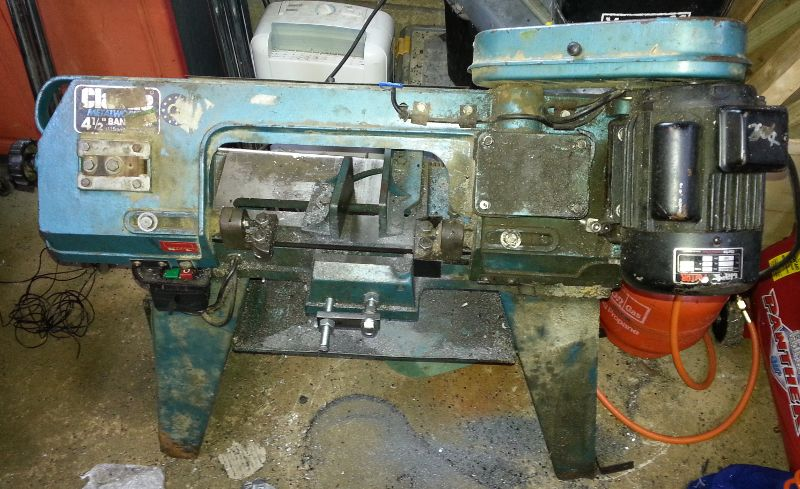

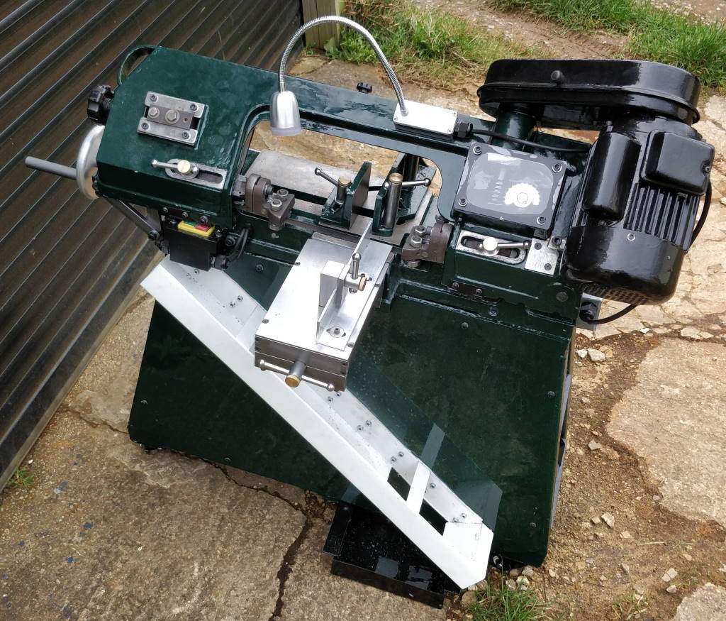

The Clarke saw is probably the one you're most likely to find second hand for a good price as they're relatively common. They take a bit of fettling to get them to cut straight and even but once set up, they just keep going. I never change the belt speed. I bought mine for £80 on ebay. It was pretty battered and shabby, but it has cut through everything I asked it to and it's still going after about 10 years of reasonably regular use, although a couple of years ago I gave it some TLC and it looks a bit different now:The Clarke saw is sounding a bit more appealing![]()

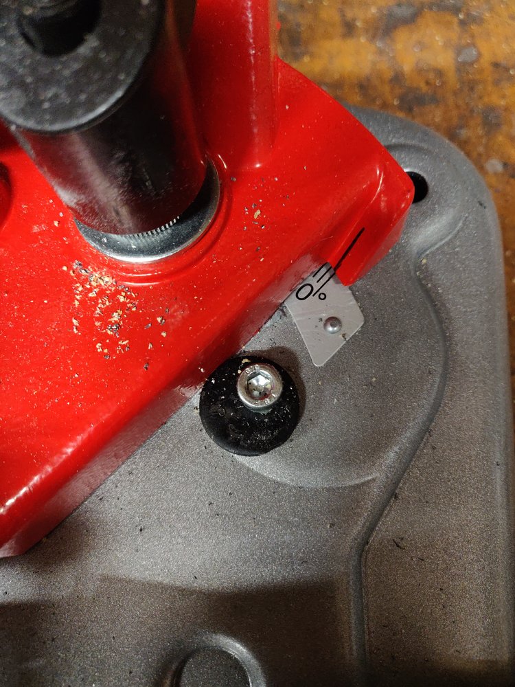

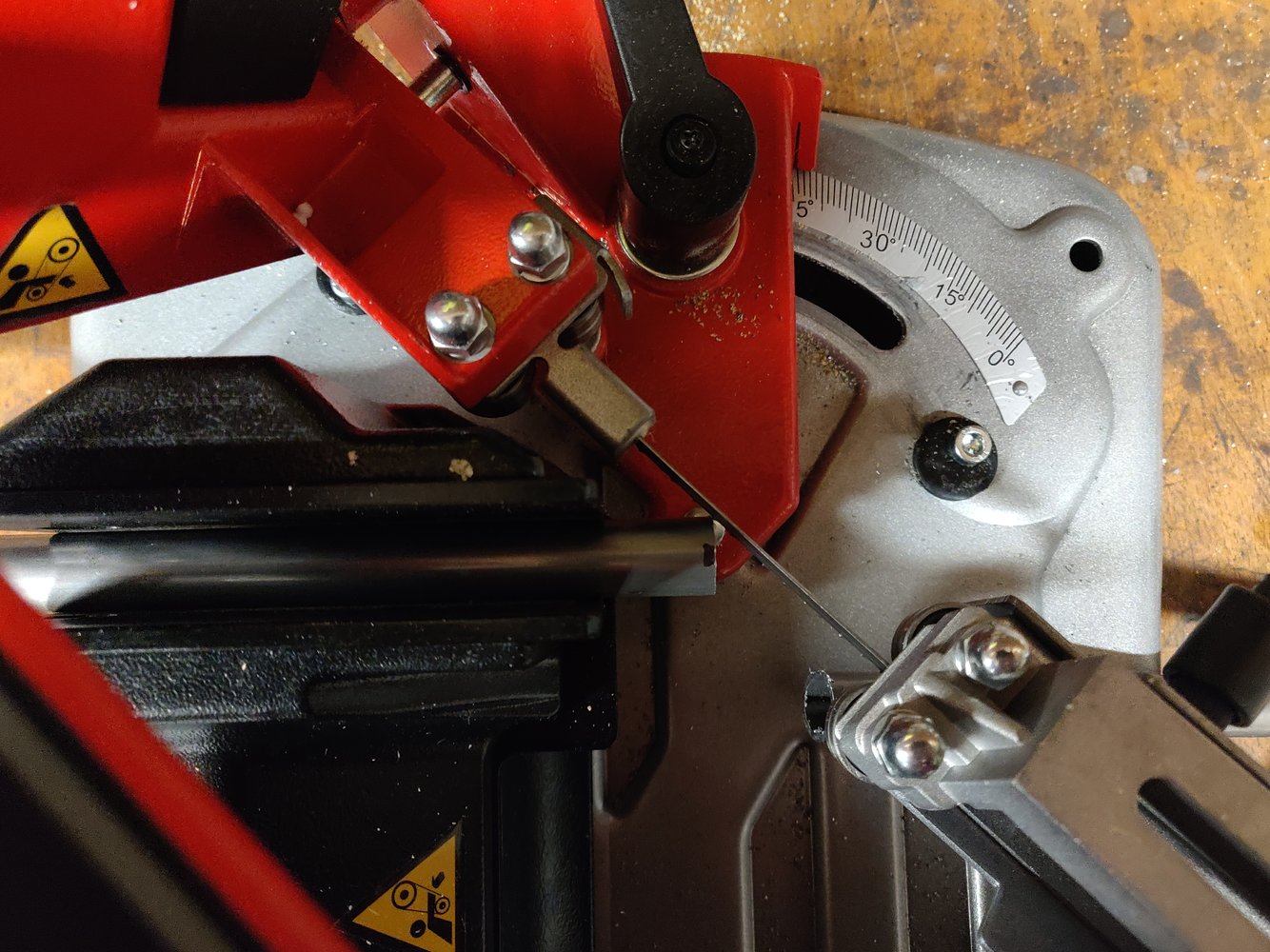

I wasn't thinking of using a mitre stand as I already have a big vertical bandsaw. I just thought it would be useful for cutting bits off the ends of big lengths of box etc.I went for the Femi 782XL. What sold it for me is that it's much faster at changing the mitre angle compared to the Clarke.
Just started using it. It's very smooth, it has some neat features. The geometry keeps the blade close to the vice as it swings through angles, so it's good at cutting small pieces. Neat cam for zero'ing the straight cuts.
