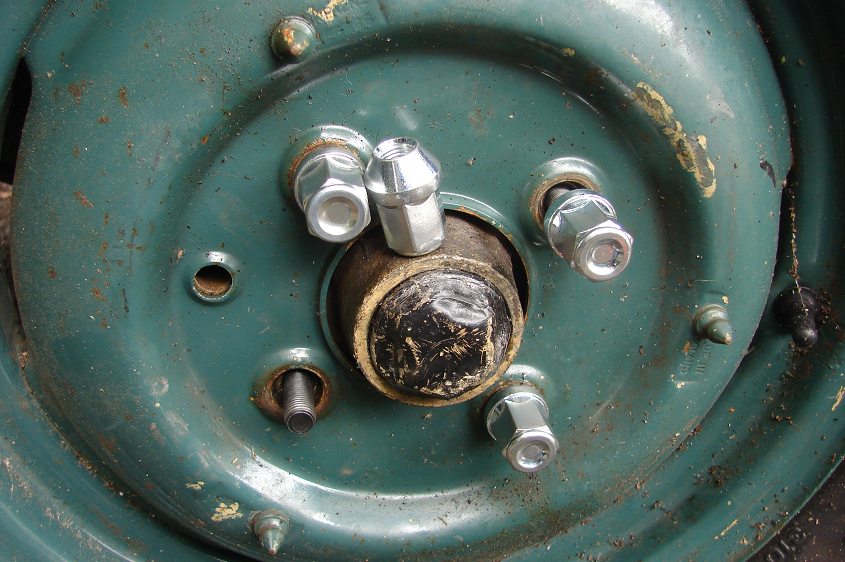

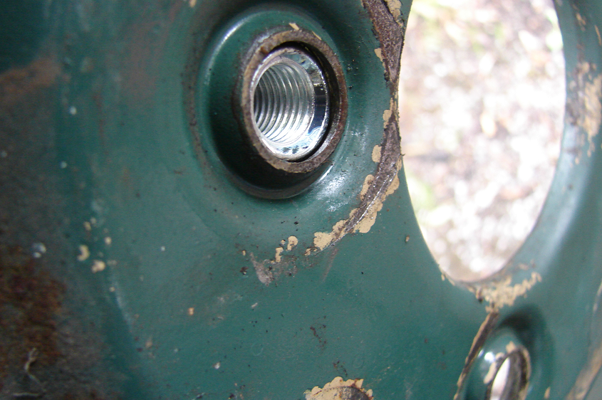

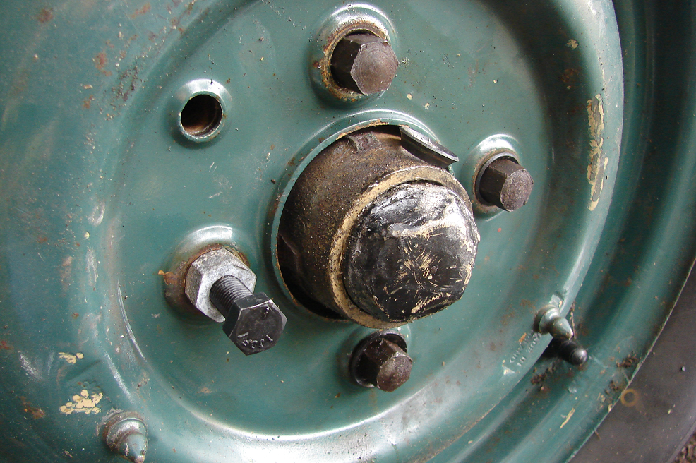

the nuts are 7/16 UNF but call for a 19mm AF spanner on the packet
19mm and 3/4" are the same size, I wish people selling stuff wouldn't mix imperial and metric measurements up, but I guess they think you are now more likely to have a 19mm socket than a 3/4" AF one. Have seen those three marks on bolts but never realised they are quality references. The R, S, T stampings are more common on imperial bolts.
