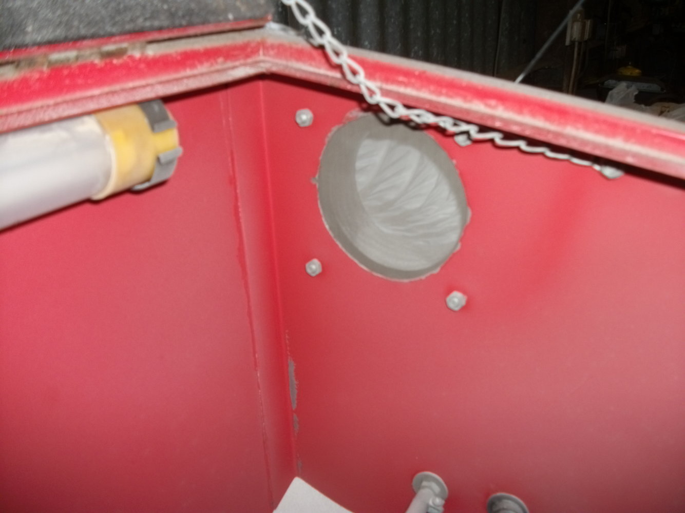

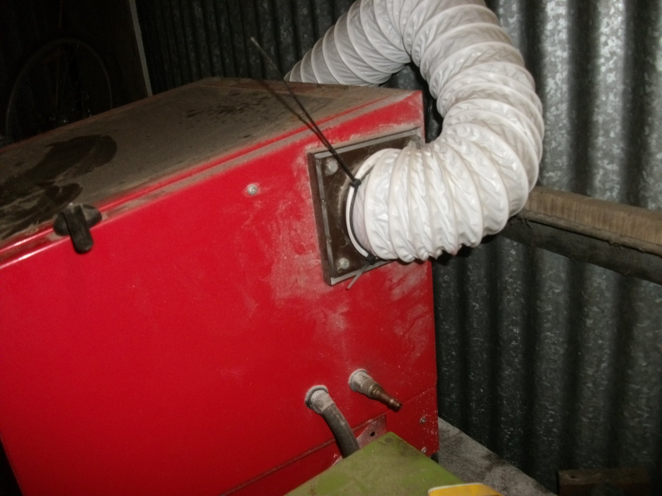

Vacuum cleaners are usually universal motors so should work with a basic speed controller, will be much quieter too.Also have a vacuum cleaner attached to the exhaust of the cabinet....I think theres too much suction, cant open the lid and the gloves get sucked into the cab
Yes there is a filter on the back of mine, as originally fitted…Make sure there is a port on the back of cabinet open to let in air else you will have issue you described.
You need a big filter for a vacuum cleaner and airflow across the cabinet with traps to stop larger media escaping. A K&N works well.Yes there is a filter on the back of mine, as originally fitted…
If you look at page 4 of the Clarke manual, fig 3Do you have a photo
no you dontYou need a big filter for a vacuum cleaner and airflow across the cabinet with traps to stop larger media escaping. A K&N works well.
a cyclone can be run sideways and be alot quieterA cyclone filter works well however do vacuums work well? I was under the impression you needed large air flow not high suction to get good dust extraction
Bigger than the small paper filter most are fitted with or you end up with vacuum in the cabinet instead of a flow of air through.no you dont
I have had an Earlex vacuum on both my cabinets over 20 years and swap it between them. A while back I added a small pair of cyclone filters to each cabinet to catch and separate the media. On the Earlex vacuum outlet I have a Hoover bag to reduce dust, the plan was to duct that outside into a box.A cyclone filter works well however do vacuums work well? I was under the impression you needed large air flow not high suction to get good dust extraction
