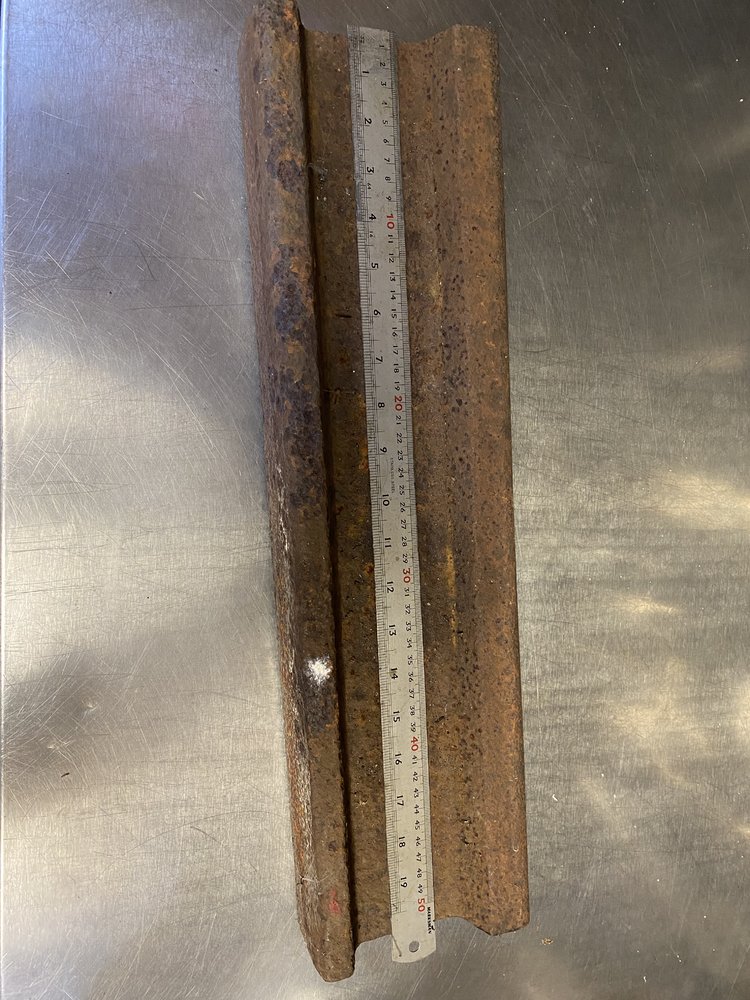

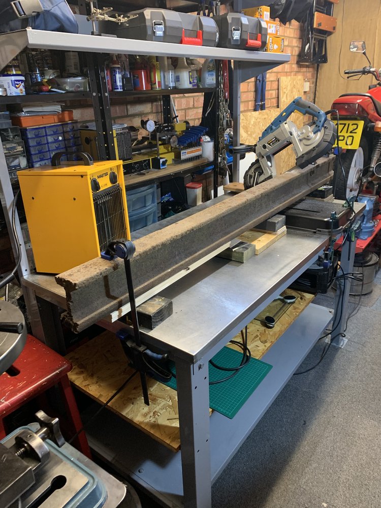

Something small to bash, bend, heat, straighten metal on, never really going to have a need for a real anvil - I know this has been done to death

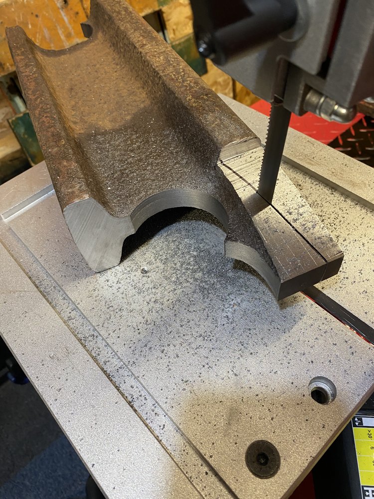

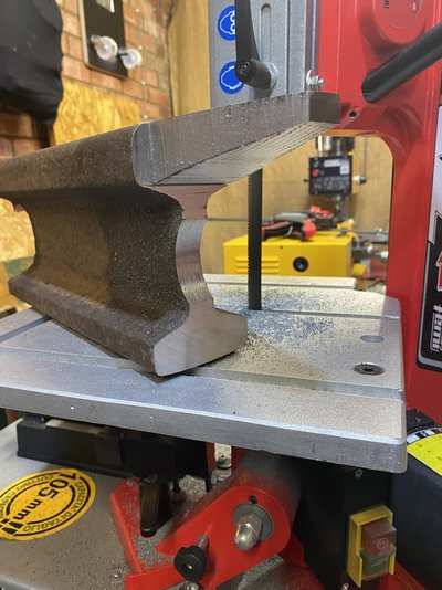

Cut off a bit of bullhead track to 16" length, which will be under bolted to a lump of wood which I will route out a bit to sit it in but also unbolt to stick in vice when needed.

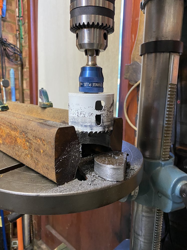

The Bosch hole saw set has been very good

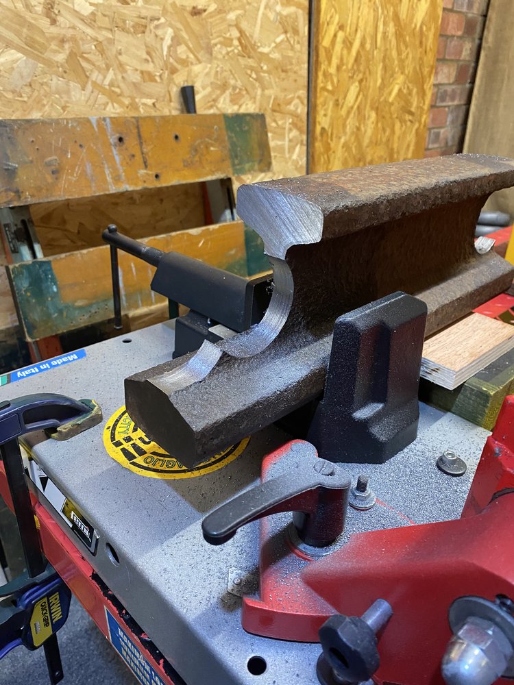

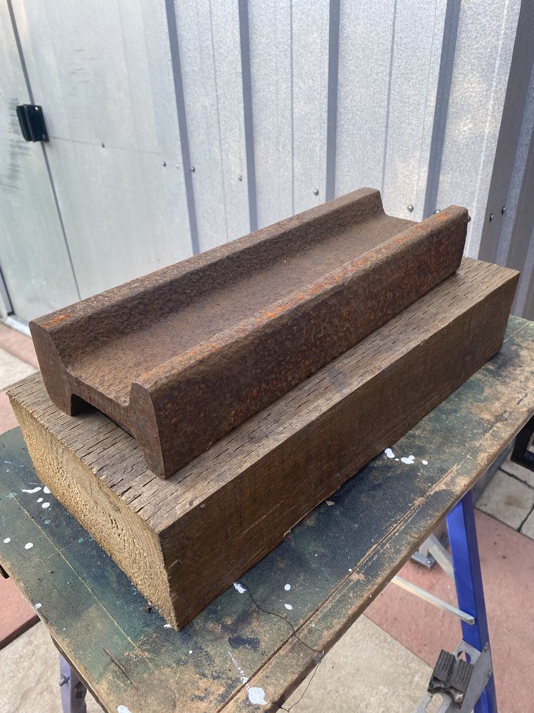

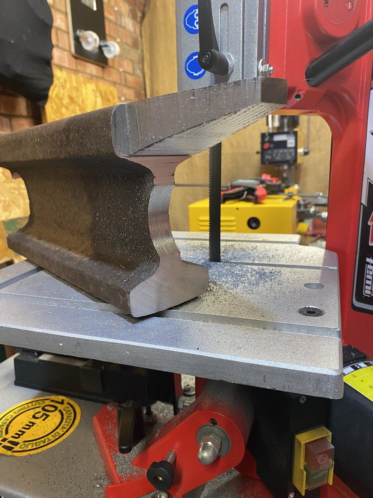

This stuff cuts nicely

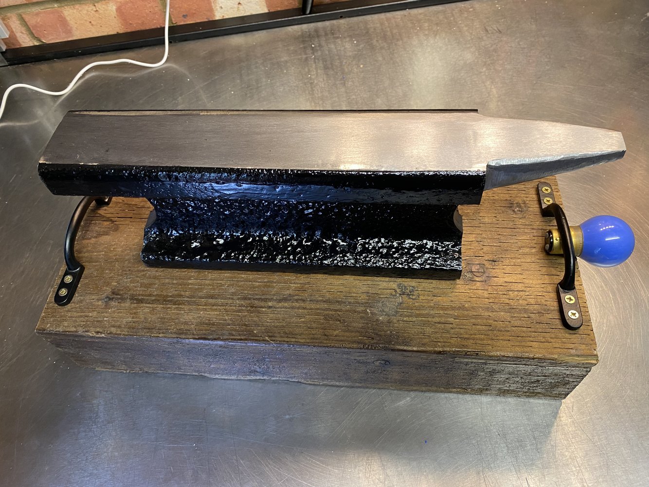

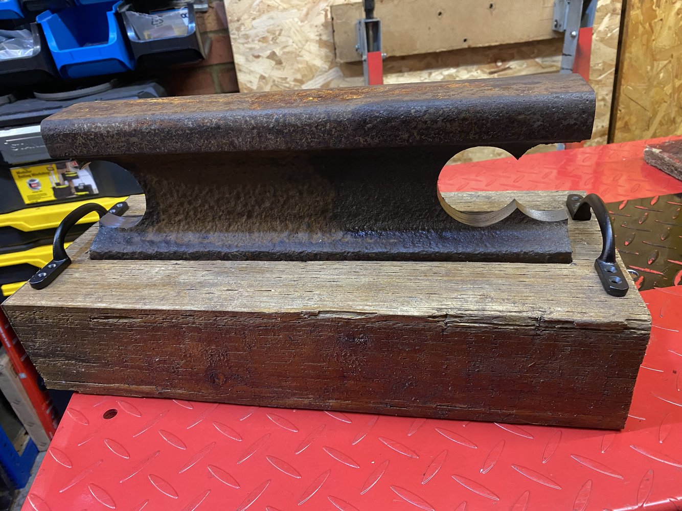

Lots of grinding next to flatten top and bottom & shape up horn, bit of paint maybe, and of course a lampshade fitment
