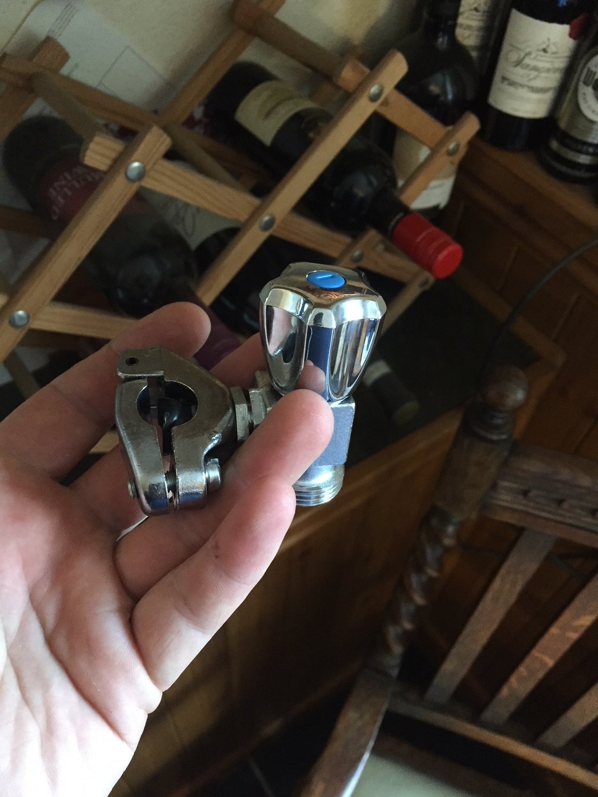

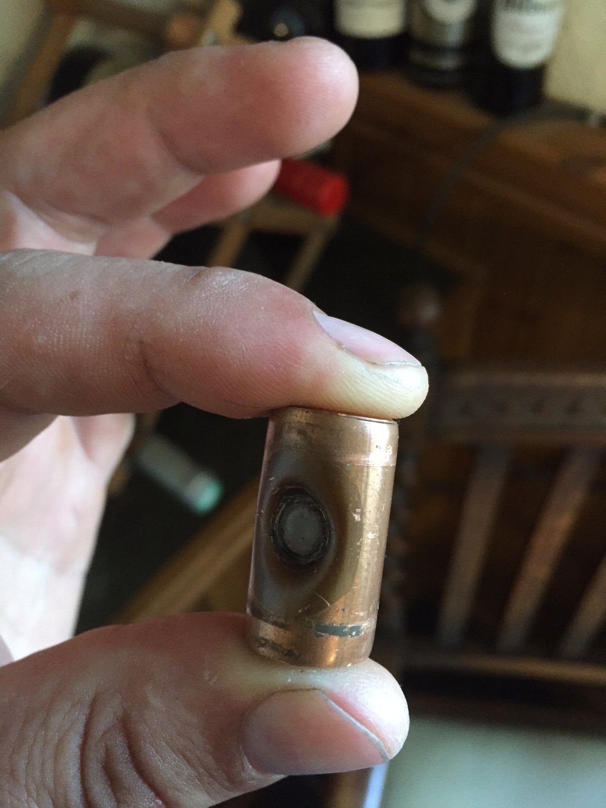

Since we moved into our new place 18 months ago, I have always thought the dishwasher left by the previous owners took a long time to fill. Anyway, today I got as far as looking at it. It certainly fills quicker. I hope it will wash better now it should fill properly!
They had used one of these useless bodges....
Anyone spot the problem?!
