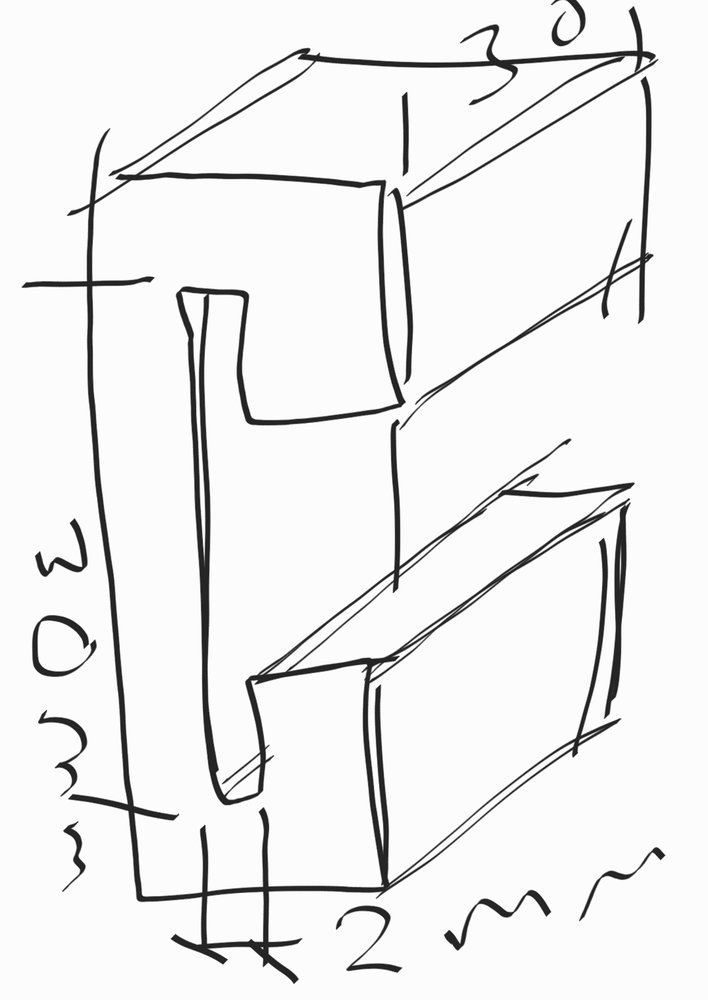

Excuse the phone notepad sketch...

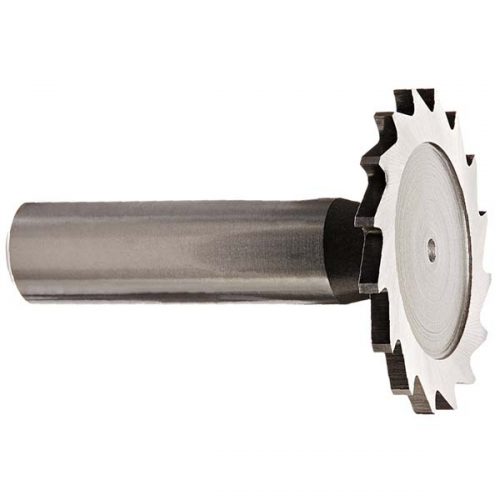

Ways to cut the 2mm grove, all I can think of is making a gash arbor, and tacking a sacrificial slitting saw on the end... use it to destruction then clean up shaft and tack a new one on...
Could I countersink the bore on a cutter and make a locking washer to retain it?
Taking out the middle section first with a normal cutter, then running a slitting saw through to cut the 2mm grove looks like an easy way to my untrained eyes.
Material potentially will be stainless, so a bit tough going.
