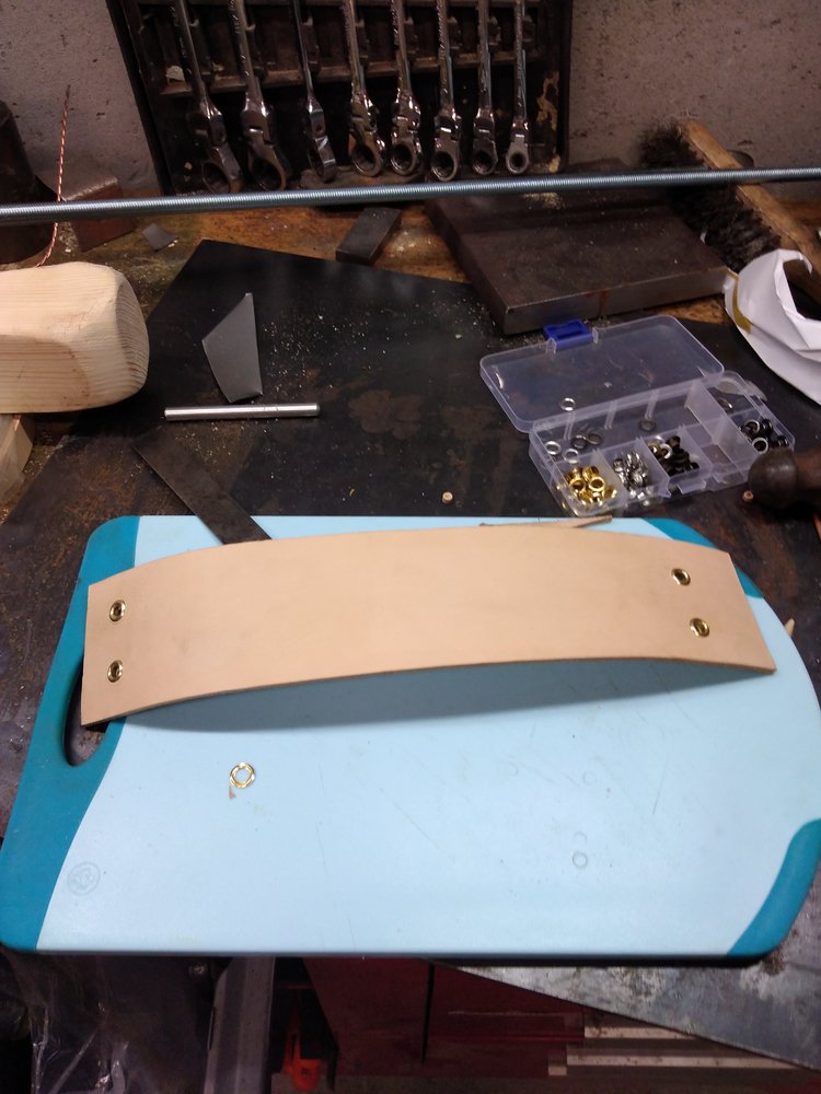

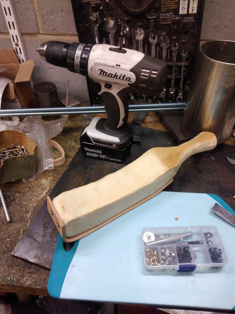

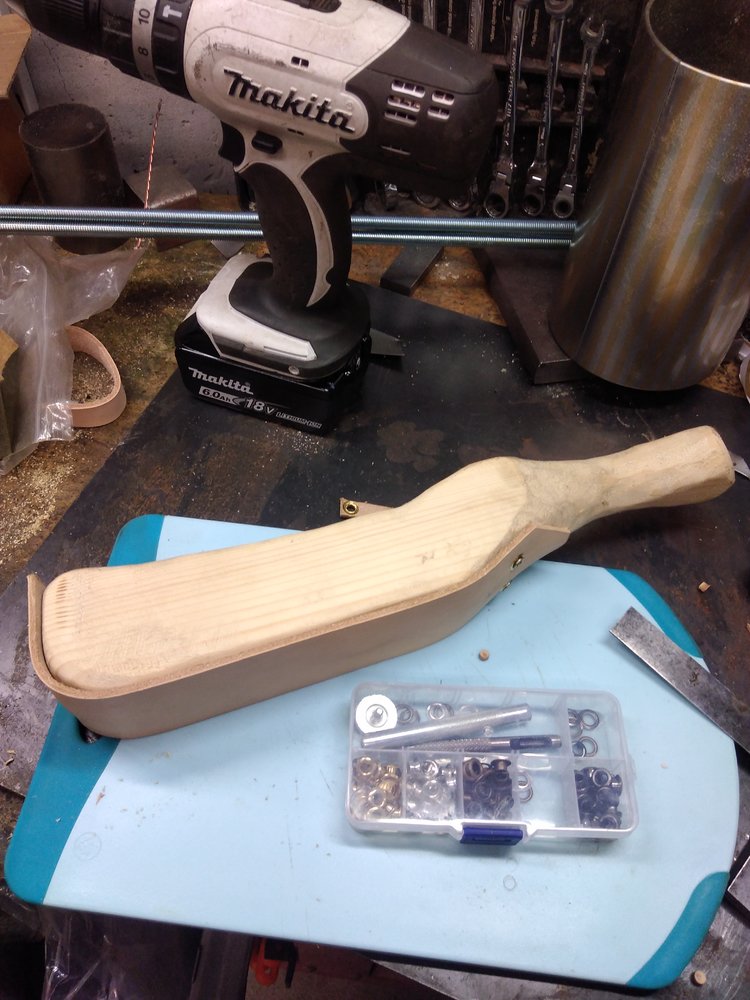

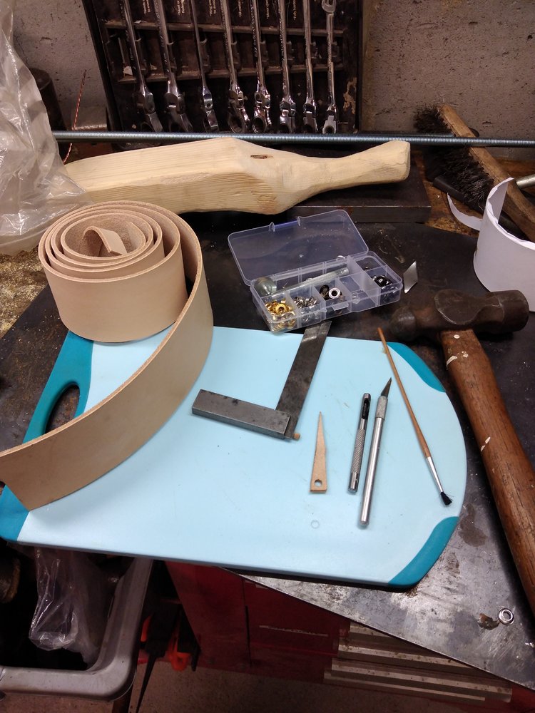

A strip of leather to cover the bottom. This was a little pricey but I have enough material to make a few more. I could end up using the leather on other projects instead. I wasn't sure what I to buy, so I bought the thick 4mm material. It turns out it is good strong stuff. The eye/grommet kits are cheap on Ebay and could come in handy for other projects too.
The leather end wasn't cut straight so a sliver was sliced off to even it up. This produced a practice piece to play with. The punch is sharp and works nicely.
Front. First go. I think there is a balance to be struck between making sure the grommet is knocked together sufficiently and overdoing it and leaving it all misshapen. Not quite there yet.
Back
Leather strip cut to length and "grommeted".
A fun little project.

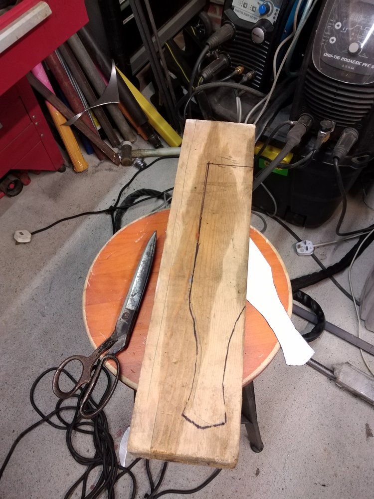

I don't have any hardwood, but I do have a big lump of softwood to have a try with.

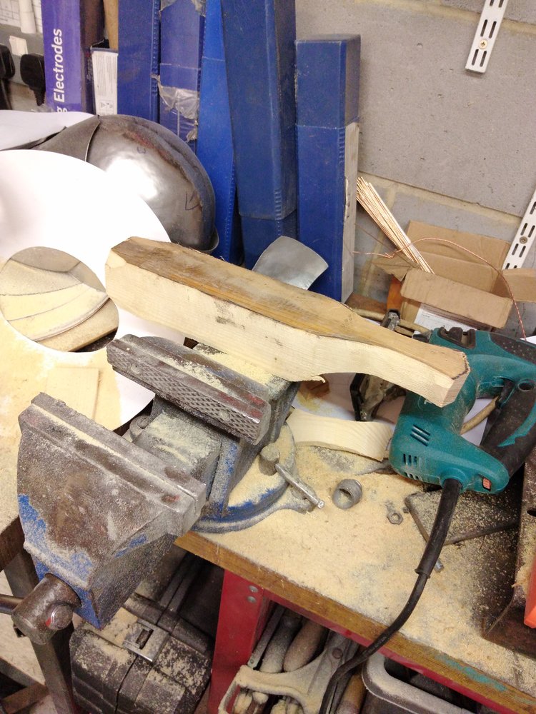

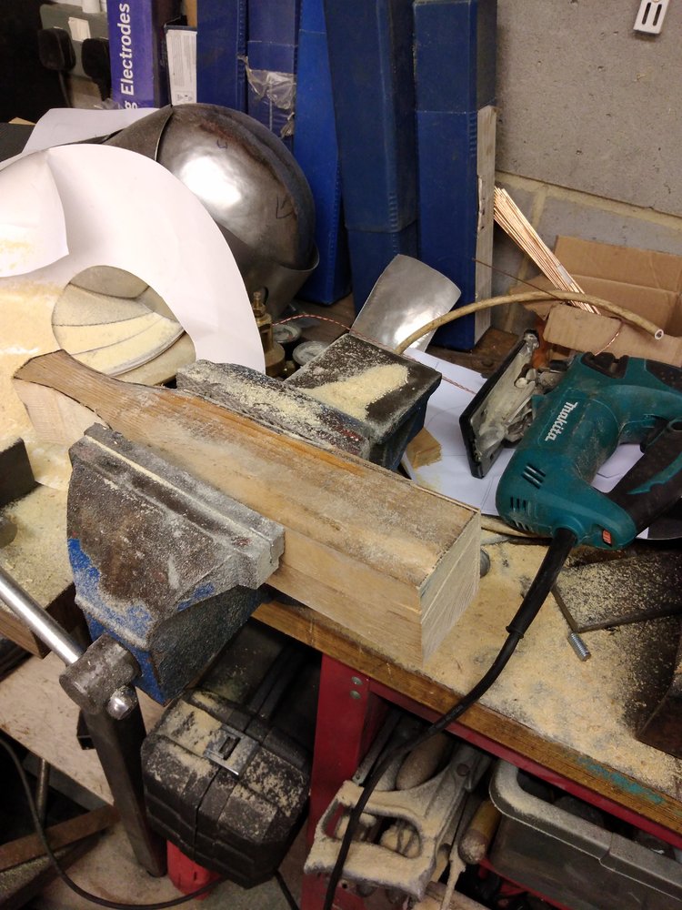

Roughed out using a jigsaw and handsaw. The wood blank is deeper than the jigsaw blade. I've made the tool a bit deeper to give it a bit more mass, the wood I'm using isn't particularly dense.

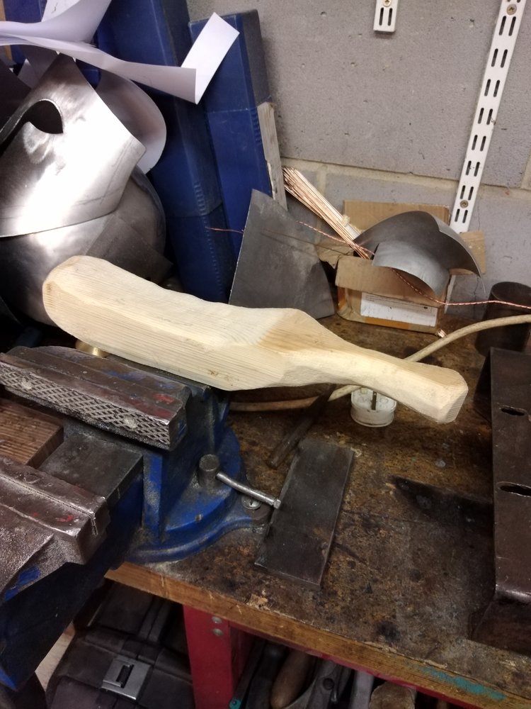

I've ground the shape in using a wood carving attachment on the angle grinder.

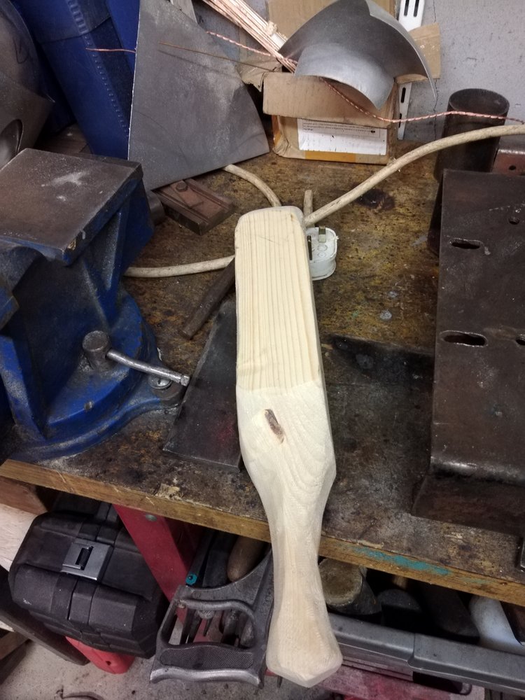

Electric plane used on the base to ensure it is flat. The handle isn't symmetrical but it fits in the hand nicely. Hands aren't individually symmetrical either. I've watched enough Forged in Fire videos to know not to make a handle too round.

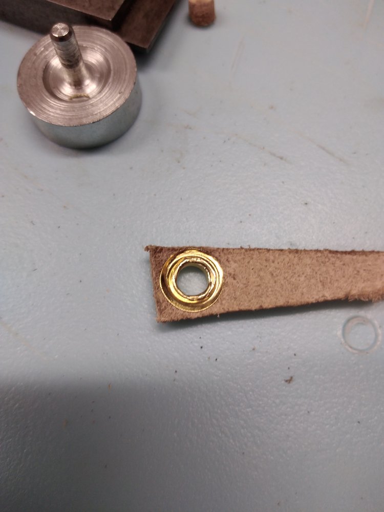

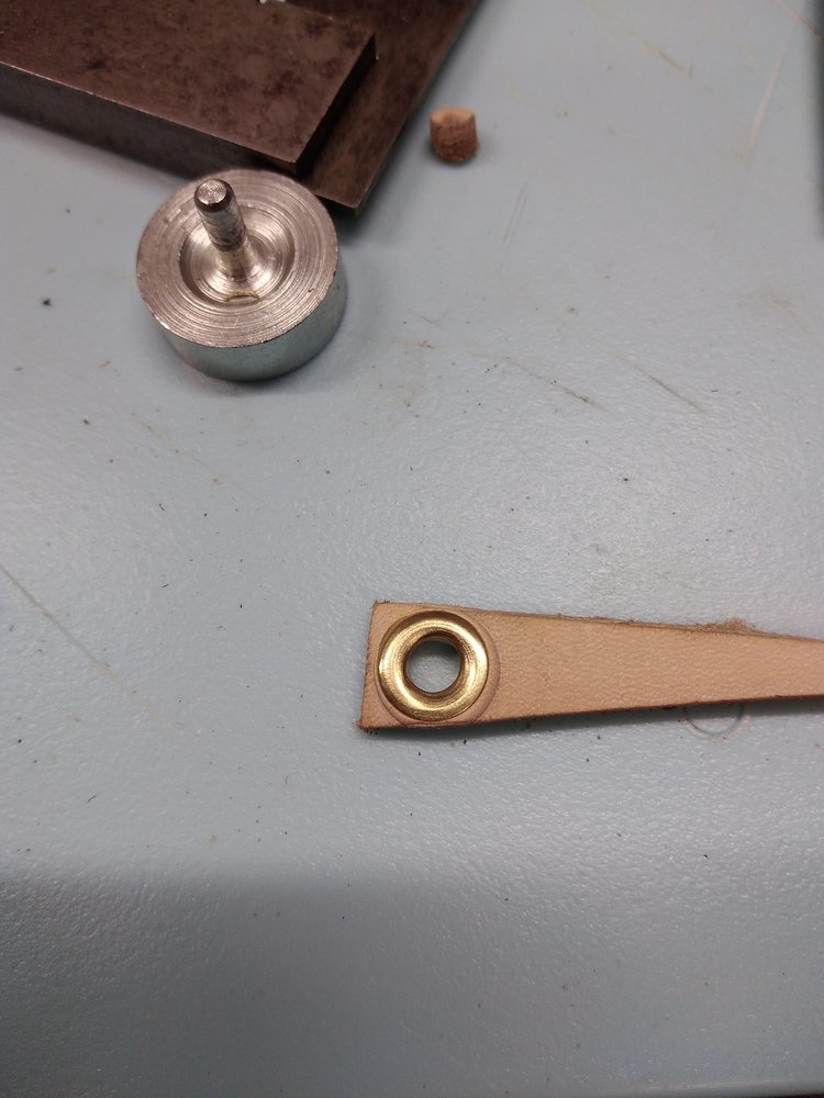

Back
