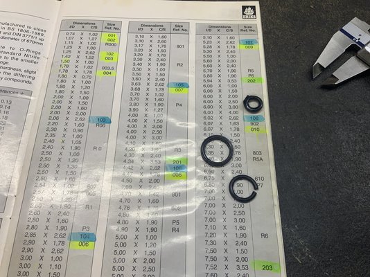

O rings are cheap as chips but most places understandably have minimum quantities for a size which can start to stack up if you are buying one size either way.
