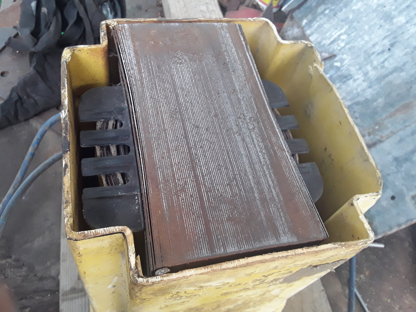

sardine Member Messages 3,750 Location Buckinghamshire Jun 24, 2022 #1 I have a working 110 v site transformer that the base had cracked and the sand leaked out, anyone know what exactly the sand does and can I either replace it with dry builders sand or just leave it out?

eLuSiVeMiTe Member Messages 16,282 Location ...... Jun 24, 2022 #2 Heat management I believe. Kiln dried would probably be best but do a little digging
brightspark Member Messages 41,693 Location yarm stockton on tees Jun 24, 2022 #3 repair the case with catty paste and refill with dry block paving sand. its just for extra cooling . some are filled with resin mixed with sand
