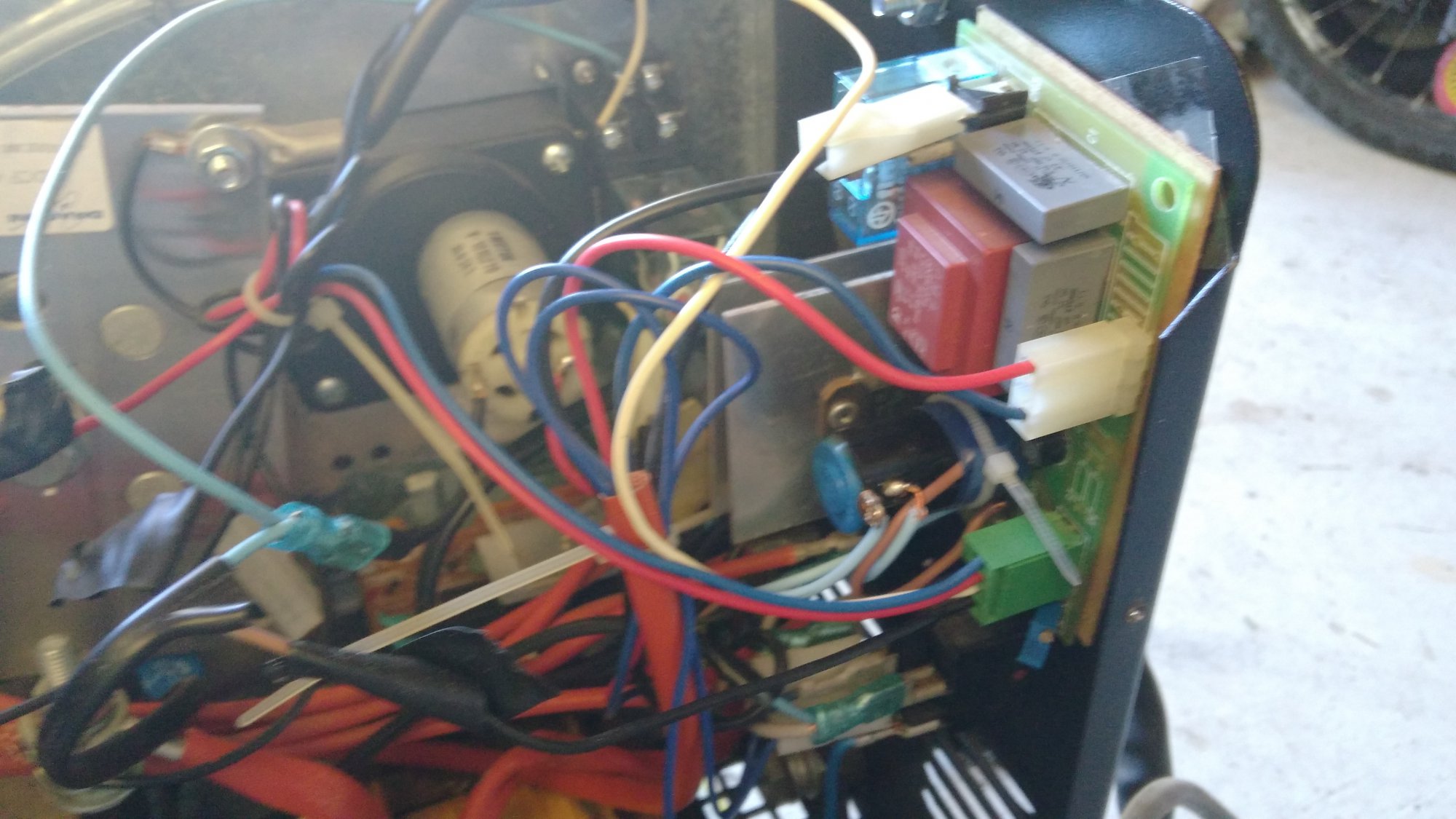

Hi i've got a SIP 150 gas/gasless and have done a few mods from this site which have made it better. Braced the rollers to stop flex, seperate PSU, 'brake' relay on the motor and multiturn trim pot. Wire feed speed is much more consistent but it seems to slowly rise in speed so just about to bypass the SIP PCB altogether with a seperate PWM wired to the multiturn trim pot....
