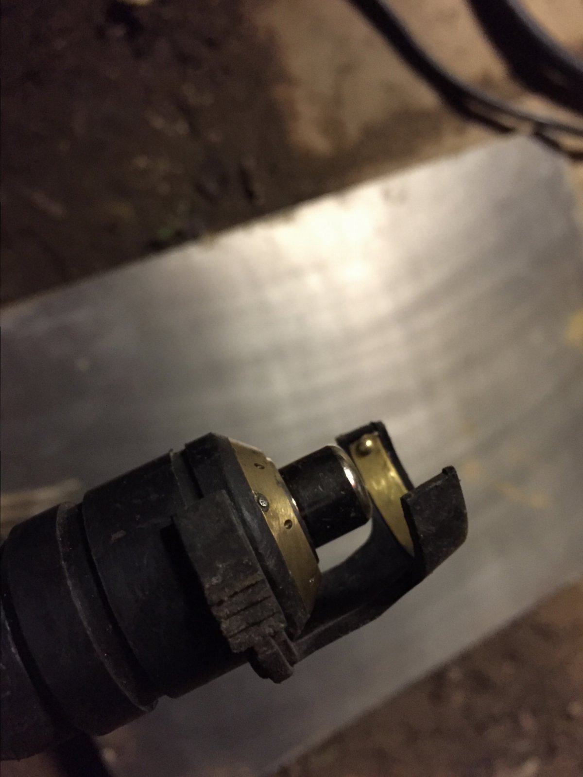

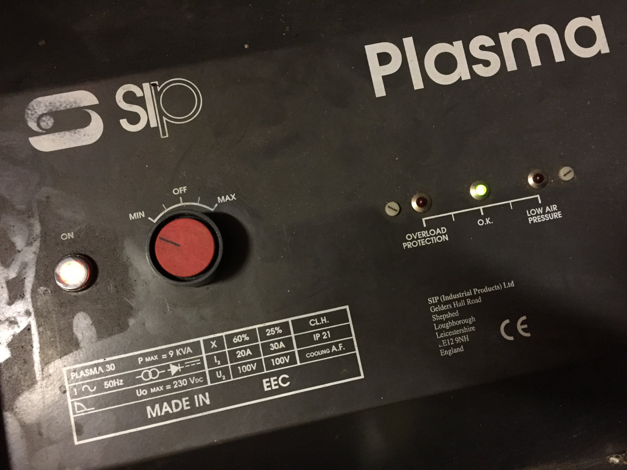

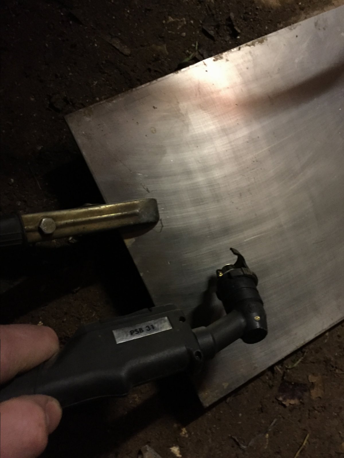

if you thing the switch in the torch head isnt working join the 2 wires together assemble the torch and give it a try
not the switch you squeeze with your fingers, there is a small micro switch in the head that breaks the circuit if the torch consumables arnt fitted properlySnooper yep I tied the switch first and confirmed it works ok with the multimeter
Without the attachment on the end ?Yep I tried contact with the steel plate and still no joy
