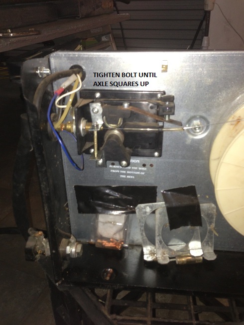

Hi all,
I've been registered on this forum for a while now, but have been lurking quietly in the background most of the time! Great site by the way - amazing how much I've managed to learn from here.
Unfortunately, I discovered this forum after I'd purchased a Cosmo welder - probably would have gone for a different machine if I'd have known about the bad reputation SIP / Cosmo have

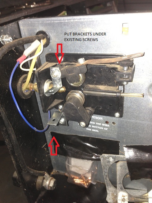

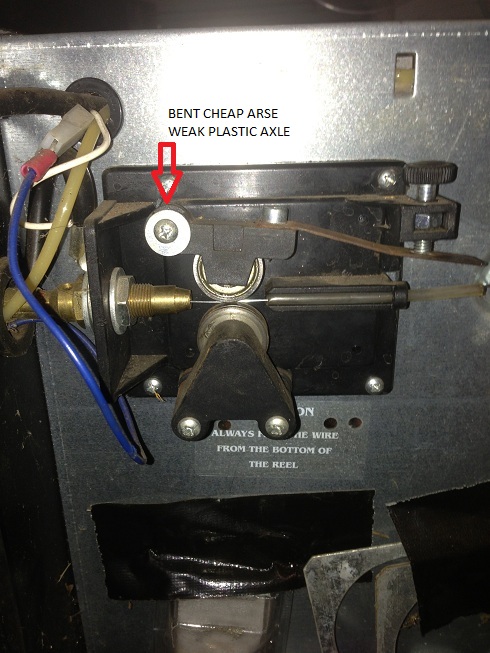

Anyway, I have run about half a dozen small reels through it over the last few months without any problems. Then within a couple of days of putting in a large reel, I started to experience problems with the wire feed.
The motor was turning, but the rollers were slipping and not feeding the wire through.

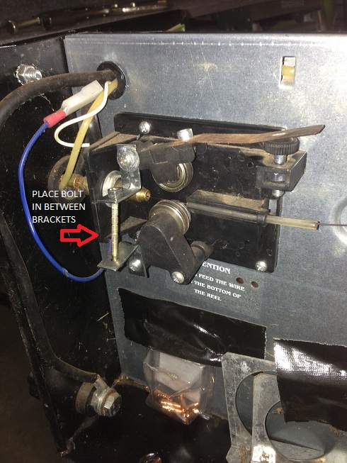

On closer inspection, I could see that the plastic pivot that carriers the idler roller was flexing. This resulted in the rollers being out of true, and losing the grip on the wire.

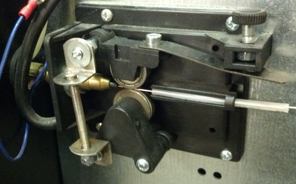

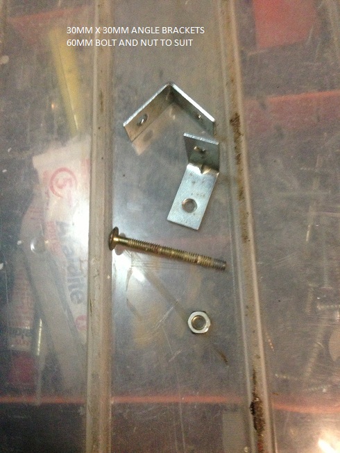

I came up with a simple solution that stops this from happening. So far, I've run another large reel through without any problems at all - wire feed is much more stable and no signs of slipping.
A couple of photos below to show the simple solution. Hopefully this will be of use to anyone who's suffering these sort of problems with their SIP / Cosmo machine. Probably worth trying before changing to a steel liner?

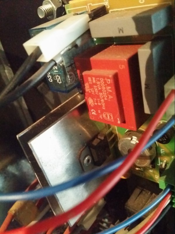

Welcome to the forumHi all sure your all bored of the old SIP questions on wirefeed mods so i'll make it quick, was gonna do a seperate PSU mod but the wire feed curcuit board on my migmate 150 looks to have a transformer built in, have SIP learnt a lesson here or do I still need to run the mod?
Has a metal liner and just done the feedwheel strap mod.
Cheers

Genius. I had an unused machine that had been sitting for 10 years, with the bit of plastic loaded up. Terrible feed problems, was ready to throw it out. I could see top roller pin was a weak point and contemplated trying to put in a proper wire feeder, but thought it was not worth the effort . I think your genius lies not so much in identifying the problem or solving it, but solving it so simply. Saw your solution, 5 minutes to make and works perfectly. I did one further "mod", when the top roller was out, i bent the plastic pin gently closer to vertical, and hit it for a second with the heat gun, it felt better that way, and made it slightly easier to assess the drill spacing of the metal do-hicky. Never do that cold, learnt many times the hard way. I had always doubted planned obsolescene but occams razor says that is what these guys were up to, they make a lot of welders, and blind freddy could see a 4 mm plastic pin bending over the years, somewhere outside the warranty period, i hope it was just a grad on the drawing board and the boss was away - but smells more conspiratorial ....... Welder is great little unit now. Ps. Also noted and considered flipping the wire spool in spite of the sign, but dismissed it, the spool or post seem to be tapered, and the other way round was pretty stiff. Also had noted the short distance to the tube, but thought lengthening it was too hard. Thanks again.

likewise my sip 105 is probably getting on for 20 yrs old and has the plastic roller mech IMHO its no worse than the Cebora/Strap on ones all be it with a weedy motor.
the brace makes a bit of a difference, mainly stopping the wire popping out sideways. The biggest upgrade being getting a proper steel liner in the umbilical and the swan neck. Then you can add the power mods to stabilise the feed voltage.
