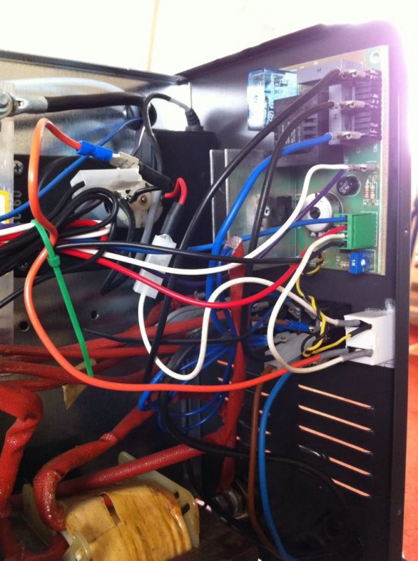

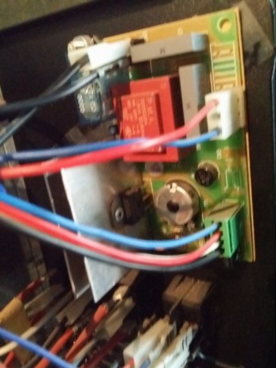

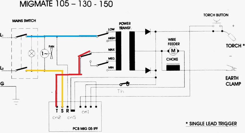

Hi, I realise this is a bit of a thread revival, but I am in the middle of doing this mod, adding a 24v 4amp transformer & rectifier , and have noticed that there's a massive surge on startup and that the relay on the PCB has a black spot on the inside of the case which I think suggests it's on the way out (and all that welding current goes through the PCB). So my first thought was to replace the relay and add a 230v contactor to take the main load of switching the transformer on. Then I thought, so now I have a teeny 12v supply switching the small relay, switching in turn a contactor and another relay to turn on the 24v for the feed supply. It then occurred to me - why not just convert the torch switching to 24v, and do away with the little 12 v transformer and relay - I just need a single beefy 24v coil relay, or maybe one for mains and one for feed. Can anyone see a problem in doing that?
