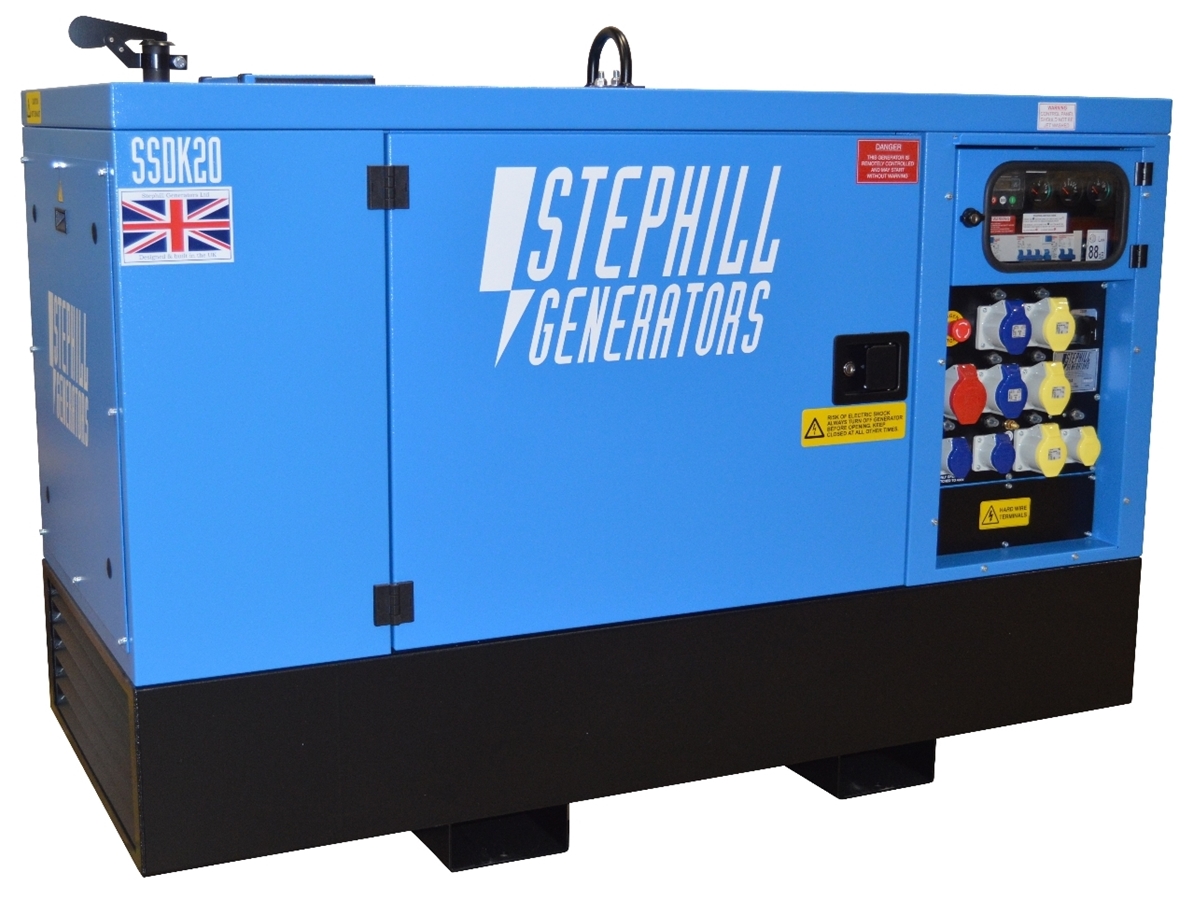

You could get a generator,
  might need to eat a lot of beans...OK...got ya.... thanks for the information needed help thoe...will sit and see what's next alternative.You only have a 60 amp total supply.
Blow that company fuse and it's a chargeable callout and a good bit of explaining to do.
You will never run that 355 anywhere near full whack without upgrading the actual supply to your house, not just to your workshop.
Rotary (or any type) of converter isn't going to do it - you don't have the supply. If you figure out a way to magic energy out of your **** to feed it let me know
You could get a generator, but the sheet for the 355 specify a minimum of a 17 ish kva genny - that's a towable job that is.
