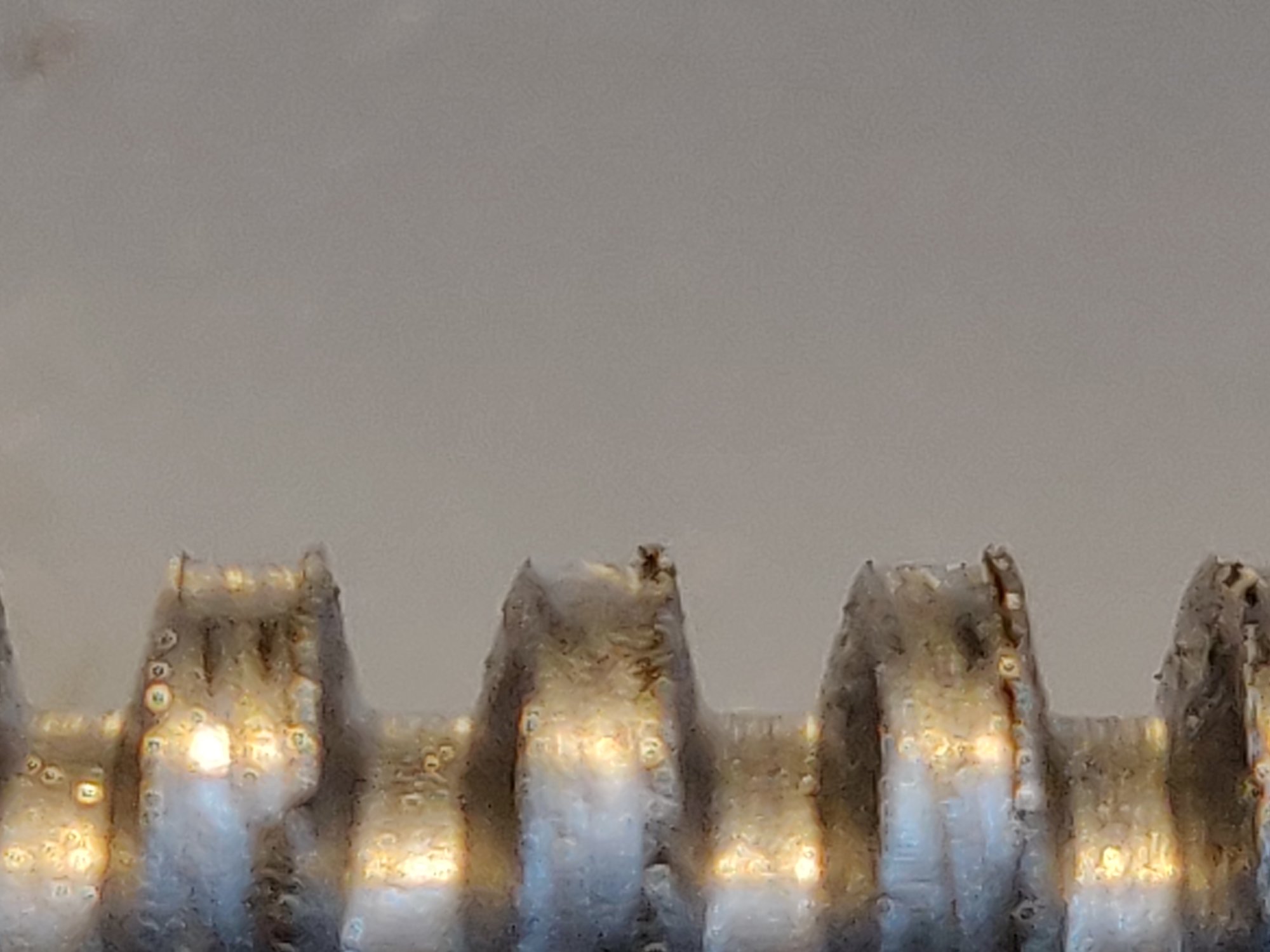

Compound, the thread angle remains constant just width changes. We are talking fine tuningHow do you deal with the change of thread profile?
We are talking a few thou adjustmentI disagree. The angle presented to the work piece reduces as the tip is rotated from the horizontal.
But then you seem to do it so must have a way of addressing this problem.

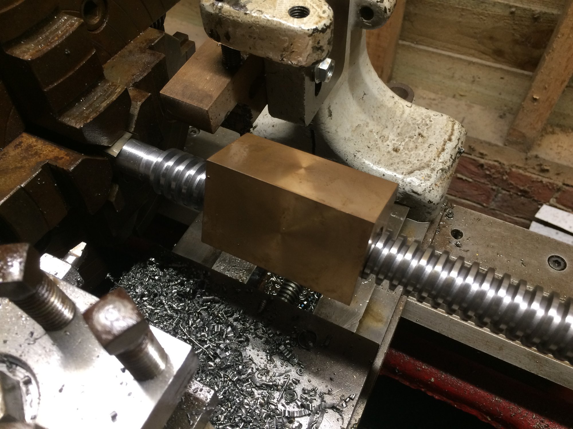

Here’s a picture of a lathe crossfeed screw I made . Note the tool bit is round so I can adjust to the helix and I just plunge cut using compound to give relief.
I only use carbide on nasty stuff. I discovered the shim problem internal threading heavy drilling tube. 8” bore the shim was fine but on 6” on the last 10thou it would pick up.
When that happens 3 in the morning on a break down job and the old brain is tired I nearly had a tantrum!View attachment 242829

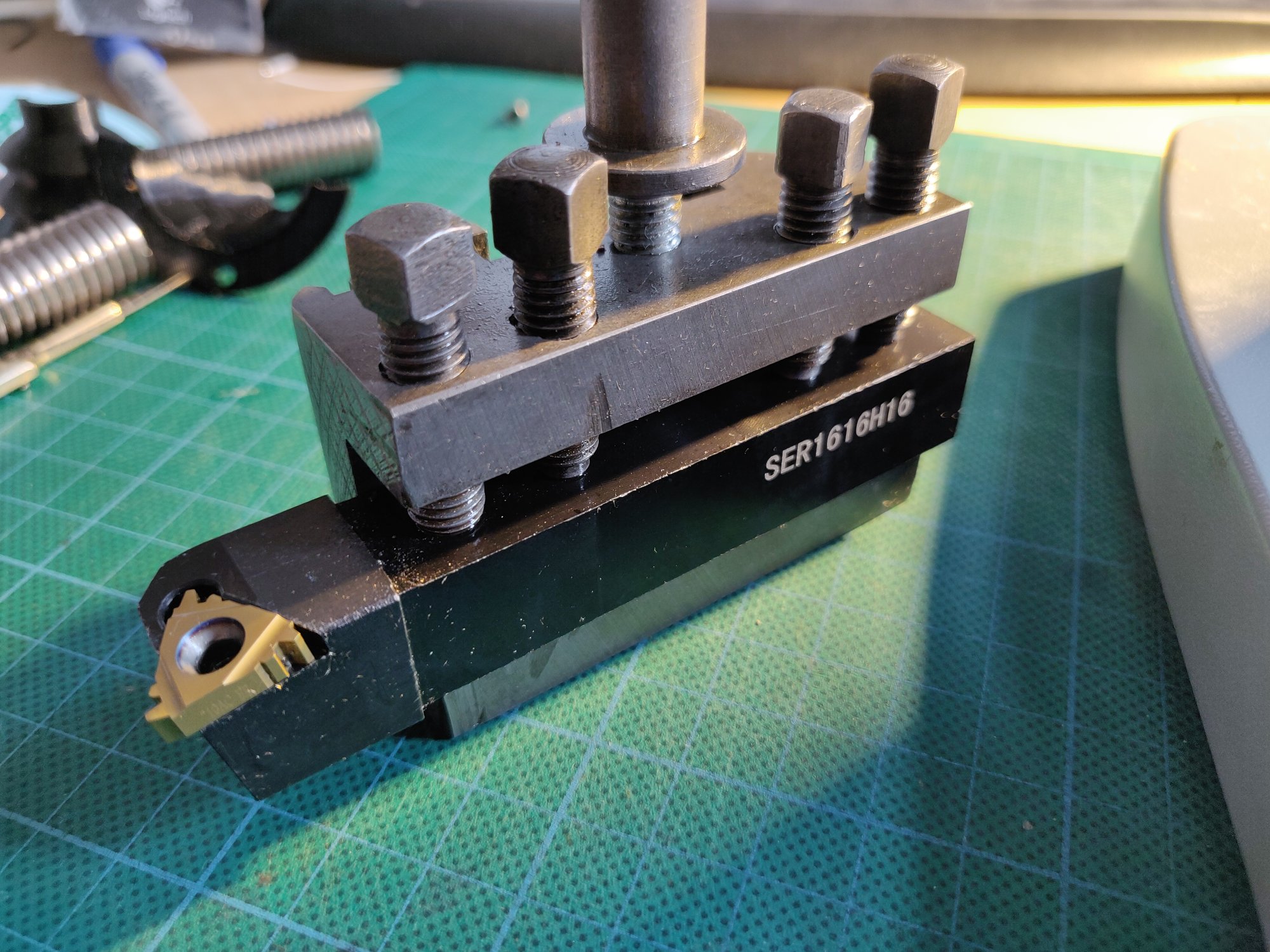

For your tool you’d have to make one.So I've determined I need a 3deg shim for 2.5mm pitch on 16mm diameter but any suggestions where these can be purchased?
I bought a Sau SEL 1616 toolholder, they list the shim as 16IR+3 but can't see anyone stocking them nor any 3deg from other manufacturers.if you had a tool from a major manufacturer then you’ll probably order a shim
Yes looks like that might be my best bet, I believe the toolholder came with a 1deg shim so something like 0.4mm packing should get me close to 3deg.I would just pack the base of the tool holder. Even a bit of welding rod under one edge might do it.
