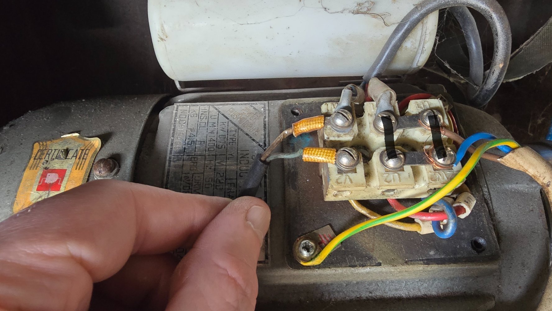

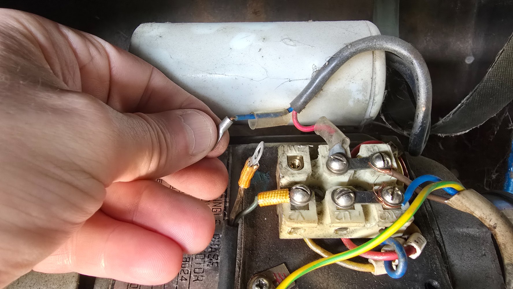

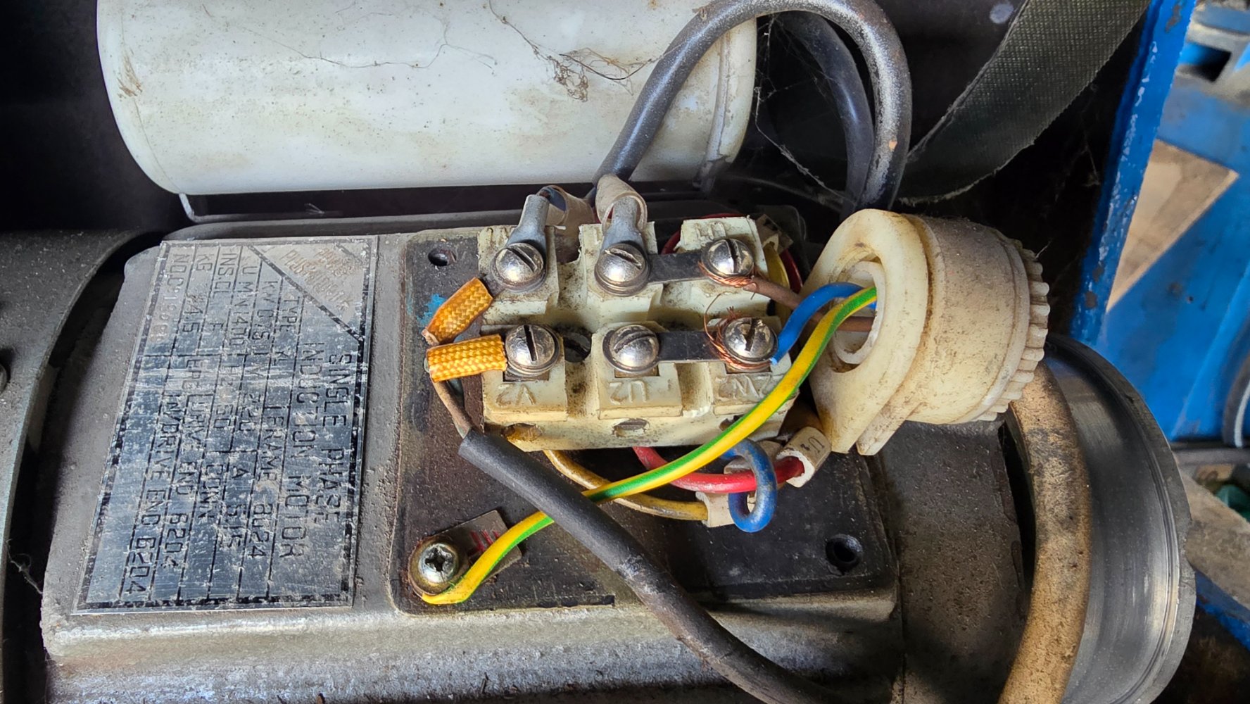

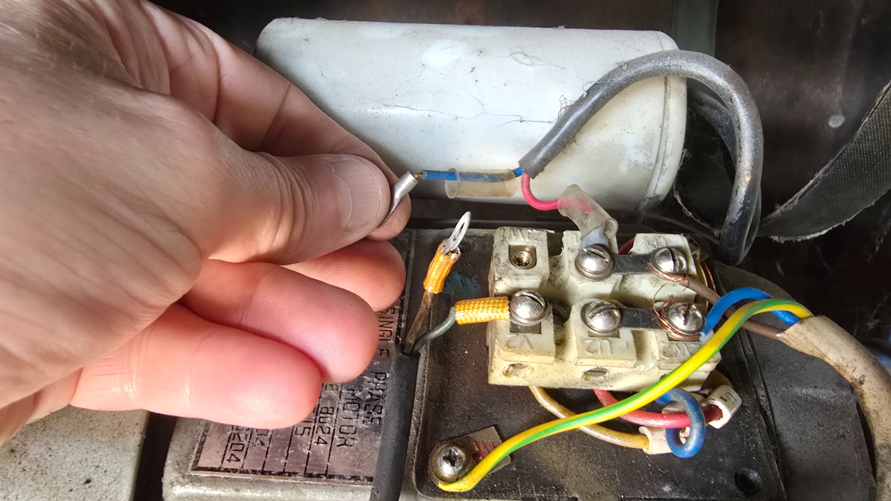

Already sorted those whiskers!First things first, get some crimps on the power cable terminations to get rid of those careless whiskers!
Is there a schematic on the underside of the cover you took off the terminal box?
Normally it's just a matter of swapping the run windings over so that the polarity is changed....assuming you know from that connector block where the run windings are
Alternatively just swap the start winding connectors over - that will work as well (but don't swap both start and run together!)
