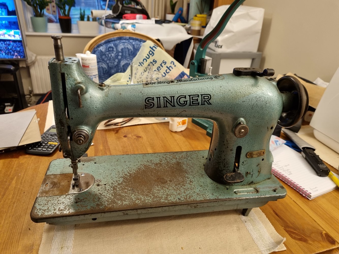

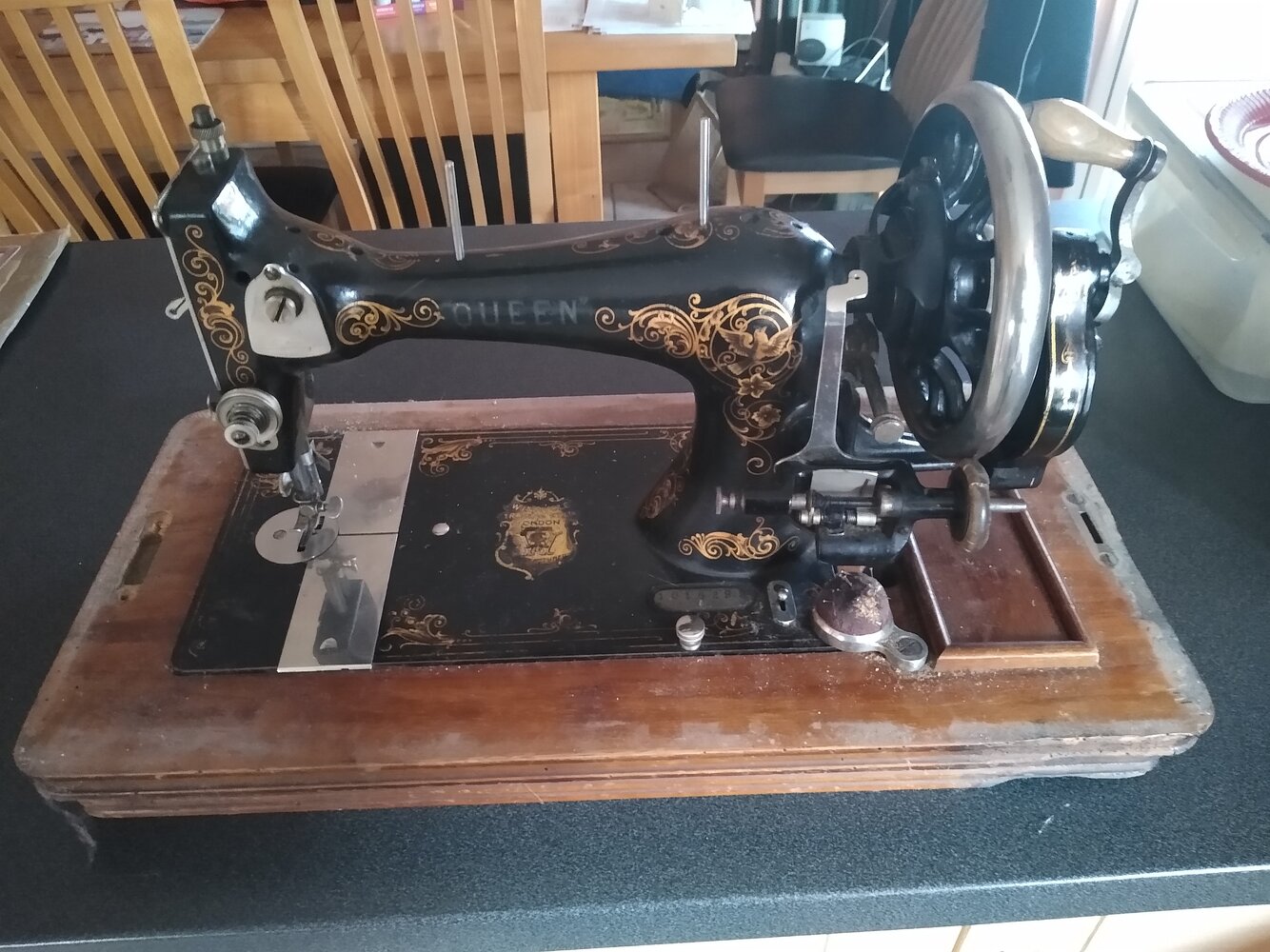

This isn't exactly a restoration thread as there's nothing really wrong with it (yet), I'm just dismantling it to clean out the dried up oil and fibres, thought I'd start a thread as I'll be taking pictures anyway, and I'm likely to need help/advice.
Here's the machine as I got it, it's a 96K41, made in 1935.

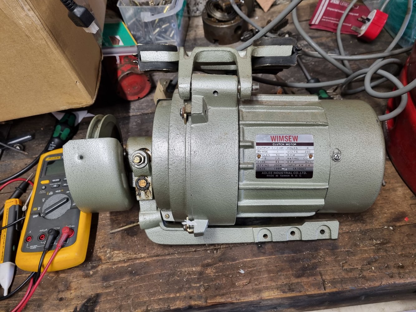

The motor isn't original but it's very nice, really smooth and quiet, pretty massive considering it's only 1/3Hp, but that's just more inertia to punch through thick material. I'd like to try my hand at leatherwork, mum's into sewing too and has been after an industrial machine for a while too, so hopefully that's permission to keep it indoors with all her stuff.

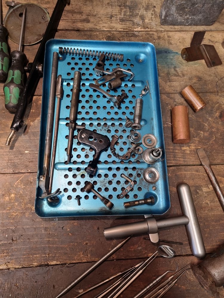

All these bits came out fairly easily:

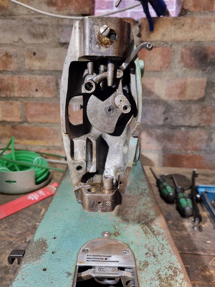

And I'm left with this crank/counterweight, there's a flat head screw in the side but I can't budge it. I'm not sure I actually want to take it out, if the shaft isn't keyed I'll have to time it to the feed dogs when I put it back together, and I have no idea how to do that.
I'm not sure how far to dismantle it, there's a lot going on inside it and it feels pretty smooth and free-turning, so maybe I'll just put the head back together and call it good. The table to mount it in will be a bit of a project, the bed of the machine needs to be flush with the table, the motor has to hang underneath it and needs a foot pedal for the brake/clutch, and it needs a knee-operated lever to lift the foot. I've got a shelf from a stainless catering trolley that might make a nice table surface but I'm not sure about the rest of the structure, maybe small box section, depends what it'll cost.
Do manuals for these old machines exist? I'd love an exploded diagram...
