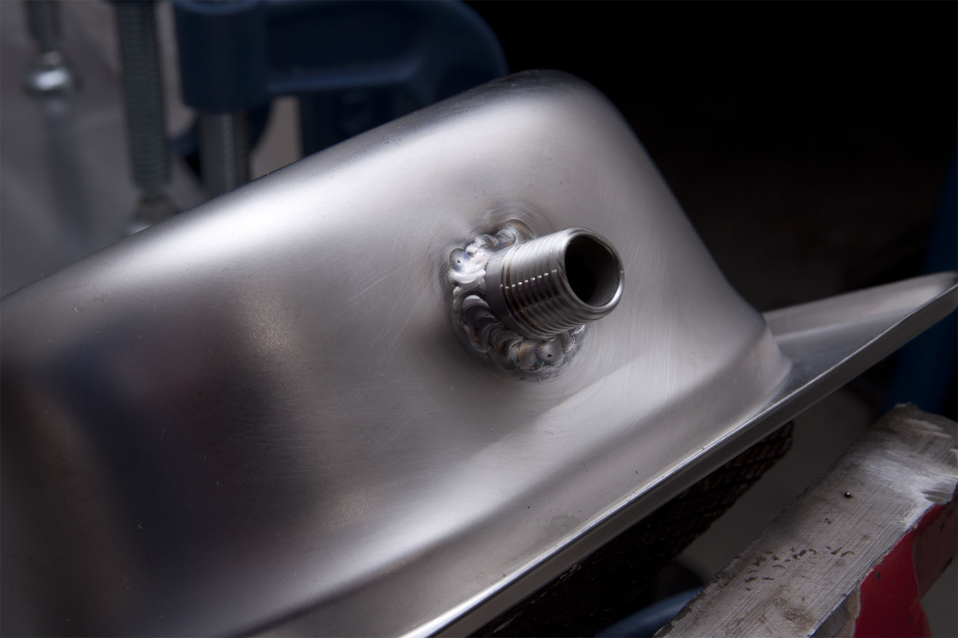

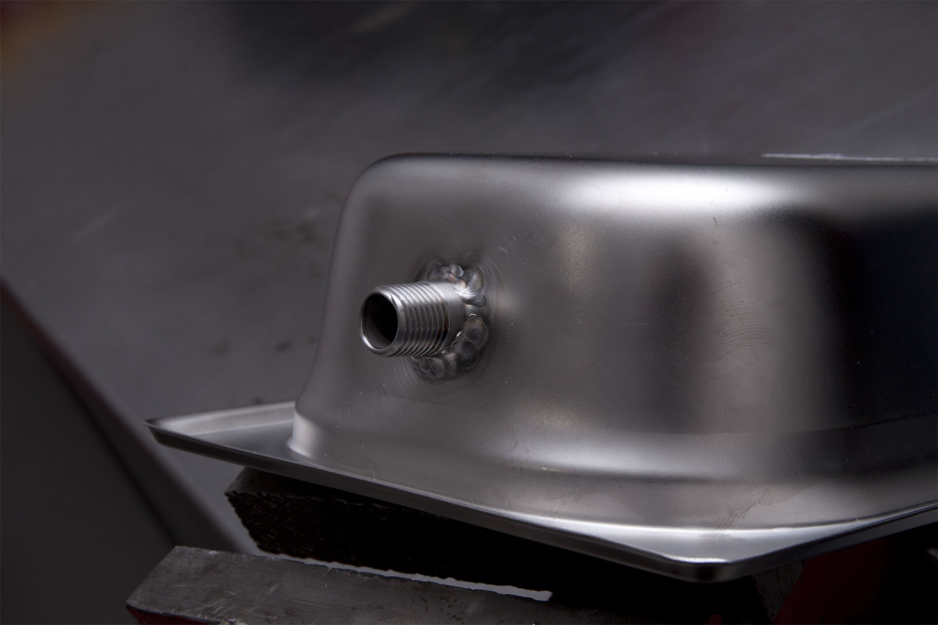

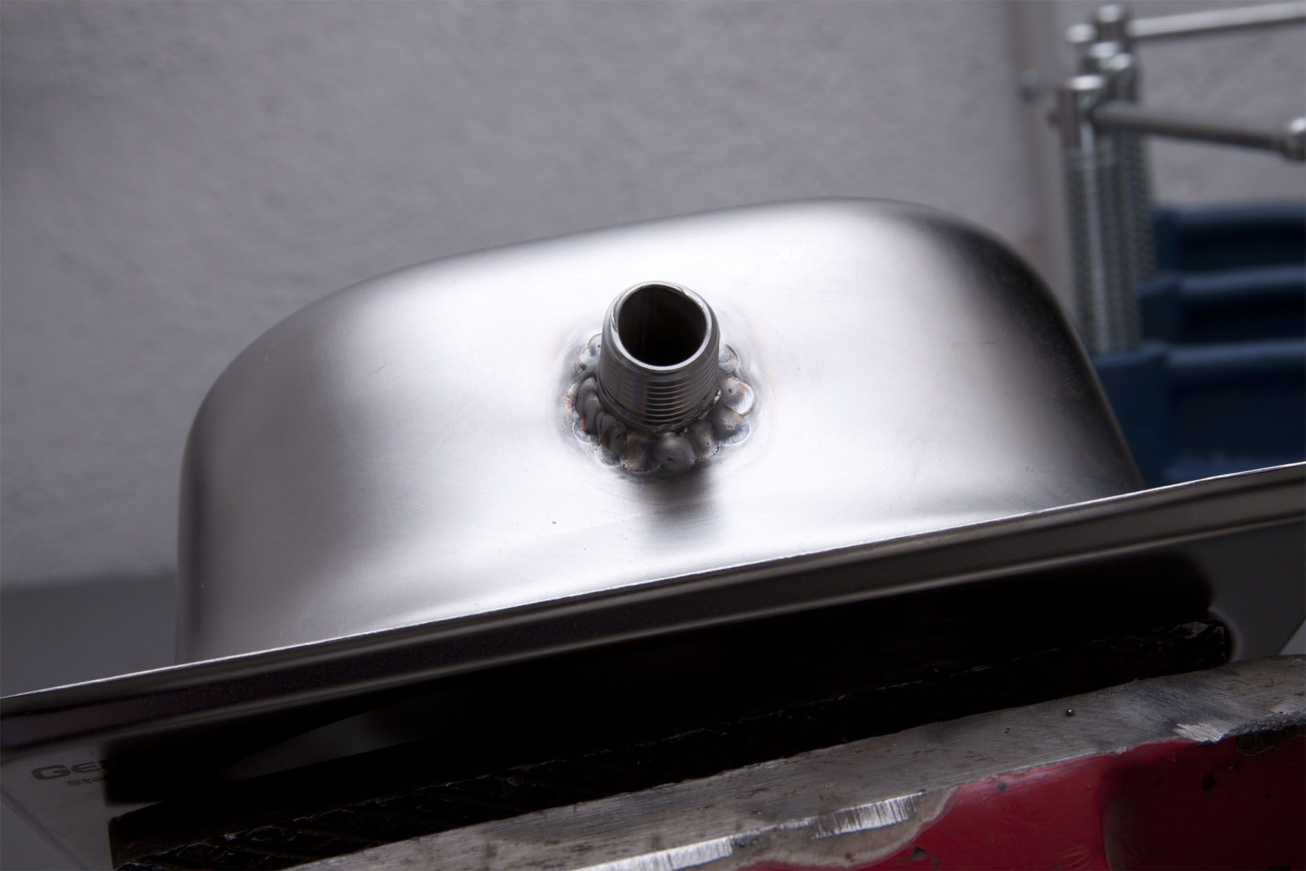

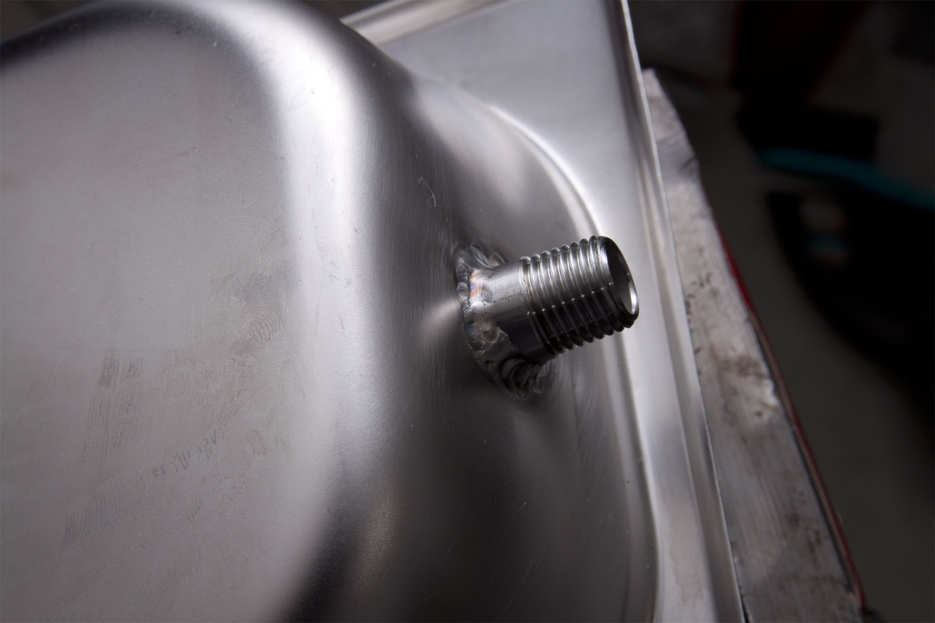

Melt the end of the filler rod into a ball keeping it inside the gas shield till it cools, put it in the hole and melt it into the weld.Would anyone have a different approach?
It's a silver solder job that.
I may try filling the hole tomorrow doubt i will be able to do it though.Everyone works differently how would people go about dealing with the hole to be filled?
1, clean up and re weld till its just the hole left.
2, ignore trying to fill the hole and run a bead of filler around the edge.
3, then work around in a circular until the hole is filled.
4, clean up then finish bead around fitting.

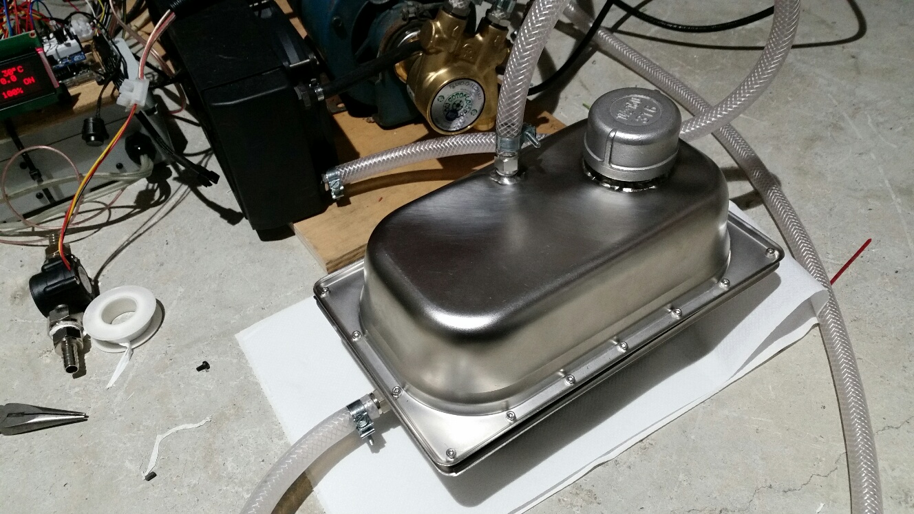

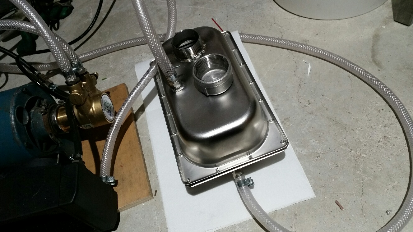

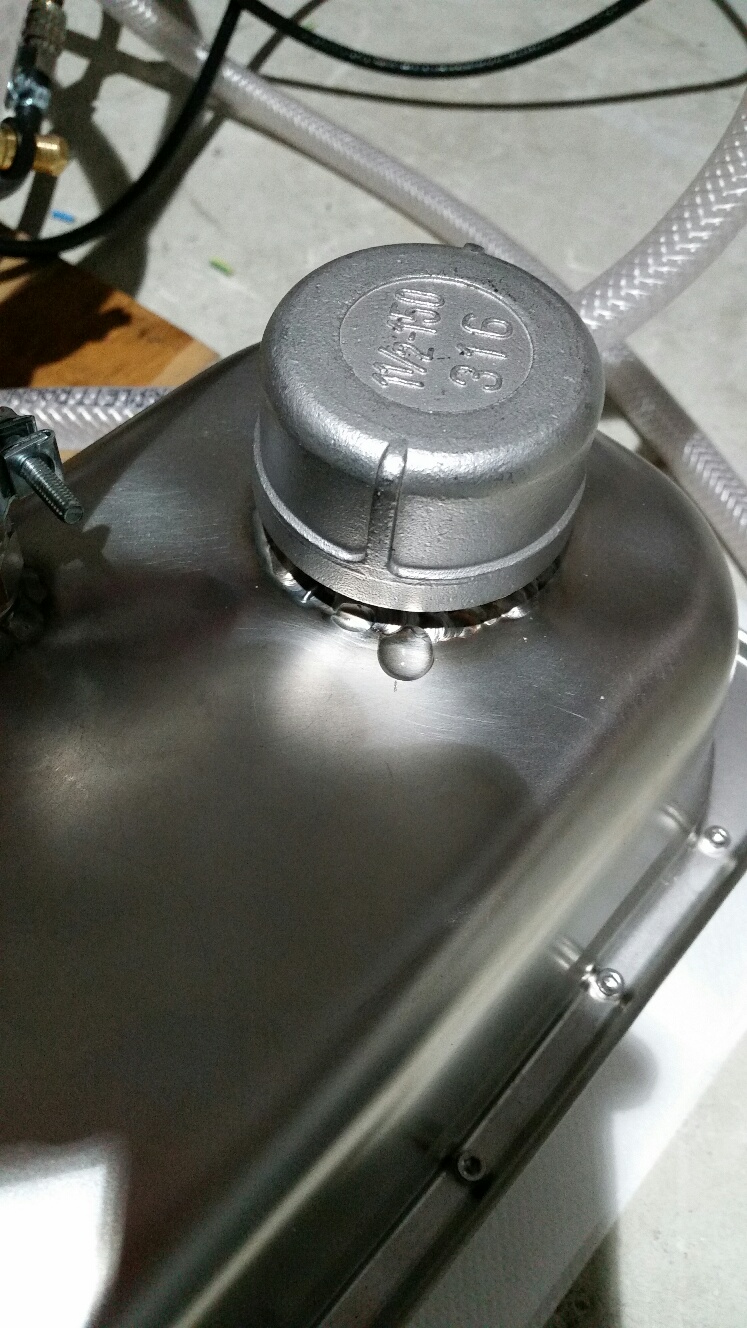

That looks great. I really like the fact you can unbolt it and give it a nice wipe out as part of maintainence. I would suggest you get some Pickle paste and pasivate properly the inside where you welded to avoid any risk of corrosion. While your on although not so critical you could do the weld faces too.Tank is done.
So far no leaks. Holds just over 3 litres.
Now i need to decide what goes where.
Thanks again for all your help guys.
View attachment 99979 View attachment 99980

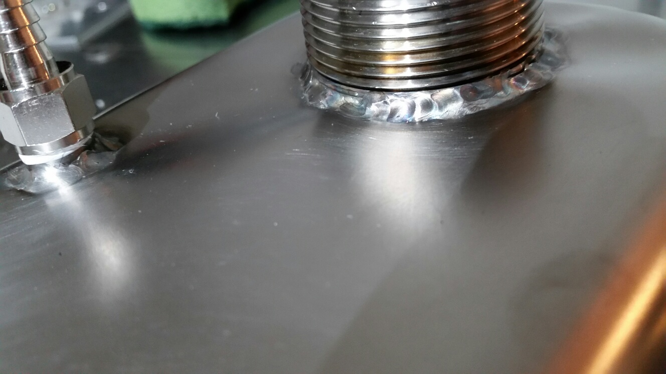

How is it leaking from the filler neck? Surely you ain't filling it that high.Spoke too soon. There is a leak from the filler neck.
Can i zip around this without taking the tank apart?
Thanks Rich it does not look too bad. Will get some Pickle paste.That looks great. I really like the fact you can unbolt it and give it a nice wipe out as part of maintainence. I would suggest you get some Pickle paste and pasivate properly the inside where you welded to avoid any risk of corrosion. While your on although not so critical you could do the weld faces too.
Nice job that Daz. Very well done.
The water level is 1cm below the top of the tank must be pressure in the tank?How is it leaking from the filler neck? Surely you ain't filling it that high.
In all honesty if it was mine all those joints would be water tightlike the dozens I've made. That said the one joint that actually doesn't need to be water tight has got a leak.Thanks Rich it does not look too bad. Will get some Pickle paste.
If my welding improves i will try and make a better one.. one day.Would it not have been easier to fabricate a tank out of some 1.5mm? That gasket joint between the two halves of the tank looks a bit like trouble waiting to happen.

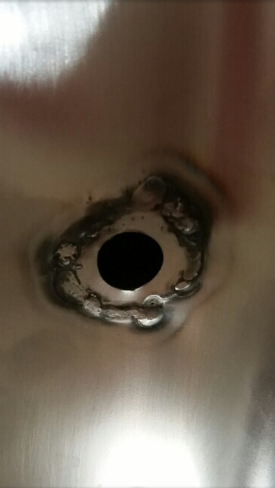

I knew this would be the case if those joints were not treated properly to remove the heat tint and any possible signs if coking.After a quick gasket change the tank is now holding up well. No leaks. But the back of the welds had already started to rust. Tried a few places today to get some pickling paste they had no idea what i was talking about. I doubt they would post this internationally.
I did give them a bit of a tidy upI knew this would be the case if those joints were not treated properly to remove the heat tint and any possible signs if coking.
I'd suggest you clean them up. Remove all signs of oxides and heat tint and coking etc. Get it all off and give it a nice going over with scotch brute until it's all bright stainless on both sides. Pickling paste would be ideal but you might get away with it by removal of surface oxides only.
