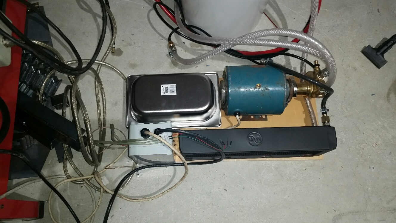

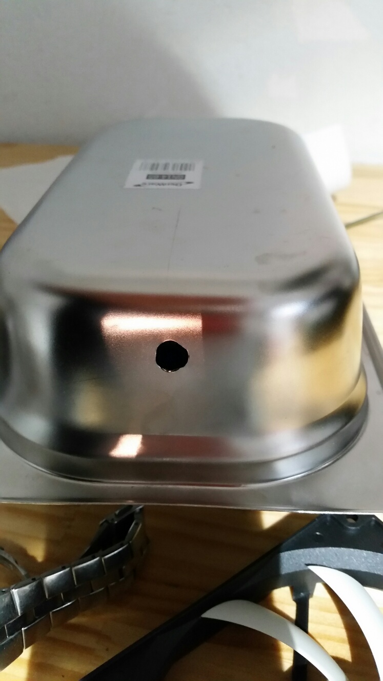

is this how the tank is sitting.Although i'm away i cant stop thinking about finishing the cooler.
Whats the best way to secure the tank?
Should work ok as long as you have near the edge, too far inboard and possibly the weight of the water would buckle the tank.
It does look bigger to me too.Ah ok, looks bigger, should be fine then![]()

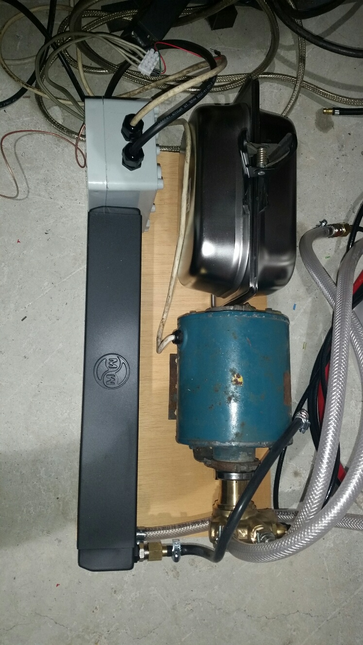

It's always best with that 1/4 hp motor to have a powerful fan actually dedicated to cooling it from its **** end if your going to box it in. Keep the pump head on the outside and plent of vents for the cool air to be drawn in and push hot air out.I bought the brackets i linked to earlier. Plus a couple more pans (spares or for the mk2).
How about having the 3 fans pulling air in through the rad then onto the motor? Then another fan on the other side of the case pushing out?
