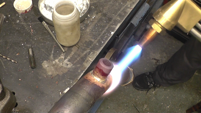

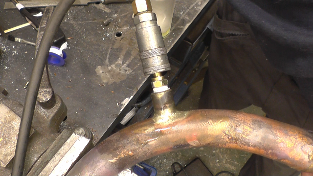

Some serious heat
1 3/4 inch copper pipe 1/4 inch wall thickness
Same hereNice jobI've always wanted to have a go at silver soldering but never had the chance. I use my cutting torch for heating stuff more than for cutting.
whats wrong with brazing rods brass can still be plated over unless you didn't want to put the heat inI made a copper window frame for a vintage bus
It had to be silver soldered because of the plating afterwards.
Thing nearly bankrupted me in silver solder costs!
brazing is sweated together same as silver solder just a slightlyKeeping to original sweated together design made of multiple pressing s
higher melting pointYeah sometimes something you dont want to get melty melts when brazing (guess who that happened to last night ) 5 hrs work rendered scrap with just a tad too much heat inputbrazing is sweated together same as silver solder just a slightlyhigher melting point
Yes and something I wasn’t prepared to do with 16swg bit too similar melting tempsbrazing is sweated together same as silver solder just a slightlyhigher melting point
and not being scared to get it hot!I learned to silver solder and braze before learning to gas weld practice makes perfect
