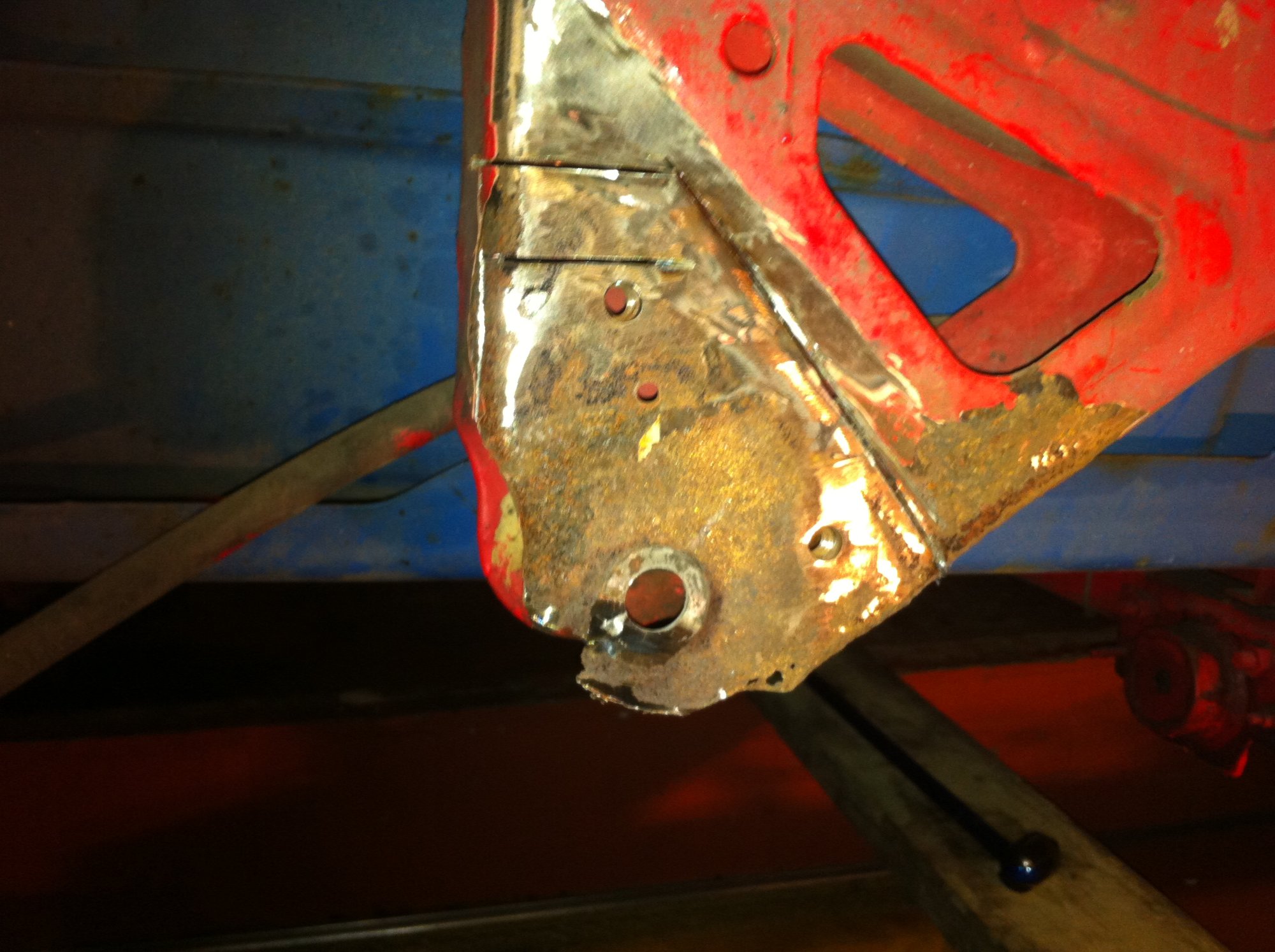

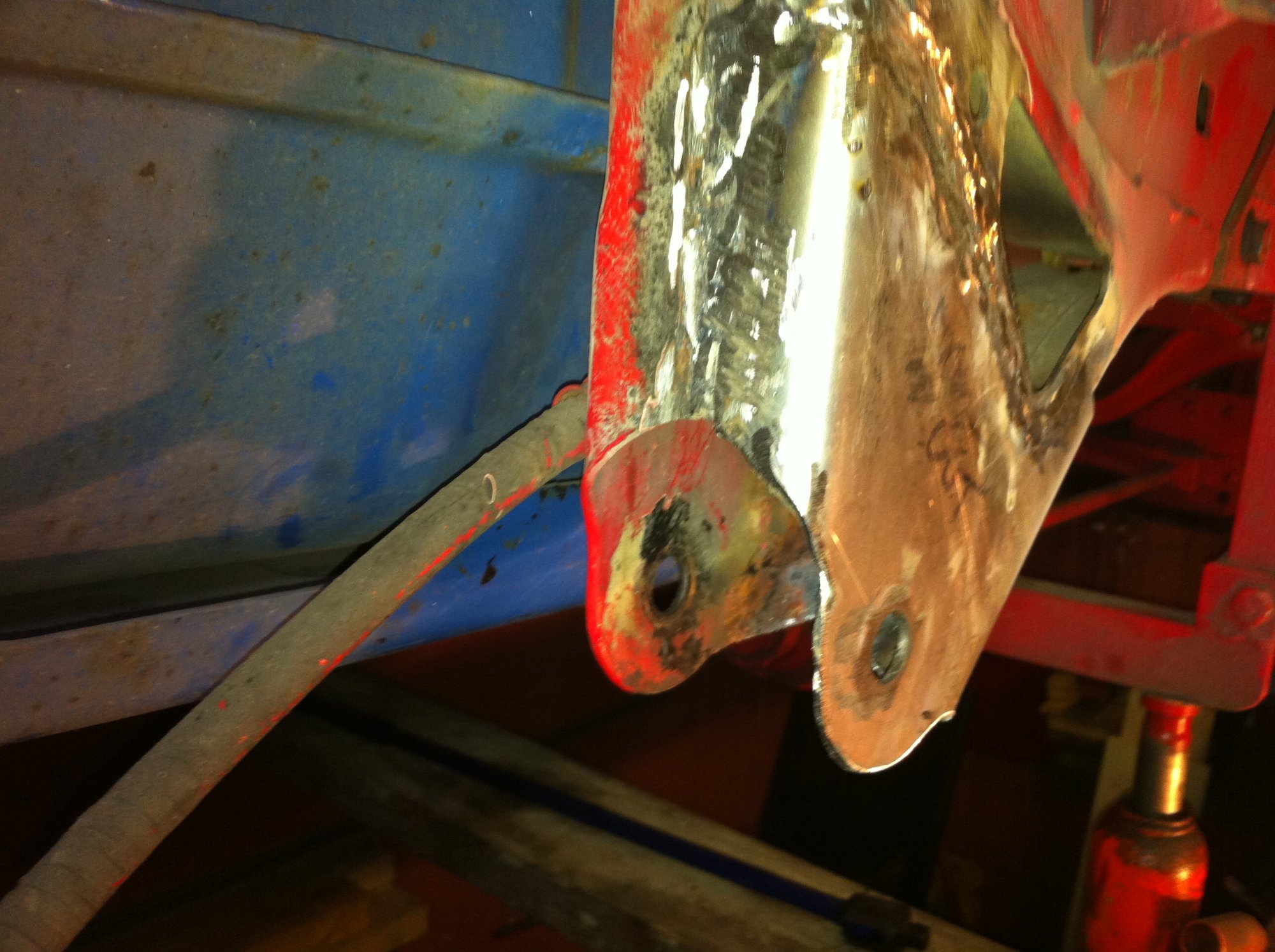

Hope this qualifies as a "project" The old Truck failed it's MOT for the first time in 14 years, (on rust), not a lot but the rear sills are dam awkward to get at, I did the rear control arm bracket with my acient SIP stick welder as it was 3mm metal, not pretty at all but it did it ok, lots of weld then grind then weld again etc,

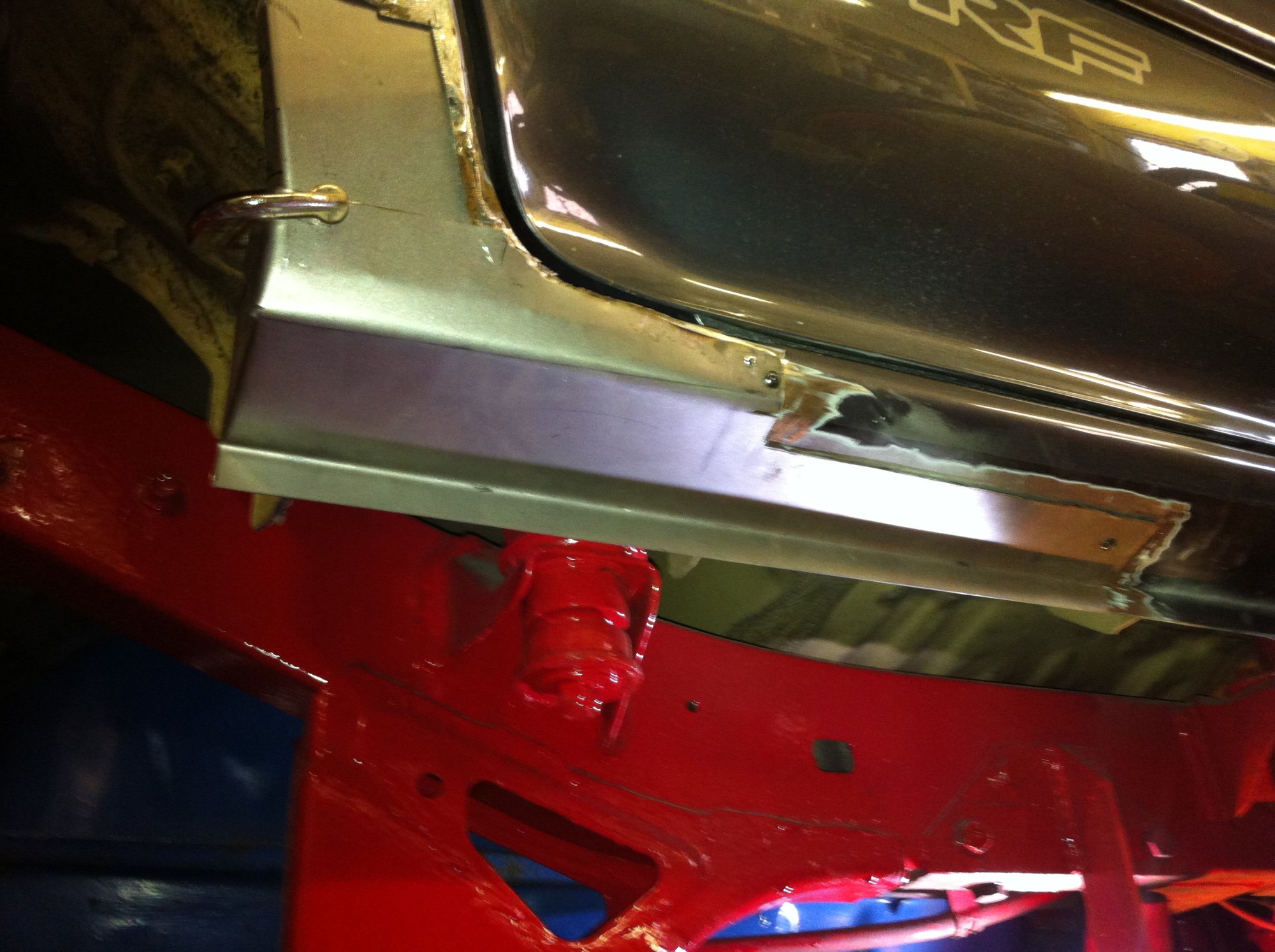

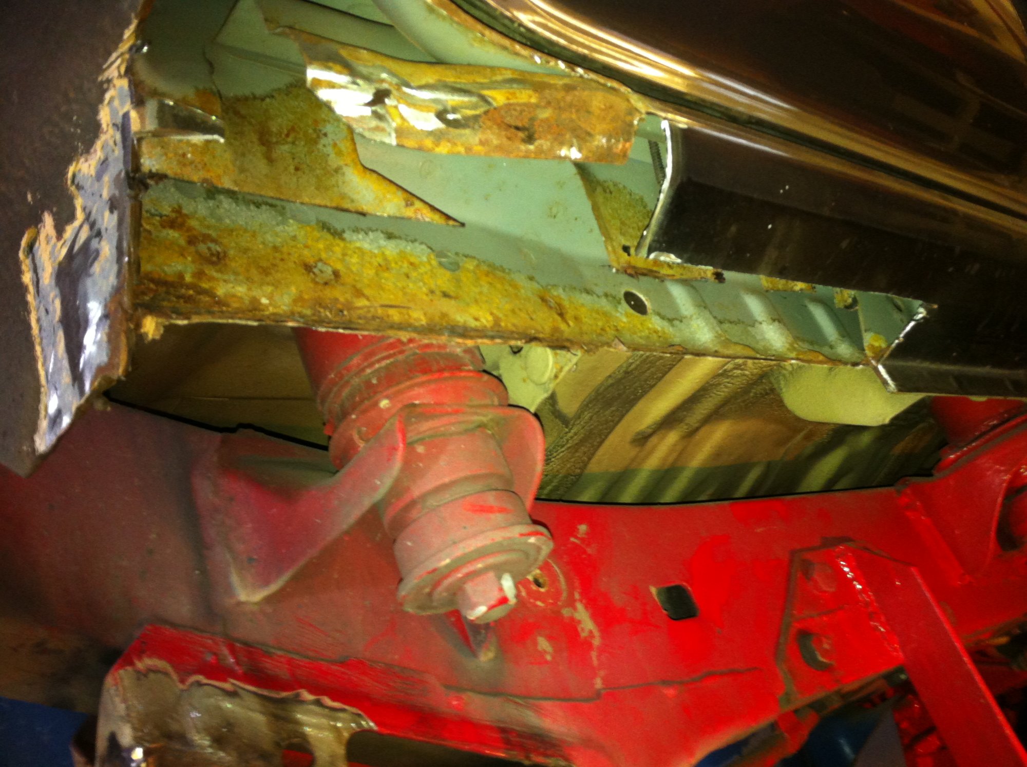

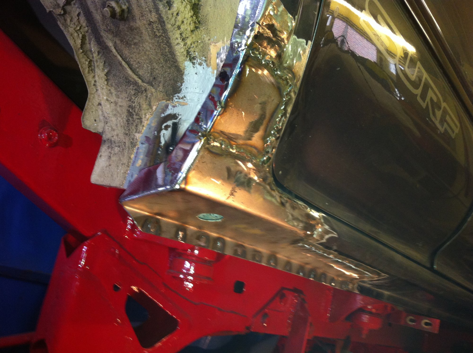

Sills are a different matter, got most of the rot cut out the off/side sill and mocked up new metal ready for MIG welding, At first I was going to get a mobile welder to do it but after some thought, I had an idea that they would probably charge several hundred quid to do it and the money would be better spent on a decent MIG welder and I could then do it myself and have the welder to use for possible other projects,
I ended up buying a Parweld 181c and 20lt Argon mix gas, now that ready to go I can start fabbing up the metal,
