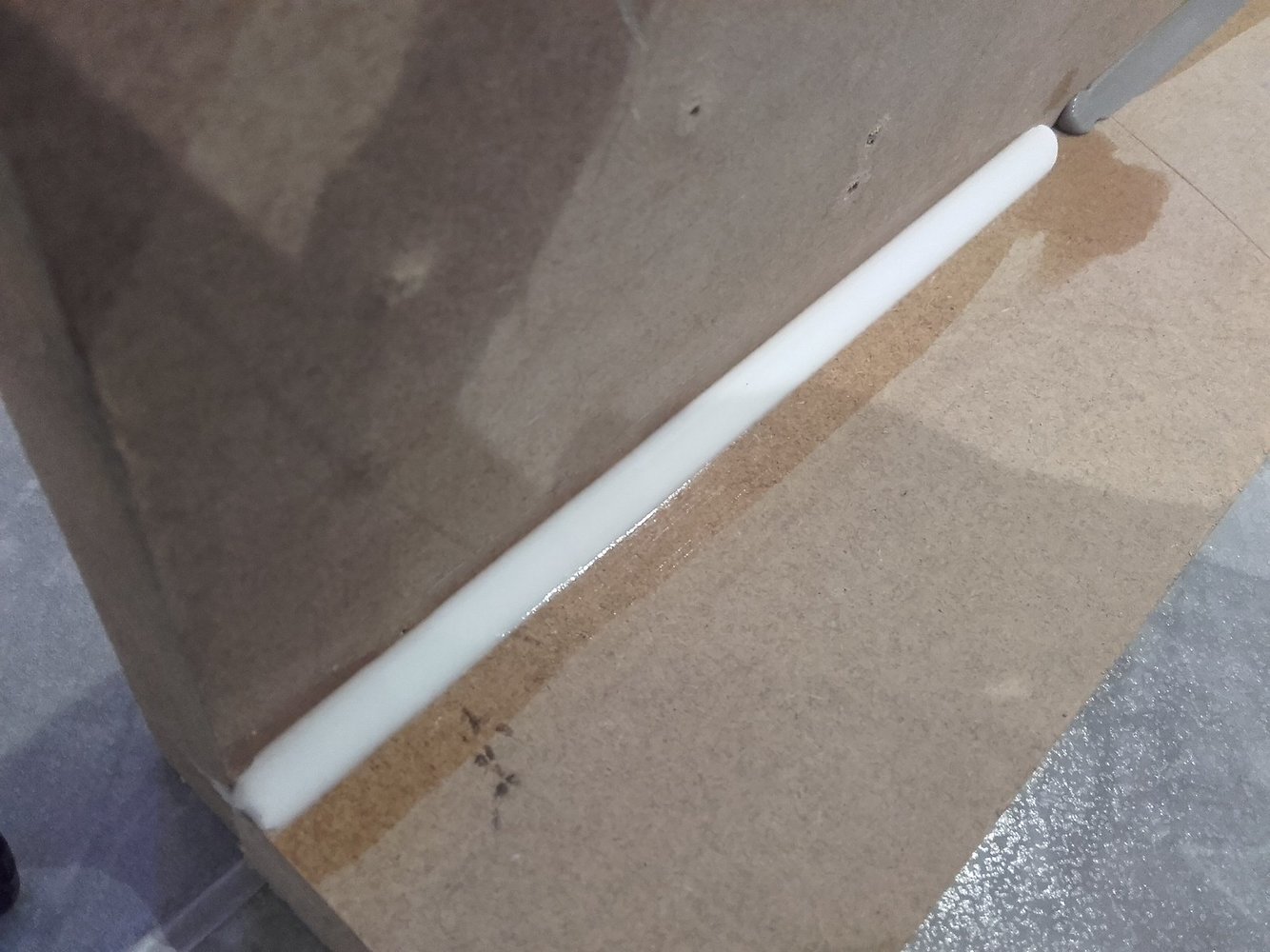

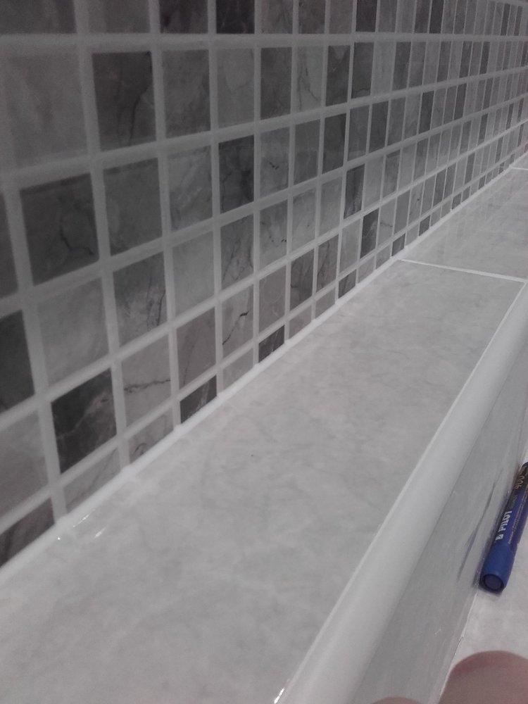

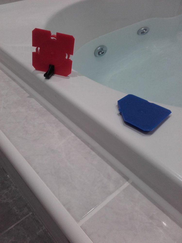

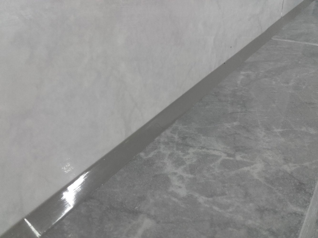

The Fugi Cramer kit was recommended to me and was an absolute revelation.
Up until then I'd been piddling about with soapy water and tape. Absolutely pointless.
Fugi kit every time now.
As for "mess", fold back a black sack so it makes a bin. Tear up lots and lots of two sheet loo roll pieces and have them ready. Fugi tool the applied silicone and wipe the excess off on the bit of bog roll. Pop it straight in the bin.
