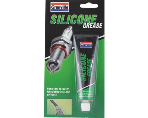

Wonderful stuff it is!
I dip wire ends in it before I put crimps on, I dip crimps in it before I push them together, I even dip stripped wire ends in it before I put bootlace ferrules on. I smear inside limit switches over the screw terminals. I dip coax in it before I screw F plugs on etc. Stuff lasts indefinitely outside/in harsh environments on the car etc.
But I've run out...

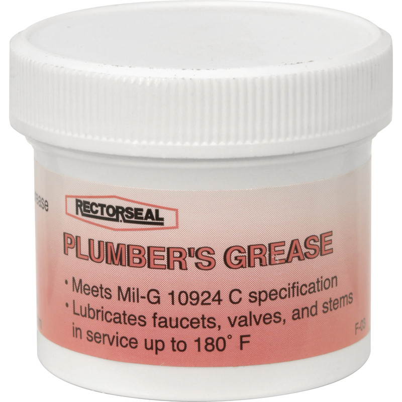

Need some at home over the weekend. Would plumbers grease do the same job?
