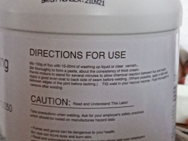

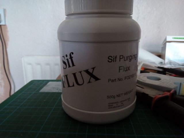

I plan on making a stainless exhaust for my car and bought some of this as I thought it may be easier to use rather than trying to purge some parts with argon
and here are the instructions
so before I use it I have a couple of questions, if anyone has used it before.
when its been mixed can it be stored in a container for an extended period of time, as I've got some silver solder flux I mixed 20 years ago and thats still fine.
What happens if you dont remove the flux residue, will it weaken the welded joint or surrounding metal.
