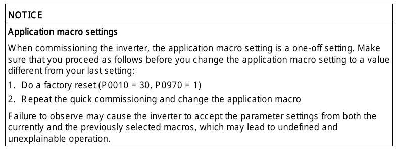

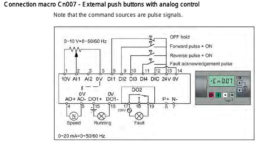

Yes, both the pot and the switch are good. I've had the motor running using them on a different (cheap Chinese) vfd. The Siemens VFD doesn't want to do anything at all, despite everything I have tried.
I've programmed it in accordance with the manual, with info on the Siemens site, with instructions on YouTube. Multiple times, to absolutely no avail.
