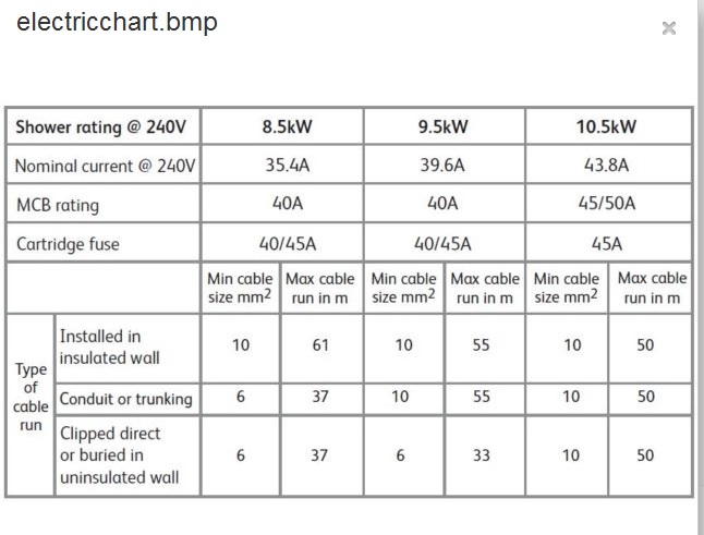

my old shower gave up, didn't do bad considering it gets used 3/4 times a day for the last 2 years.
i accidently brought a different model to the one i had, mine didnt have the model tag on it so wasnt sure,
turns out i brought a 8.5se instead of the 9.5se i had in, all the plumbing and connections are the same and its completely identical, other then the power.
ive attached a chart showing the cable differences between the two,
will the 8.5se need the electrical side of things changed?
ill return it and get a 9.5se if it does, i only want a straight forward swap

Yea yea but who is going to snitch
Will it work, if he does that ??
