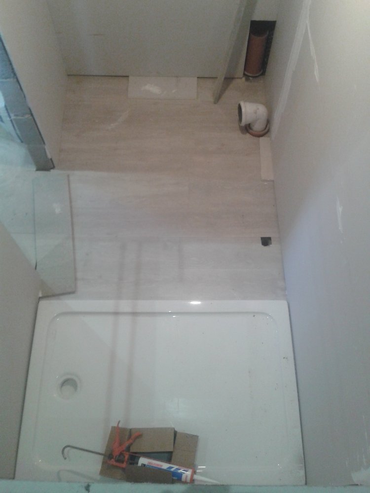

what were the reasons you can't do a wet room floor?
could run dpm on the floor (and into the drain), slate tiles over that?
would need some kind of break in the slate over the door threshold...
tho if it's one of those things you just want it done and out of the way I guess it makes no difference anyway
the shower try like that I fitted had a little up stand on one end and one side, so that was flush to the wall and then the wall tiles overlapped it a bit
no idea about those wall sheets, I've never used them.... if you were sing tiles I'd say get small ones, they hide uneven stuff better than big ones
