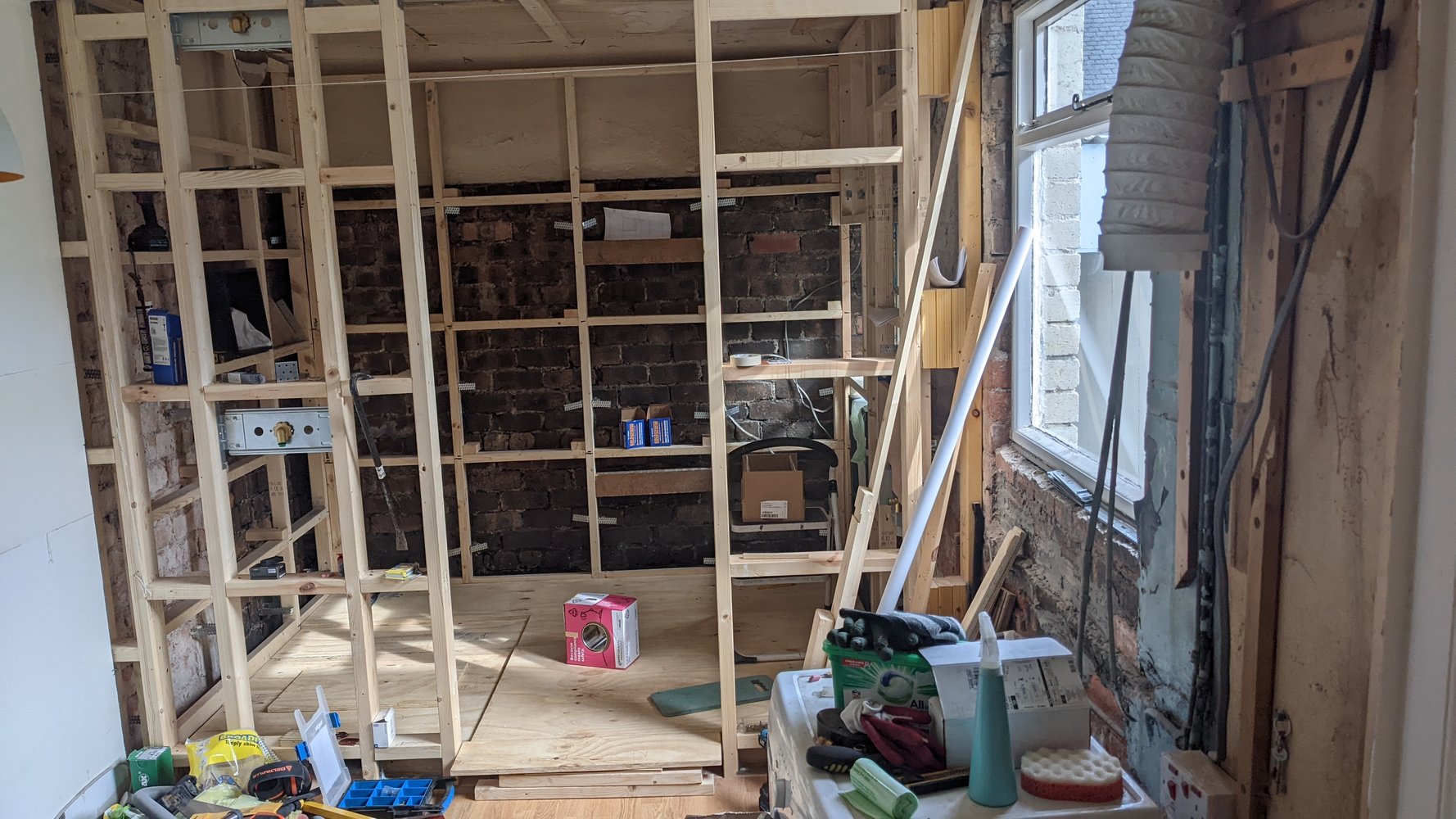

Can anyone recommend a good led light I can use in a shower niche, I assume it will need to be 12volt with a remote driver. Needs to be no more than 30mm or so in diameter.

any pics of said niche?It's going into a 100mm deep niche so don't want the diameter to be too big.

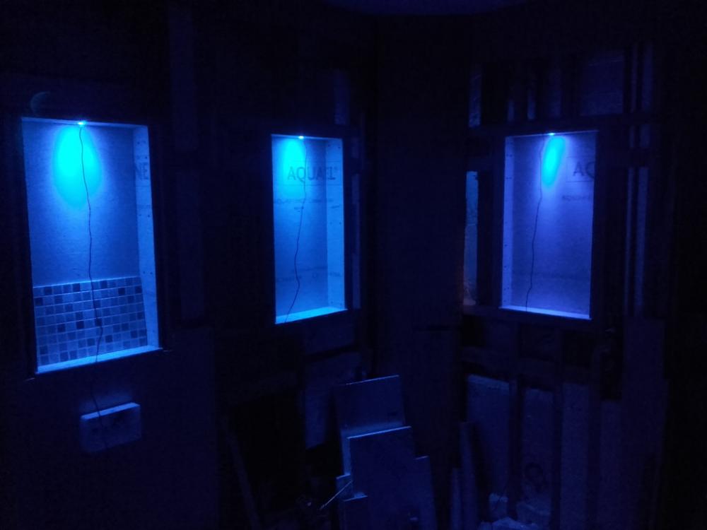

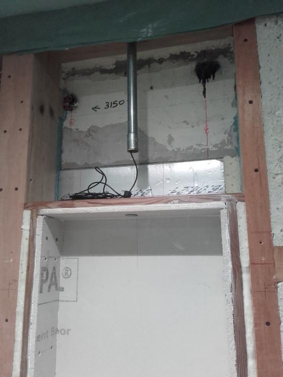

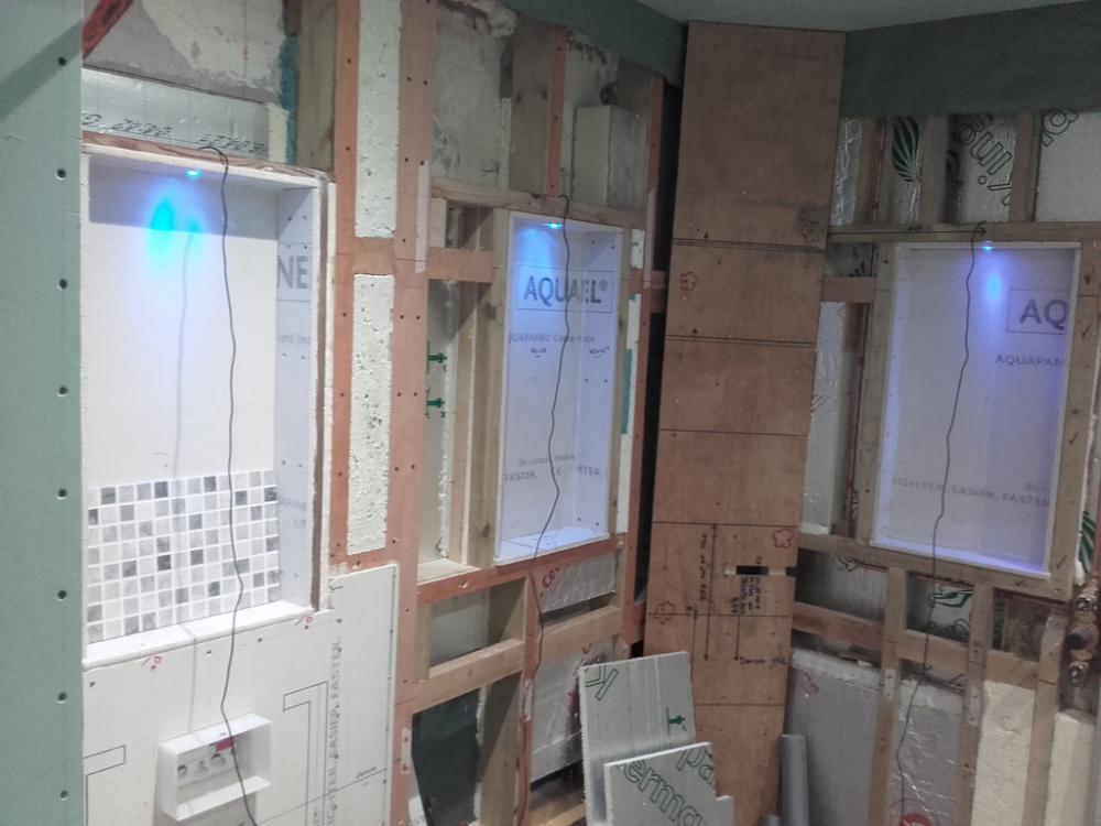

its recessed in the ceiling no need for access in the wallthat one is IP67 so its water proof , only issue would be the fixed lead , which would have to be buried in the wall unless you have access to the rear of the shower.

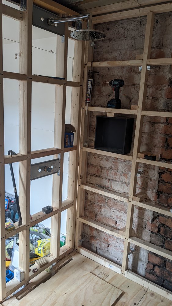

It's going into the wall, see the niche box in the pic just above.its recessed in the ceiling no need for access in the wall
may be in the wall but is still up in the top facing down over and in the void aboveIt's going into the wall, see the niche box in the pic just above.
