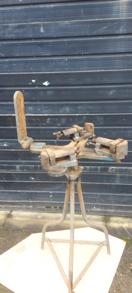

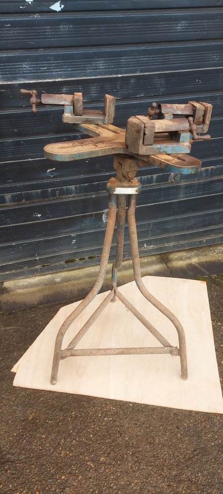

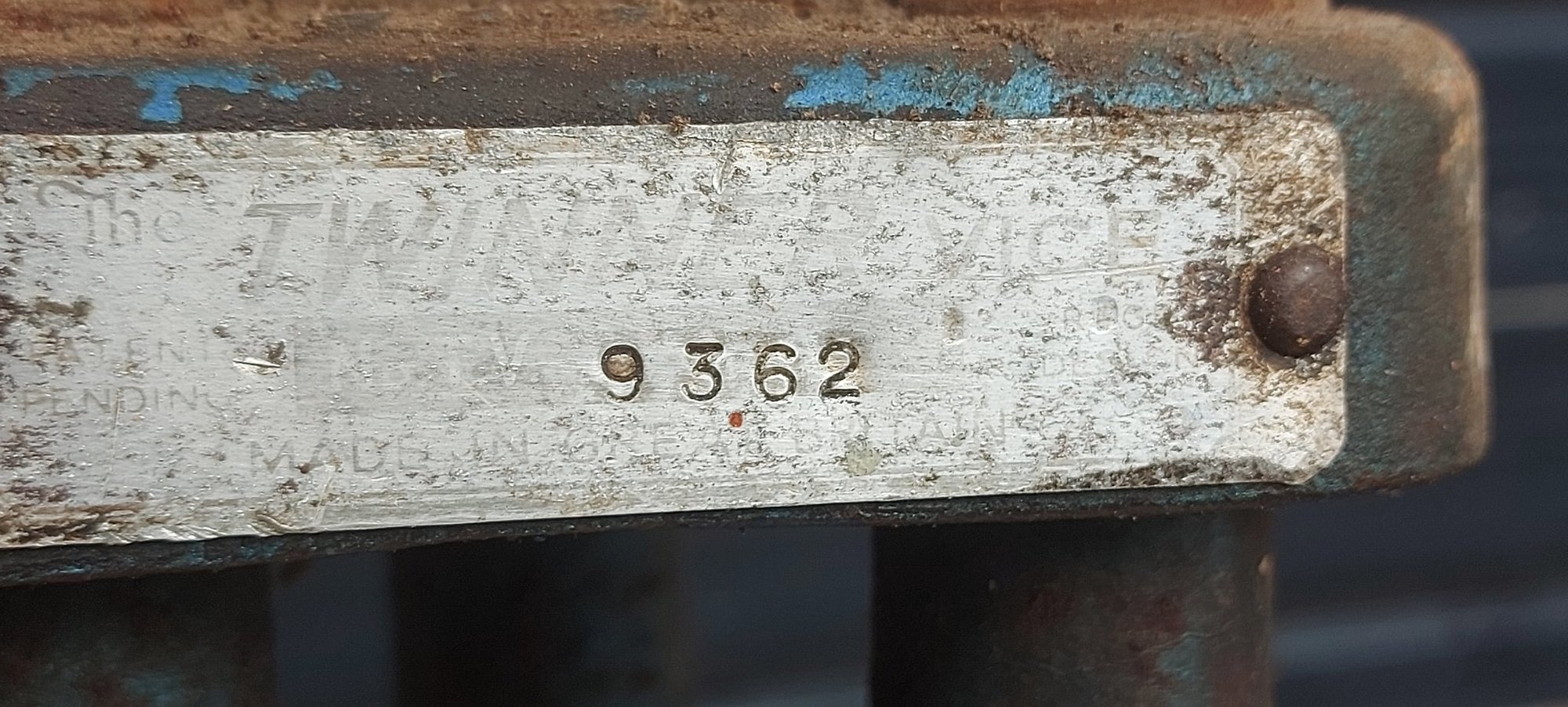

That's worthy of a refurbish.Here is a , Twinner vice, welding positioner, it came from the smiddy( Scottish, for Blacksmiths shop) of a local farm, when farm was sold, about 40 years ago. It hasn't been used for a good 20 years.
It has 4 vices, that can be adjusted, in or out , or swiveled around to any angle. The top plate rotates 360 degrees and can be tilted up to 90 degrees.
it also has two extension legs , that can be fitted for larger pieces.

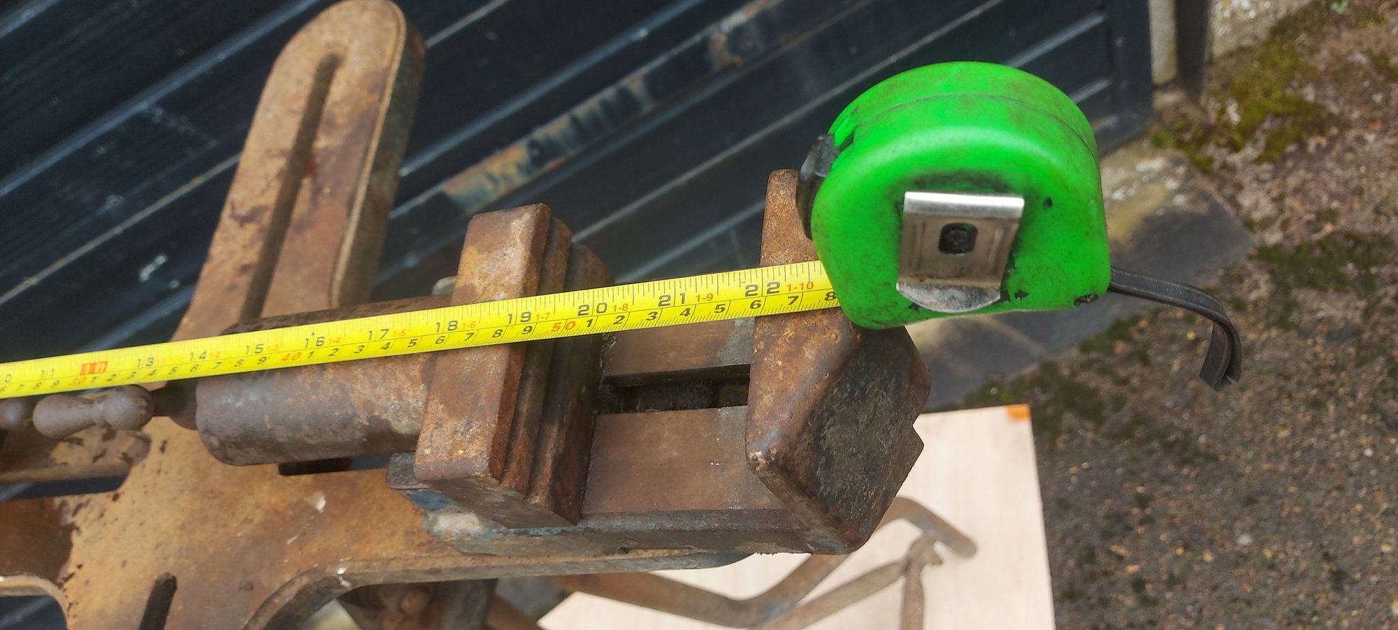

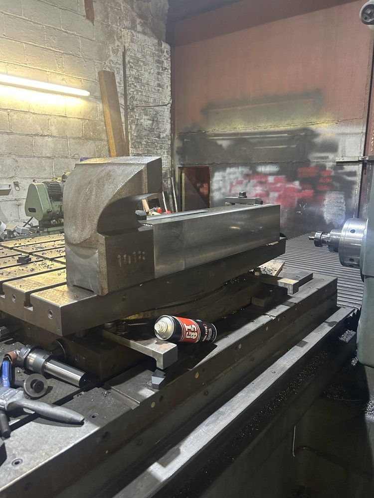

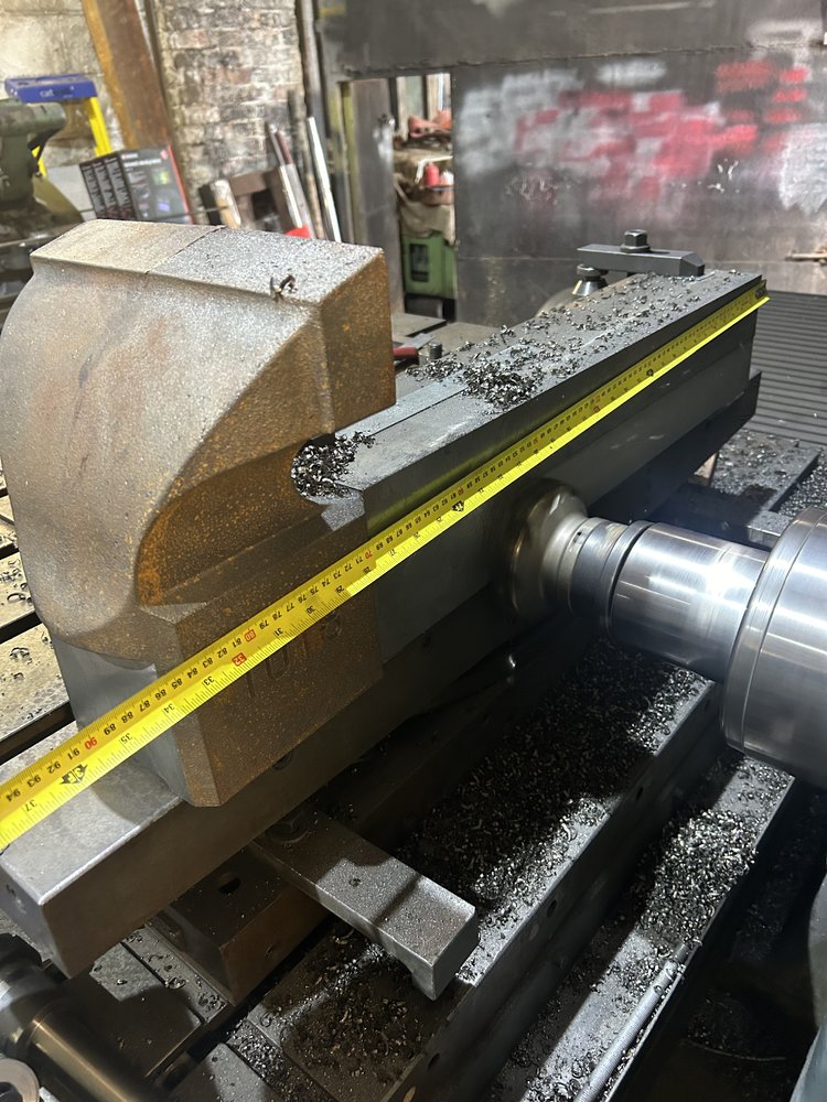

That's the Devlieg vibrating too muchWhat length is that? Photo's a bit blurry.
