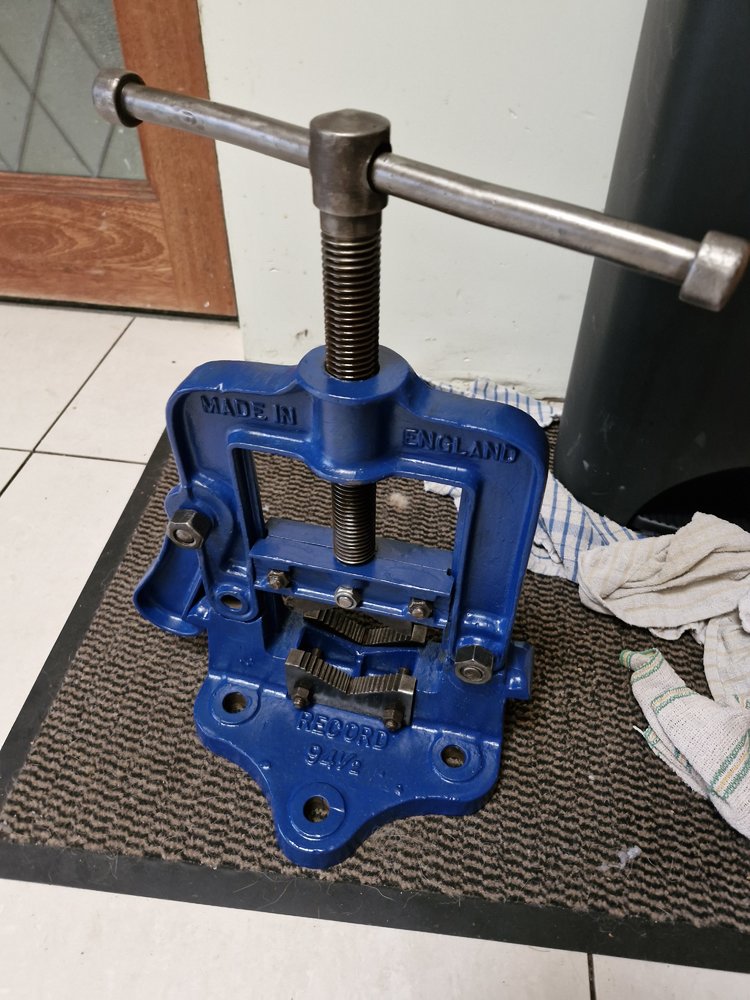

Wind out the moving jaw.I obtained this last week when I spotted someone about to dump it at the local tip
Unbelievable what people throw away!
Any adVICE on how to strip it down for a clean up? There's a load of weld strikes on the sides I might grind off carefully but it's not in bad condition as far as I can see.
Record No23.
View attachment 455820View attachment 455821
Undo the square bolts holding the Half Nut.
Undo the two C/sunk screws holding the Captive plate for the Release bar.
Slide out the screw and bar.
The single screw holding the bar in will be a "nasty item" to remove.
As will the 4 C/sunk screws holding the jaws in place.
Time and het are your friends.
Don't bother removing the sliding handle, just clean up with a wire brush.
As will the body.
The rest us simple, any ? Pm me.
