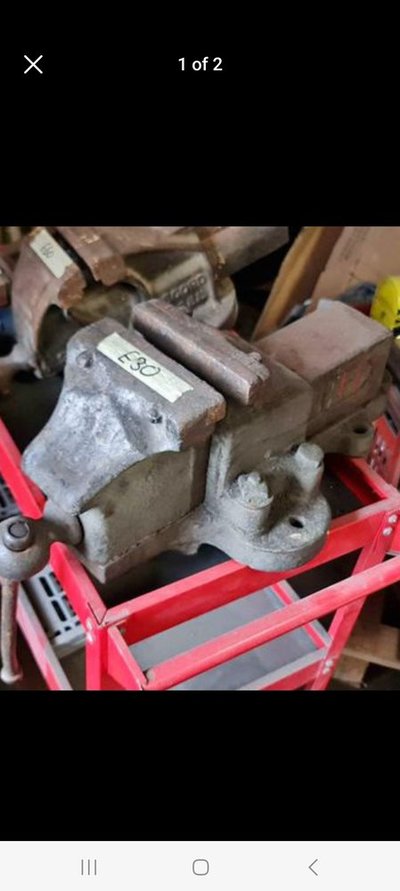

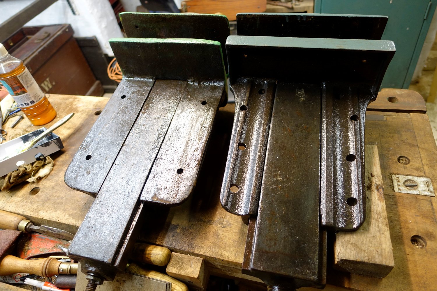

Yep, that part of the jaw shelf is missing. Happens from hammering down on the jaws when screws are loose.

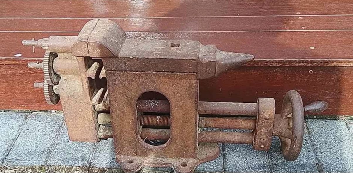

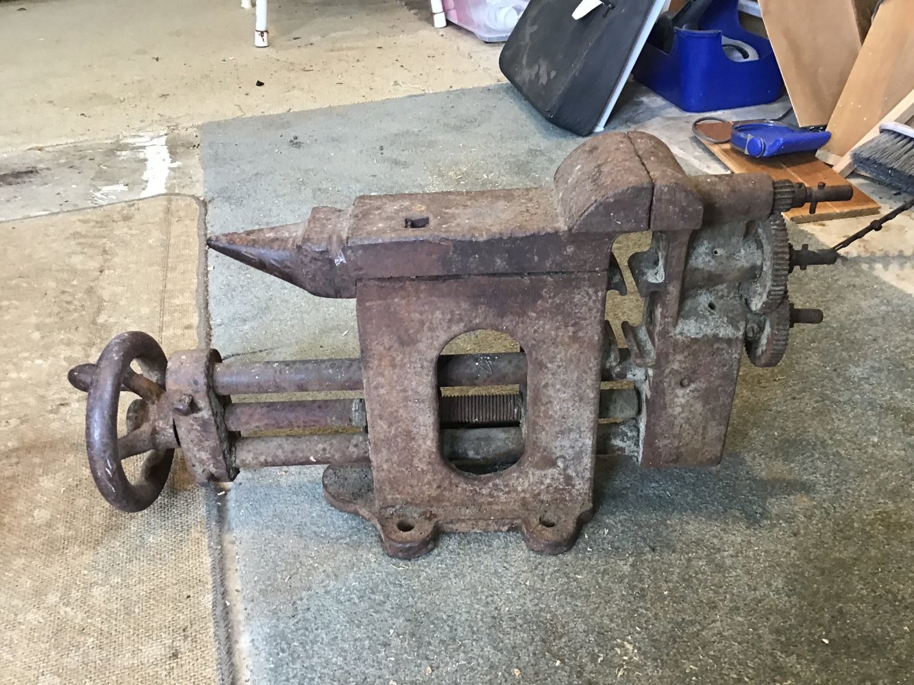

i havent seen one of these before, what do we all think is it a unicorn? looks well worn
A record before record began?

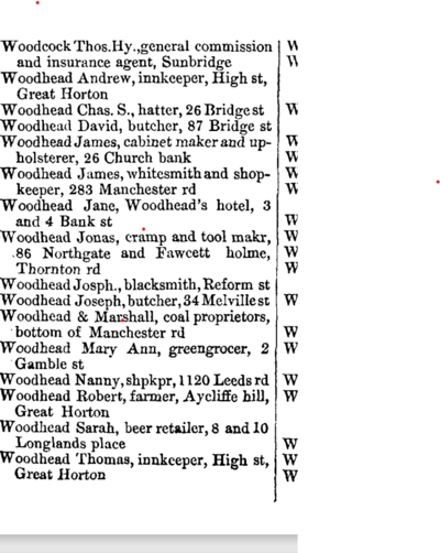

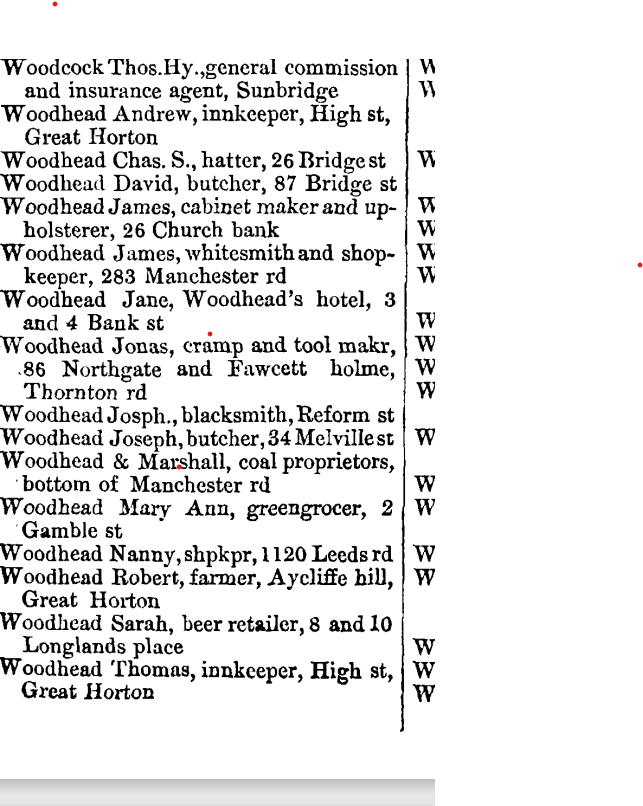

I think that Bradford may have been the birthplace of the British cast iron vice (plenty of wrought iron leg vices before that, from W Mids, Sheffield and elsewhere). Doing some online searching, found 'Jones Mercantile Directory' of 1863 - thanks to Bradford Library.
-- no Entwhistle and Kenyon, no Smith, Marks, Riley or Wilson or Syers (London) not even Parkinson, in the right kind of business in1863, in Bradford, Keighley or Shipley. So J Parkinson of Shipley must have grown fast (not unusual at that time), to be such a big maker of vices/vices by the late 1880s. (and other machine tools).
Parkinsons Vise catalogue of 1937 says they started vice manufacture in 1882 - presumably the earlier version of the 'Handy' type with three main castings, (their QR patent was mid-1880s and for a while those were being made by Cocker Bros of Sheffield.)
However I have been aware of the probability that there was a series of very hefty cast iron woodworking vices coming out of this area, non QR, but seemingly earlier than the above, of a few variations, and some resemblance to the later (1877) Syers type and the E&K rack and cam QR vices.

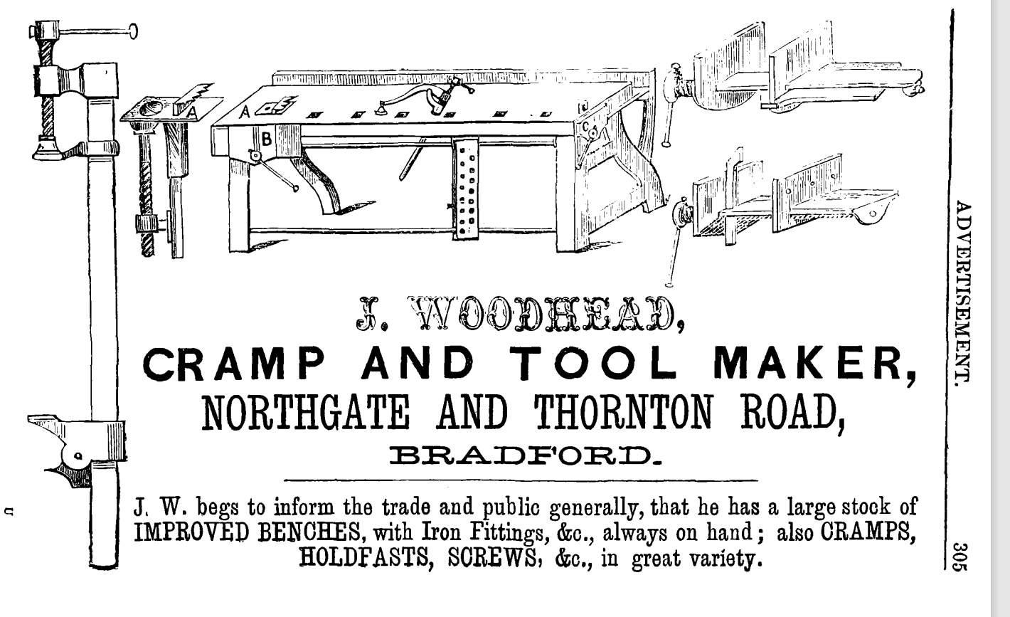

Here are the entry and ad for Jonas Woodhead (founded 1847 and later to get into the railway, then auto spring and shock business and move to Leeds in 1892, still in existence).
View attachment 425390View attachment 425391
Although not a big concern, doesn't look like new to this business ('large stock', different models of vice) . Vices are not mentioned in the script, but may be covered by the term cramp - and obviously at least two vice variants are shown.
I think the railway train leaf spring business was such a big deal, (and Parkinson growing so fast), that Woodhead got out of vices by about 1890 at the latest.

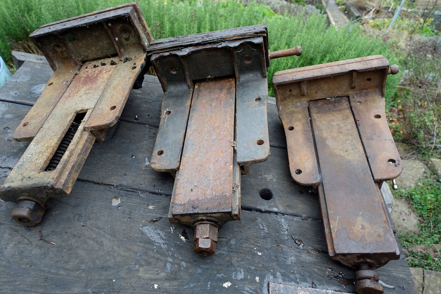

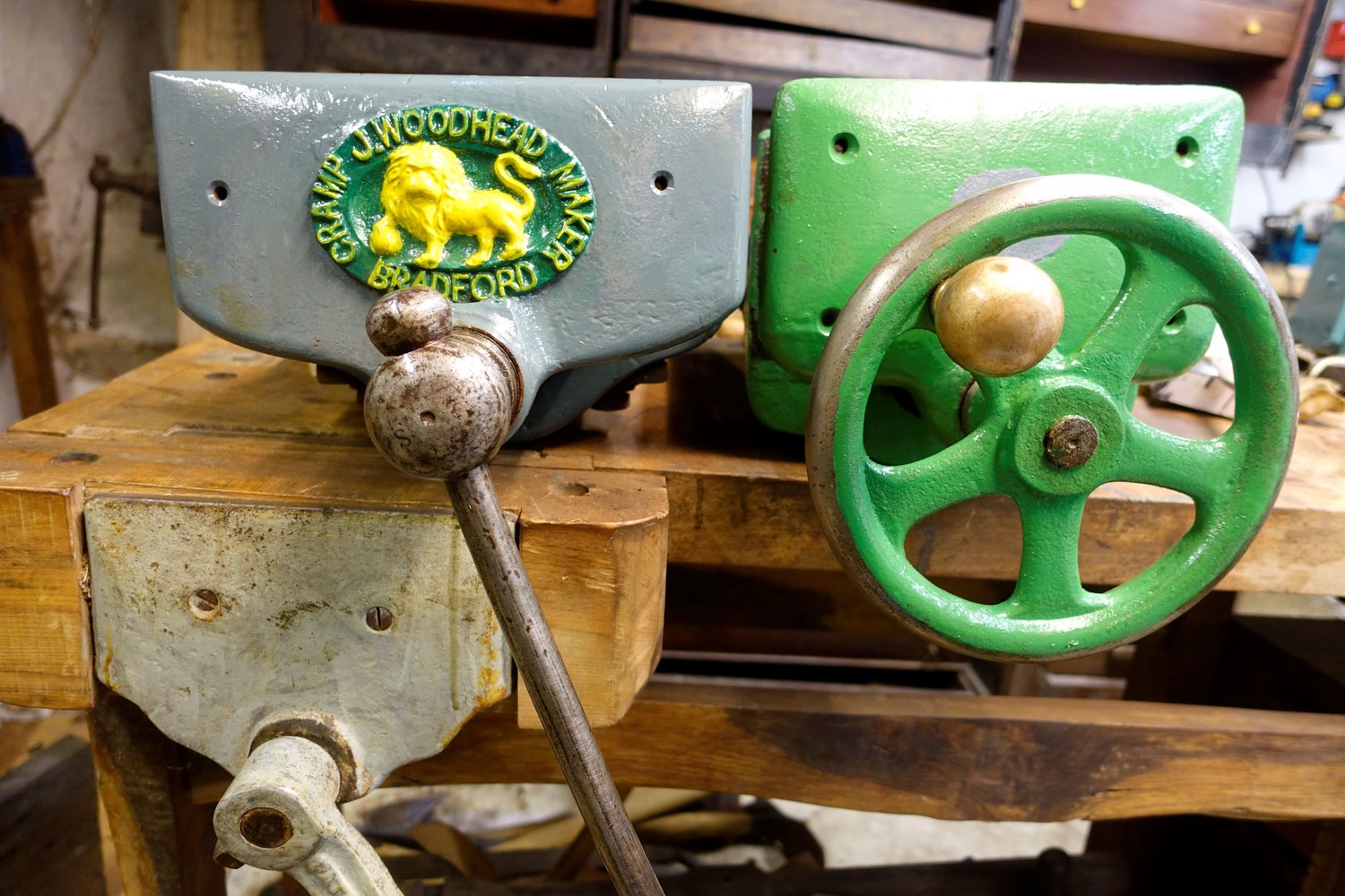

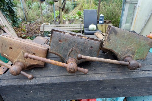

I have one clearly marked as J Woodhead (just refurbing, will show soon) and 4 others that may well have come from them - poss back to late 1840s?? (A quick skip thro the directory didn't get me any other vice or cramp makers except an anvil and vice maker which makes me think leg vice)

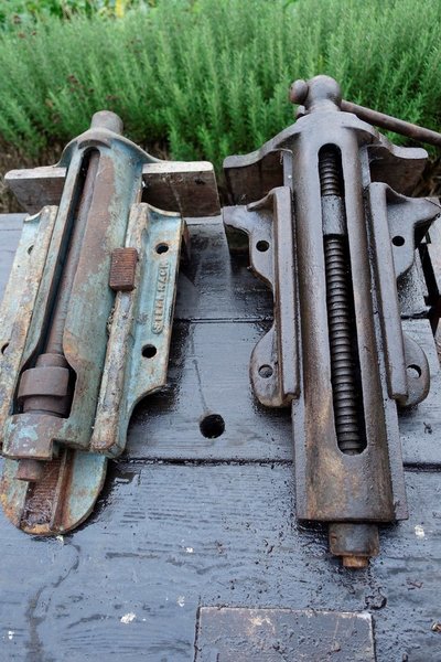

pre1900 Parkinsons' Handy (not the 'improved' version ???
I don't see the two bolts above the fixing bolt in any pictures I look at?pre1900 Parkinsons' Handy (not the 'improved' version ???
however, one story is that they got fed up w copies - so cld be a copy?
ps, just noted the jaws bolted from behind --- original?
