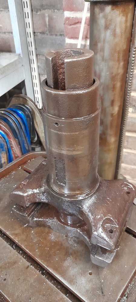

Much as I hate to suggest it you might want to try soaking it in vinegar. Electrolysis is more of a line of sight thing and I suspect it hasn't removed the heavy rust that is on the outside of the inner slide where it is sitting in the recess at the back. I haven't explained that very well.I previously posted photos of this vice - swindens 6" - and explained I was having problems dismantling. Yes, I have the other bits. It's seized up with rust and I've tried electrolysis, heat, oil, etc. I finally sought assistance of my very friendly local garage and we couldn't shift it with just over 10t from a 20t hydraulic press. We also tried heat but agreed we really needed more heat which we didn't have. I reckon it would shift if heated HOT and hydraulic press, but who knows?

All good advice but I don't have the time or interest to spend much longer on this vice. I think we are all familiar with a project that has overrun and needs to go.Yes, I've had issues splitting one before. Heat and power is the answer.
The trick is to place that power in the right spot. Pressing on the rear exposed part of the moving jaw will eventually mushroom it and you'll never split it apart.
I think if I had a really intransigent unit, I'd make up some fine wedges so that I could gradually prise the jaws apart by hammering those wedges between the two jaw sections. You might even be able to drive wedges with a press for the belt and braces approach. Either way you will also be wanting to get it plenty hot before and during the process. Note when I say a "fine" wedge, I mean a foot long wedge that will only taper by a few mm at most. It will need to be properly engineered to provide parallel pressure (on both sides!) so not just a single wedge on it's own but which fits into an expanding mandrel, shaped to fit inside the jaws (close to the body, not the tip of the jaws).
Lot to be said for "tapping it" with a hammer while it is under pressure remembering that stuck items can also creep so leaving them under pressure for some period of time can also work.
The danger with wedging it is getting the wedges stuck or friction welded inside the workpiece. Engineer that possibility out before you start!
If all else fails and you give up (before you manage to break it), send it to me...
<edit> Be careful with the captive lead nut. If that becomes racked inside the body, it's never coming apart. Worth clearing the inner guide on the moving jaw (which has a long open slot) with a scraper and consider using a threaded rod to help push/pull it at the same time as you're pushing on the body.

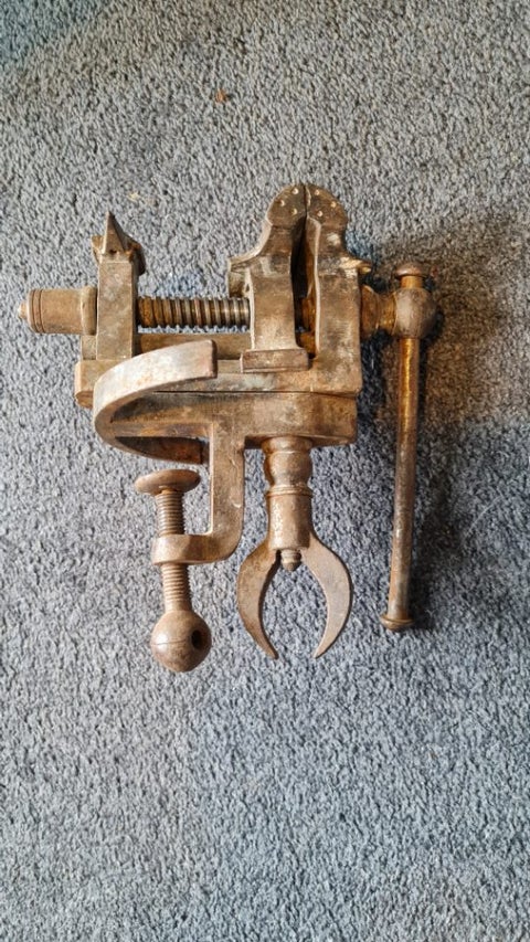

Unusual anvil feature in the first photo, and I'm wondering if the dots shown on the jaws are actually holes for pins to be inserted as another internal or external holding option ?Does anyone know much about this, was bidding on it locally, however someone has deeper pockets than me,seemed interesting however at 225 bucks it seems someone knew something I don't
