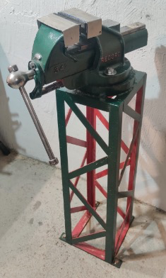

On colour, I did seriously consider Paragon paint...
However, as I was going to use it rather than show it or sell it and I really don't like the colour, I decided to go with green/red.
On the 'P' it is almost ground out, but the lighting in the first pictures has made it stand out more than it really does. I think all of the moving jaws were cast with a 'P' and they just ground it out as needed.

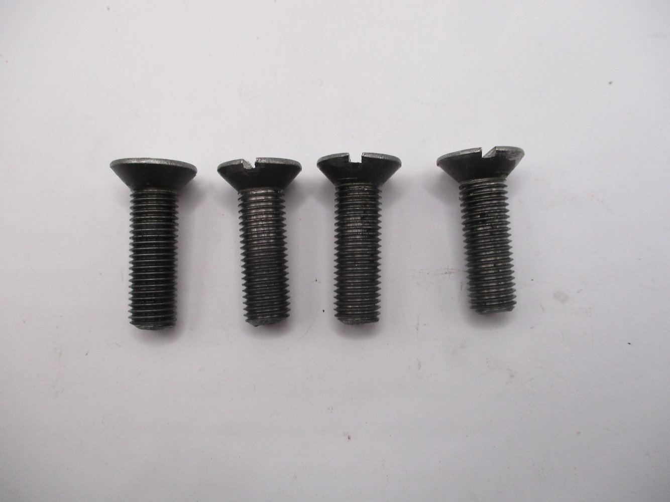

Here it is bolted to the floor and in use with some soft jaws I made from shoe heel rubber and and an aluminium shroud made from an old roller window blind cover. I also have a longer pair with no rubber which I use when I am [stick] welding to protect the vice from sputter.

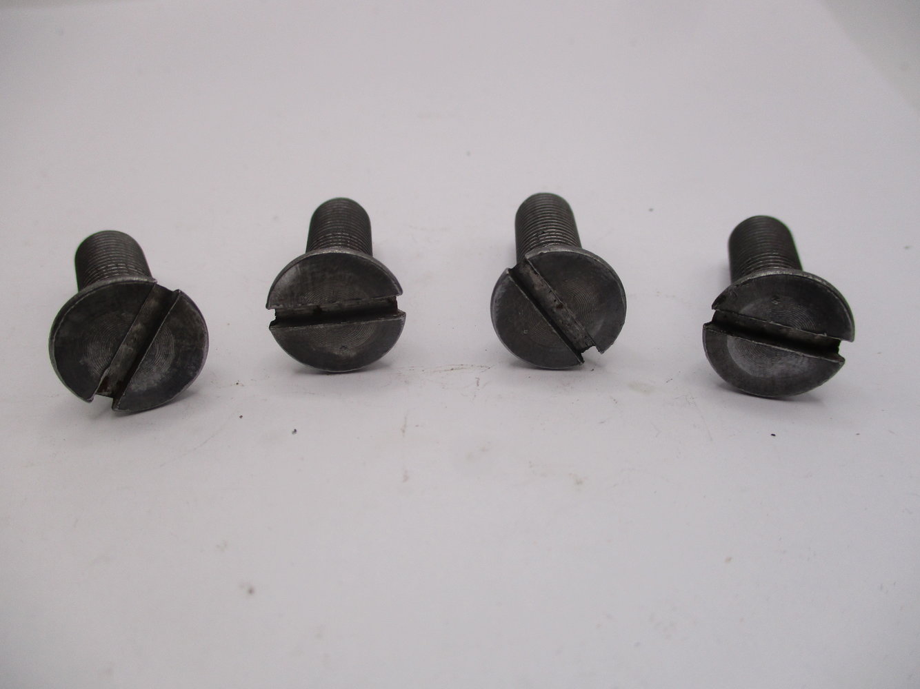

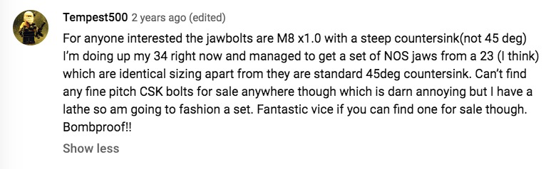

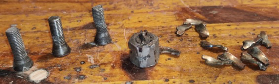

I thought I'd mention the jaw screws as they were a right job to get out. I made an adaptor out of a couple of nuts for my impact driver and several bits out of stainless washers (these are the used, twisted ones) and whacked the screws until I won. One screw broke but I managed to tease the broken part out. The other three came out whole but as you can see, not really useable.
Interestingly for the time/place of production and the rest of the threads, the screws are 8mmx1.0mm screws rather than imperial. I got some new ones turned up
