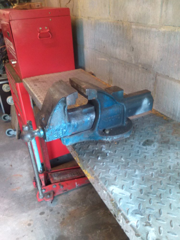

Is there a reason for the unusual position g of the vice?
so it dosen't stick out too farIs there a reason for the unusual position g of the vice?
. has it's pro's and cons. if you have an arm in or something it'll sit on table. pushing bushes/bearings in. As long as it works for you, that's what matters.so it dosen't stick out too far. has it's pro's and cons. if you have an arm in or something it'll sit on table. pushing bushes/bearings in.
cons are working down over flat lining the side of the bench. it comes out like a foot so i can chock the backside up.

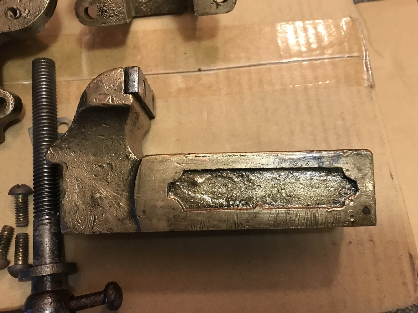

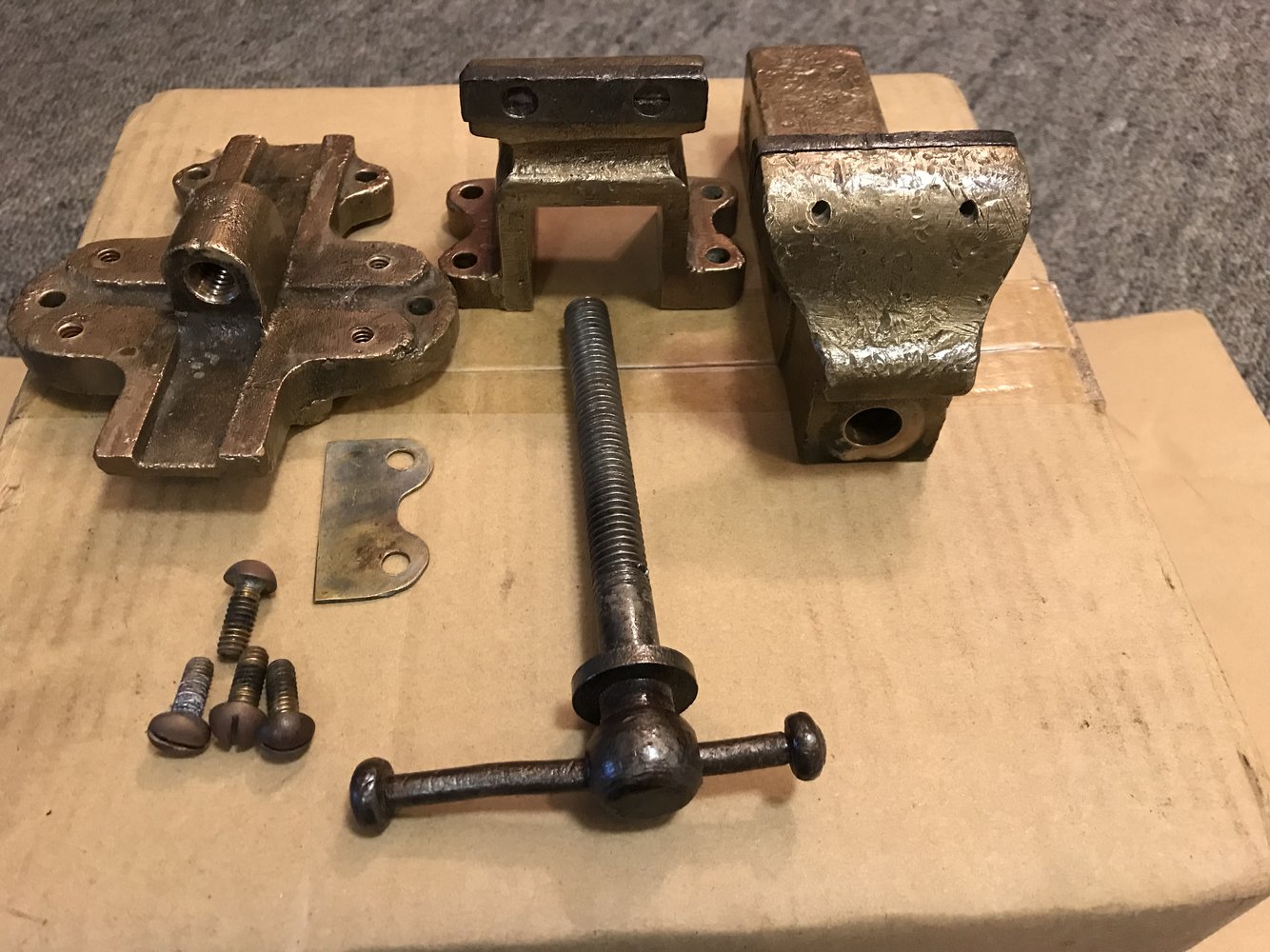

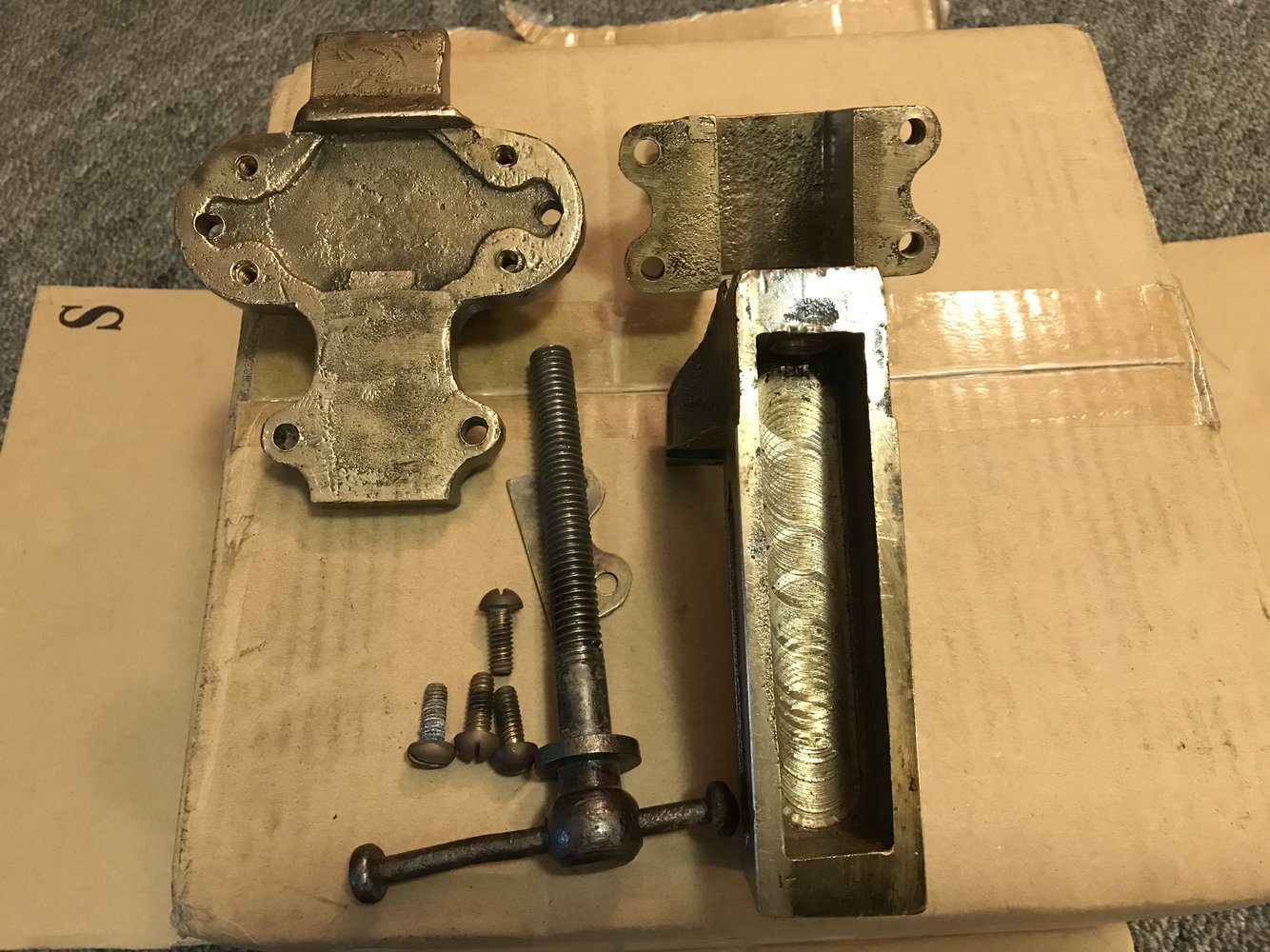

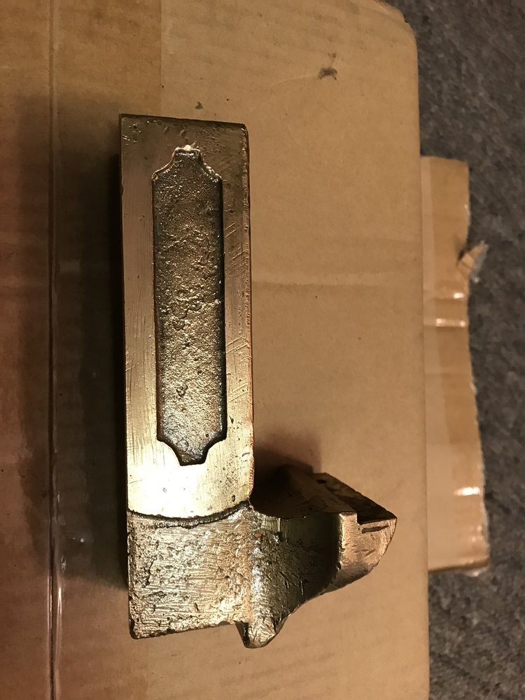

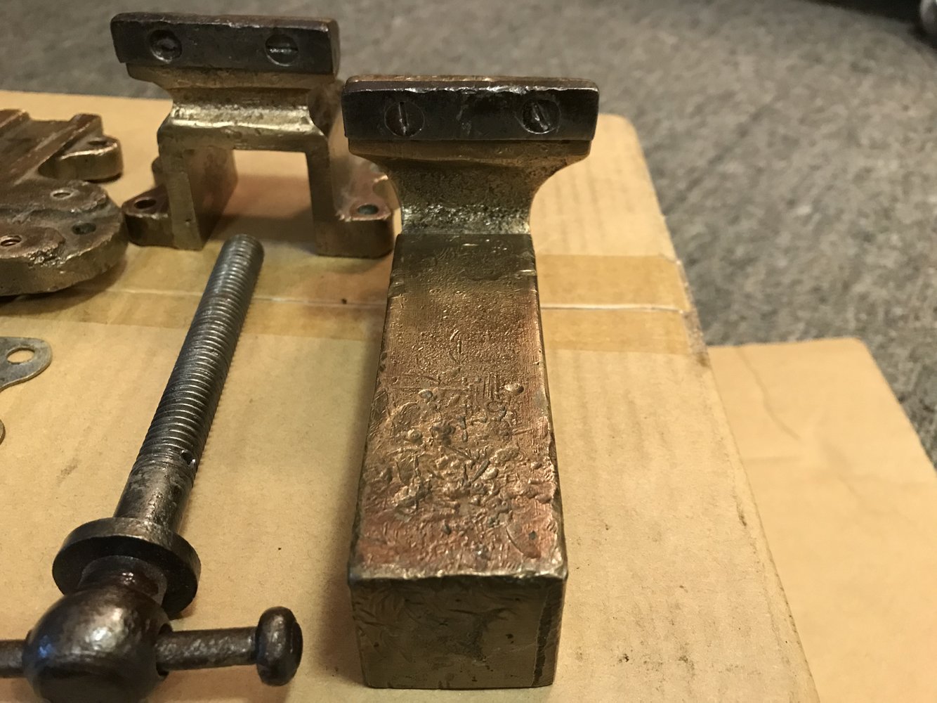

Nice and unusual vice RangerMy brass vice arrived today, is in ok order missing two jaw screws and collar for main screw. Both missing jaw screws have snapped off, one of the brass screws that hold down the rear carriage is different front the others. jaw plates are smooth steel. Main screw is acme, Shows quite a lot of use, there is a brass shim under one side, which I had with my large 5 inch of similar design posted previously
jaw width is 56 mm
no markings at all, domed screws are not original as they are too short I feel, thoughts would be great
jaw width is 56 mm
Other side is smootherthanks for this -- interesting
casting is a bit rough (eg see inside nice old Parky-type slide ways) - ie suggests either an early result before they'd finalised the mould runners and risers and pouring speed, or a sneaky one-off done on the night shift
original vices of this type/size nearly always had acme thread if not QR - this looks like a normal 'V-shape' screw thread, which would be the usual for a gen purpose machinist to fab

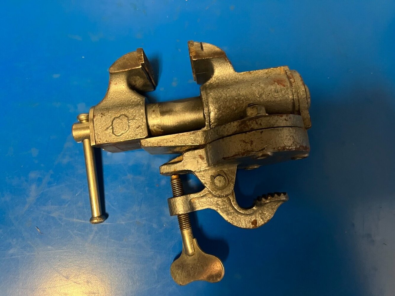

Yes I saw that, I'd never seen one of those before, I agree it really is interesting all this vice history stuff.talking of Peter Wright, they were nearish neighbours of Vono, who patented their slightly similar looking (tube shaped slider into circ cross sect way in fixed jaw body, a bit like the 'box' of a parallel wrought iron type)
well there's a Peter Wright which is actually a Vono on th'bay UK right now - cast iron no 3C which is the Vono model no., with the Vono patent and reg des nos cast in, but 'Peter Wright' where it should say Vono (my links never work, but search 'Peter Wright No 3C' if interested) -- so I guess there was some licensing or PW took over the patterns for this or?
btw ----- it's not cheap for a small bench vice but has a uniqueness value although I think I may have seen one before (also a 3C) BUT you should check the photos v.carefully if bidding as I think it may have quite a big weld repair - which could do with more fill in some places and a careful grind down - beneath the paint. maybe an offer?
vice making history is more complex than it seems at first, but interesting
