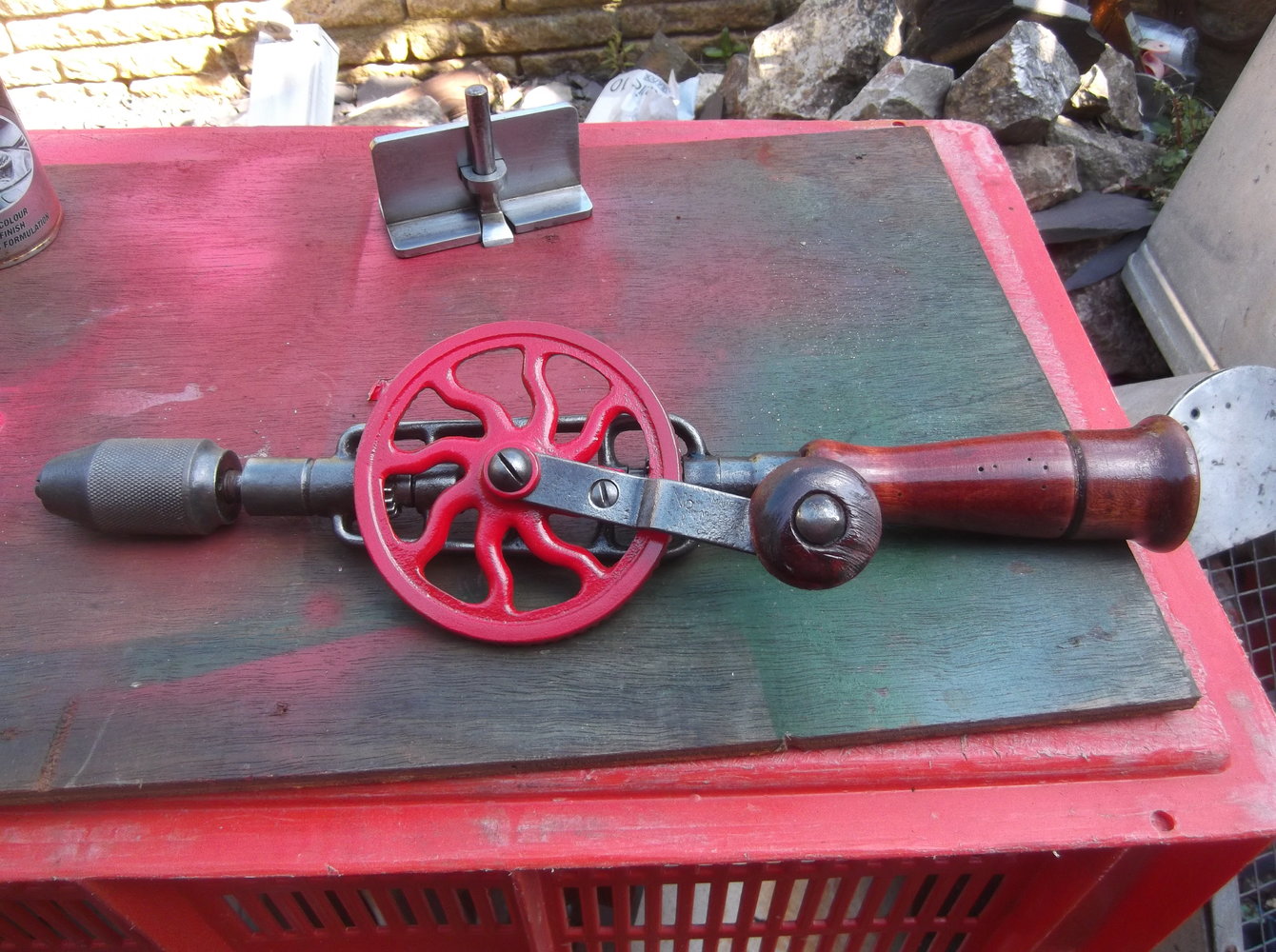

Yup, here's a close up.
.View attachment 361925

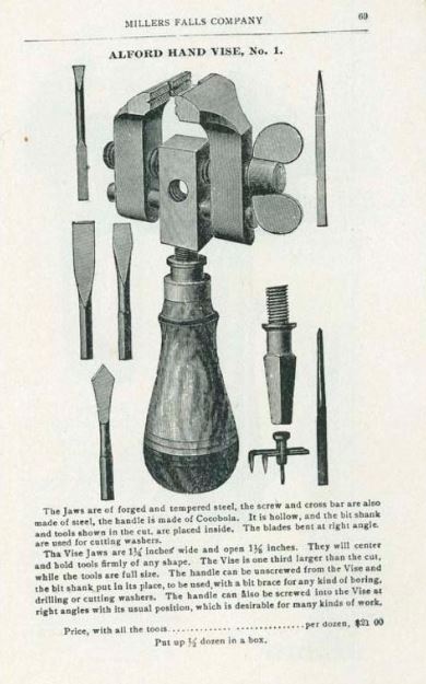

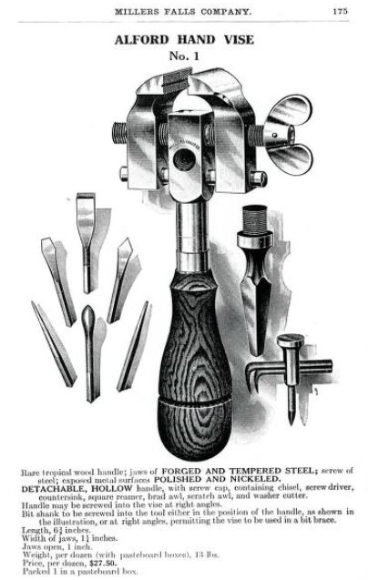

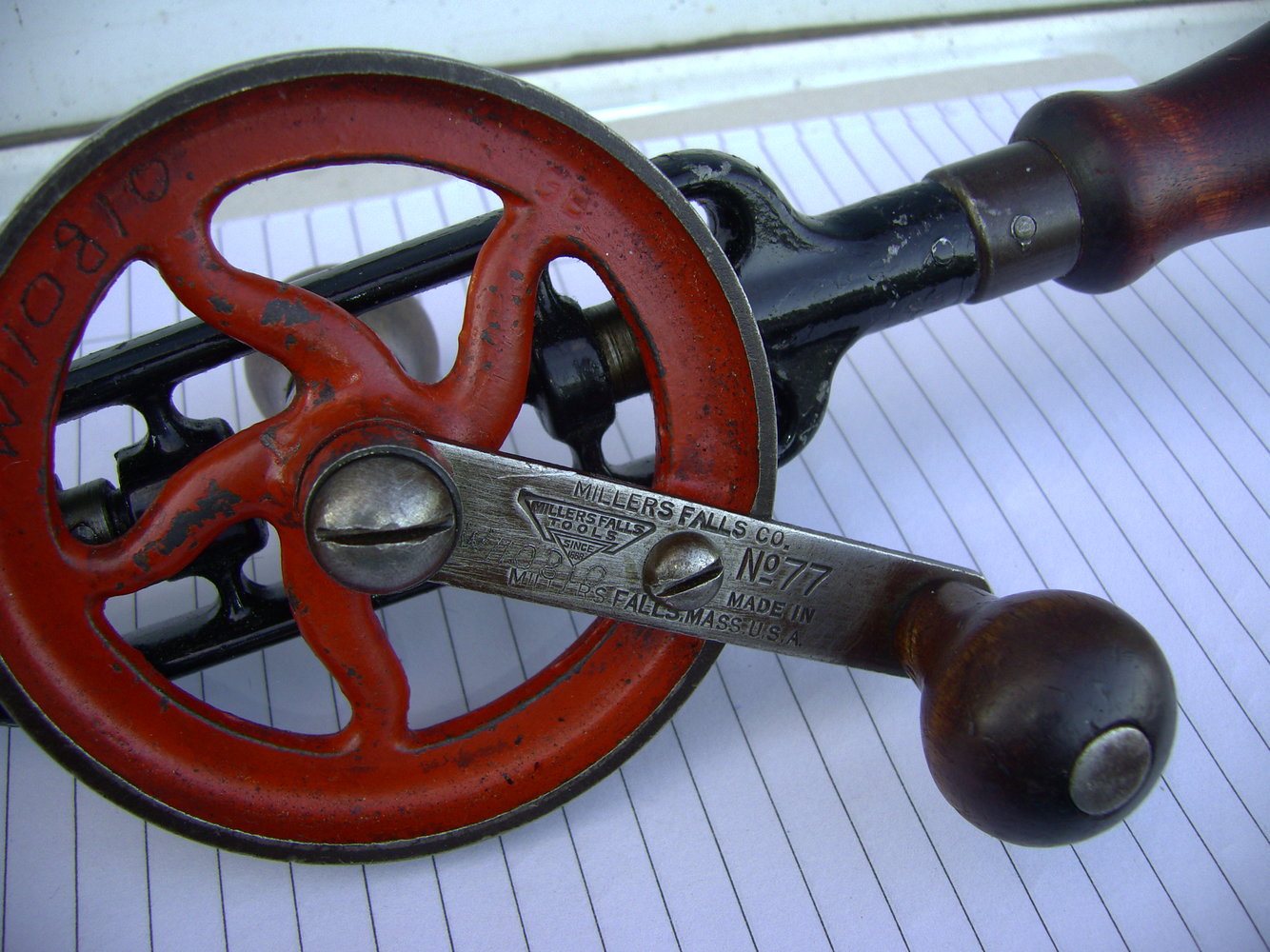

millers falls catelogues shows your one which has a distinct black end wood to be from its 1908 editionThat appears to be a "Millers Falls" hand vice.
.View attachment 361734View attachment 361735View attachment 361736

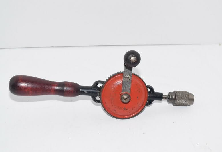

I have no idea about the handle being correct, and I don't think my Dad bought his new, because there is an identification marking on the handle that isn't his.Wow, almost like a no.5.All 77 I've seen look like this;View attachment 361942
Ahh, I see the threaded brace adapter is missing from mine. I bought the hand vice used many years ago, and its one of the tools I use quite often as I have some difficulty with holding very small items due to arthritis in my hands.millers falls catelogues shows your one which has a distinct black end wood to be from its 1908 edition
the later ones from 1925 onwards show the handle made out of the same piece of rare tropical rainforest wood!
Wow, looking at the prices for the times, these hand vices were extremely expensive !millers falls catelogues shows your one which has a distinct black end wood to be from its 1908 edition

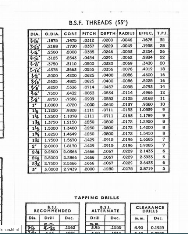

Just a courtesy note: I measured the threads on my Millers Falls hand vise, and its not a common one. Its 3/8" diameter by 20 threads per inch.
I am led to beleive it is a Odd american tap size.Just a courtesy note: I measured the threads on my Millers Falls hand vise, and its not a common one. Its 3/8" diameter by 20 threads per inch.
It had occurred to me that it might be. These tools were costly and well made so tradesmen repaired them as necessary. My MF No2 has a brass handle to its crank that someone has added over the years, works fine. As for the web site, my pleasure, it's worth searching through there is a lot of information and minutiae on tools and tool collecting.Interesting, haven't seen this before, thanks for posting.I see that apparently the crank handle on my Dad's drill was from another model.
The thread is a bit cours for a BSF.It had occurred to me that it might be. These tools were costly and well made so tradesmen repaired them as necessary. My MF No2 has a brass handle to its crank that someone has added over the years, works fine. As for the web site, my pleasure, it's worth searching through there is a lot of information and minutiae on tools and tool collecting.
According to my Zeus Book, 3/8 BSF has 20TPI.
Note prices shown are per dozenWow, looking at the prices for the times, these hand vices were extremely expensive !

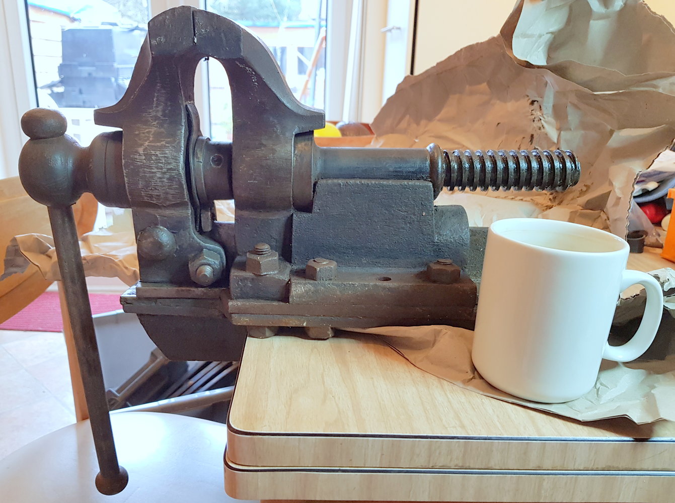

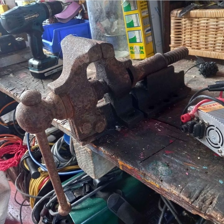

Thanks. I had a quick Google, and suggests it might be as old as it looks (110+ yo) and a decent bit of kit.It looks like Peter Wright pattern.
Nice! Are they good vices? The limited blurb I read indicated that PW was a very well respected Victorian Mfr of Anvils and Vices.
