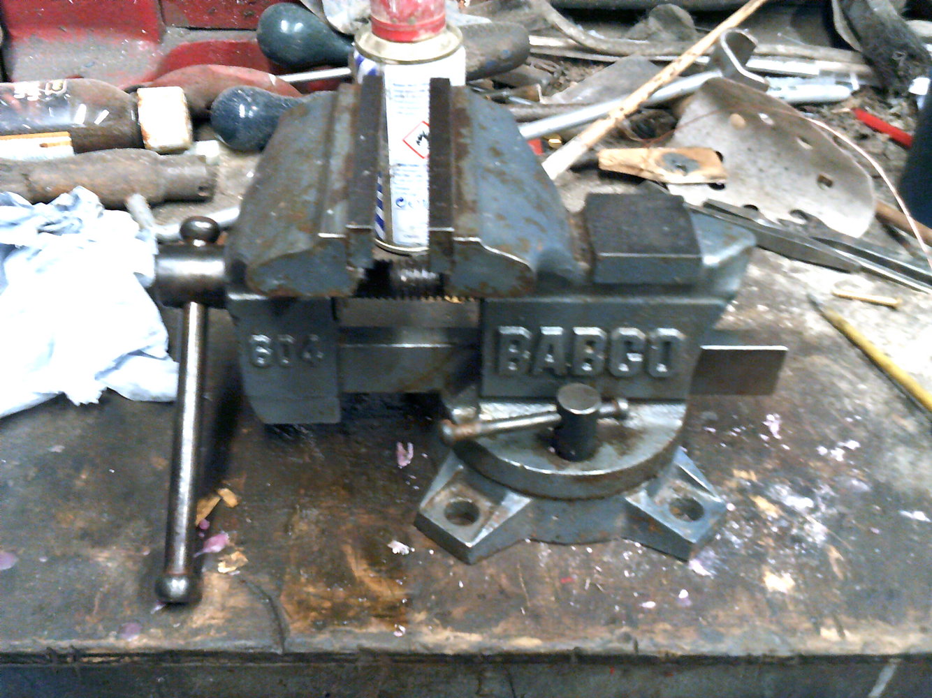

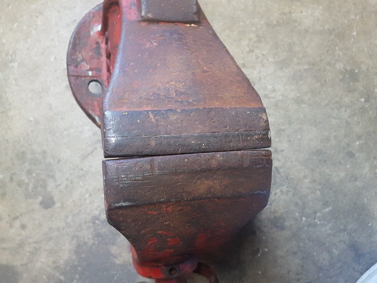

While I don't doubt this may be the case I am a little sceptical. Jaw plates are hardened and are unlikely to distort to this extent, IMO. I'd want to measure and examine the plate for wear and distortion.thing is, steel is hard to cast as there are many rejects, cast iron and ductile iron is perfect for casting, makes a fine looking object, ductile having a higher tensile strength than cast grey
cast iron has very little tensile strength, i know ive over tightened the underneath bench clamp screw on a clamp vice and "ping"
steel is high tensile can take shock or hammering etc however it bends
picture is of a record steel 35, constant cranking of objects on the edges of the jaws have bent the front jaw and jaw plate into a semi circle type shape

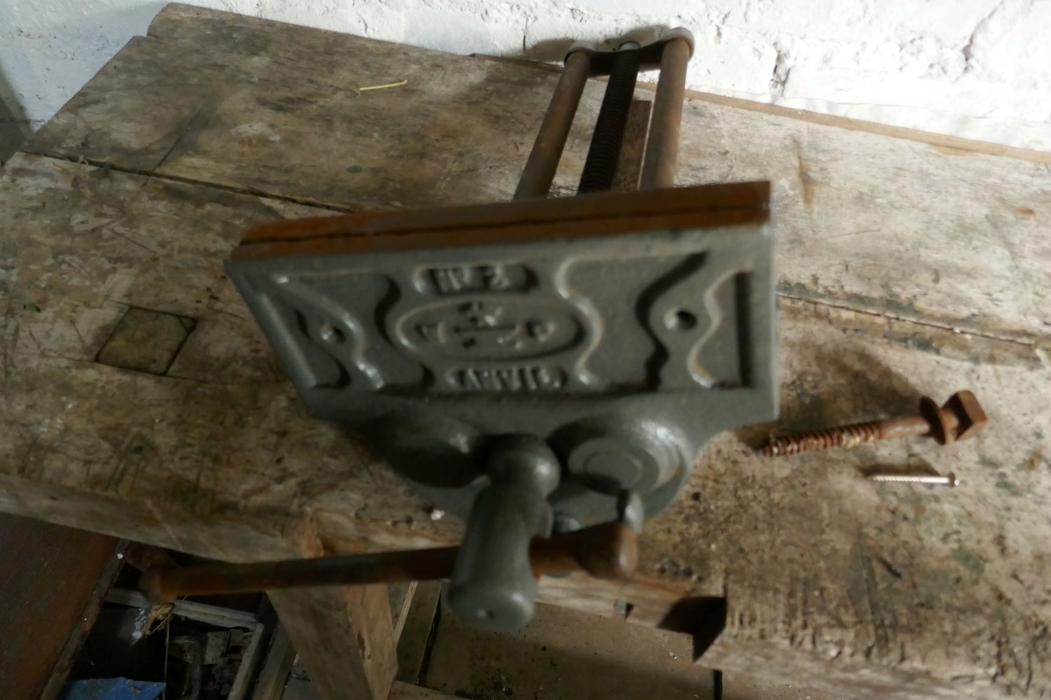

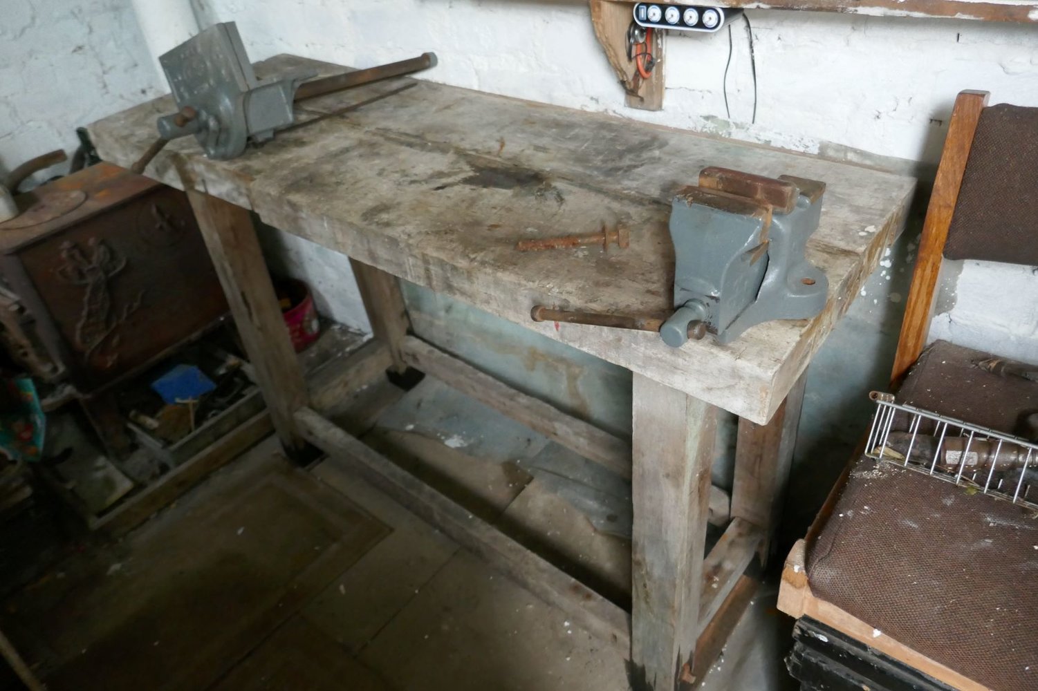

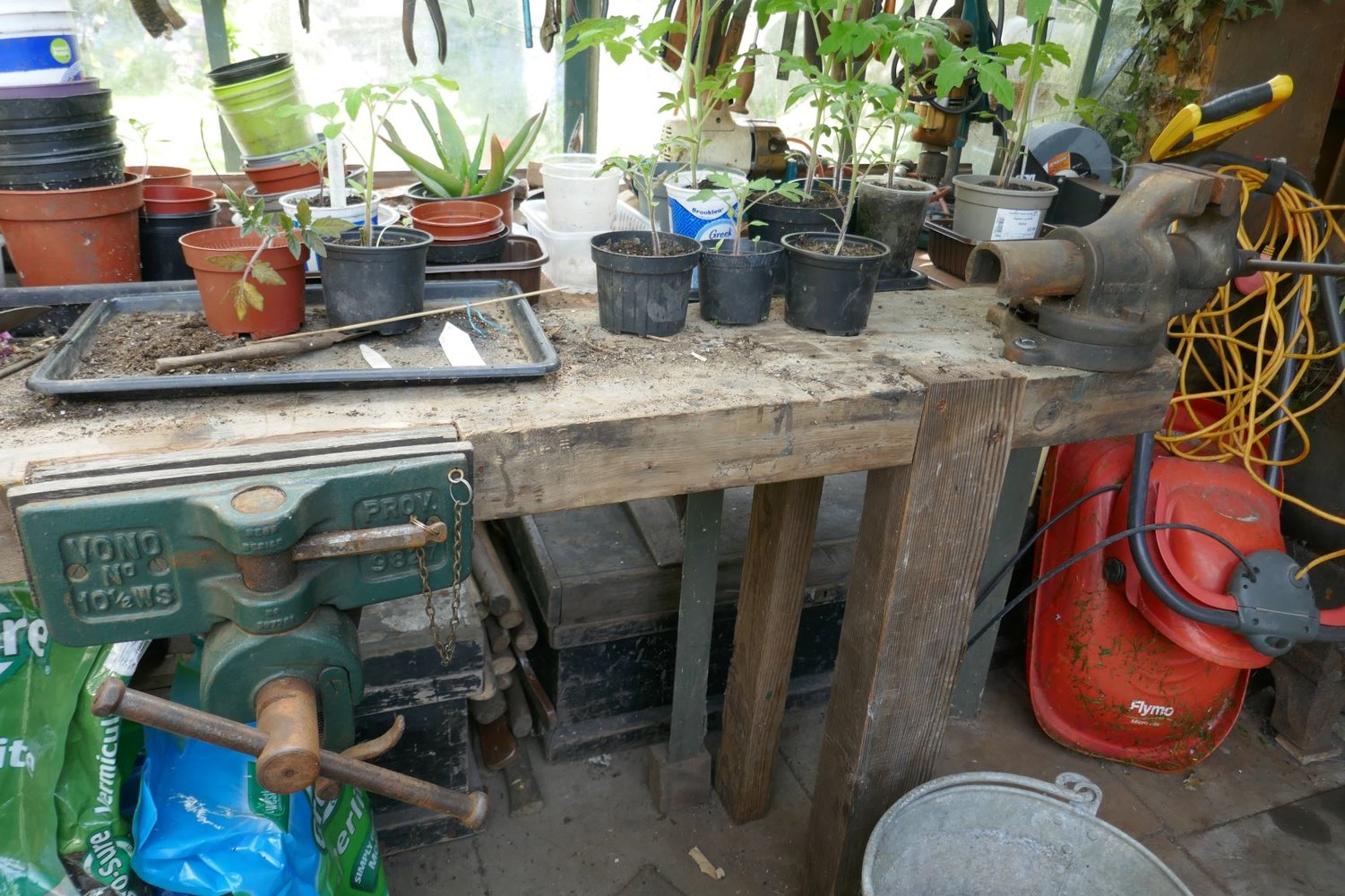

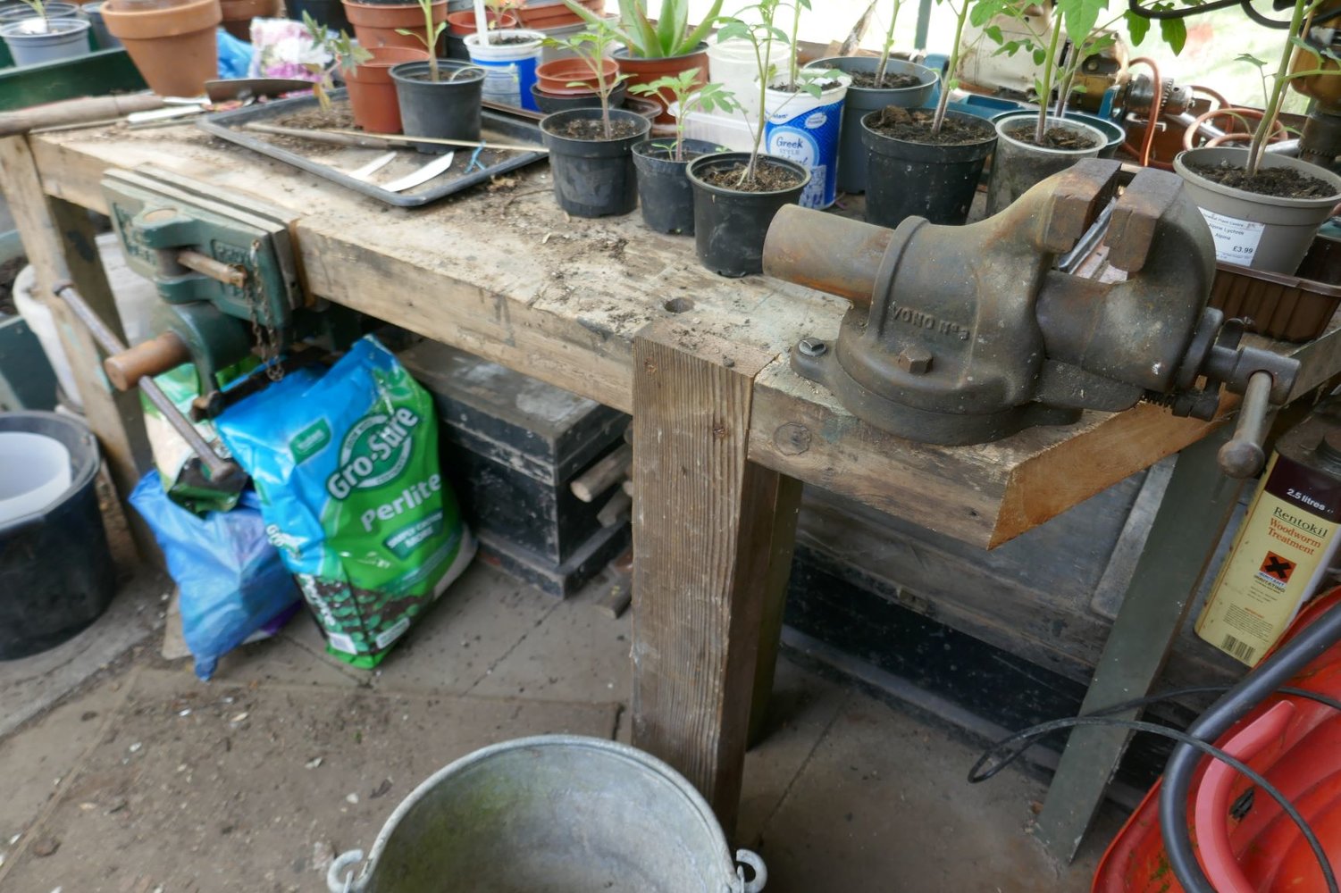

Those Vono's look brilliant (I am slightly biased thoughHow to find harmony in the greenhouse.
View attachment 345403View attachment 345404
These Vonos (10 1/2 WS woodwork swivel jaw QR, and no.3 swivel base QR bench top) had spent long enough outdoors and needed a home. Luckily we have a largish greenhouse, which already had a vice (fine, but plain Record 2) so one day when my wife was busy elsewhere I installed a 'potting bench extension' which to me is a 'Vono bench'. Any one need a plain 2 with a very fine service 'Record'?
Late autumn, after the tomatoes and grapes have been eaten and the greenhouse is back to its proper use as a workshop, I'll clean up these two, but they work fine for now
