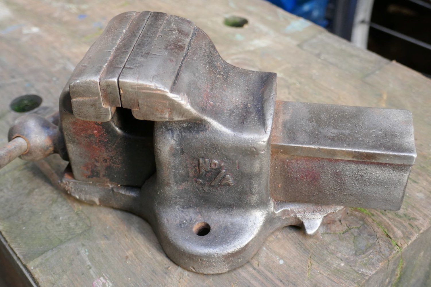

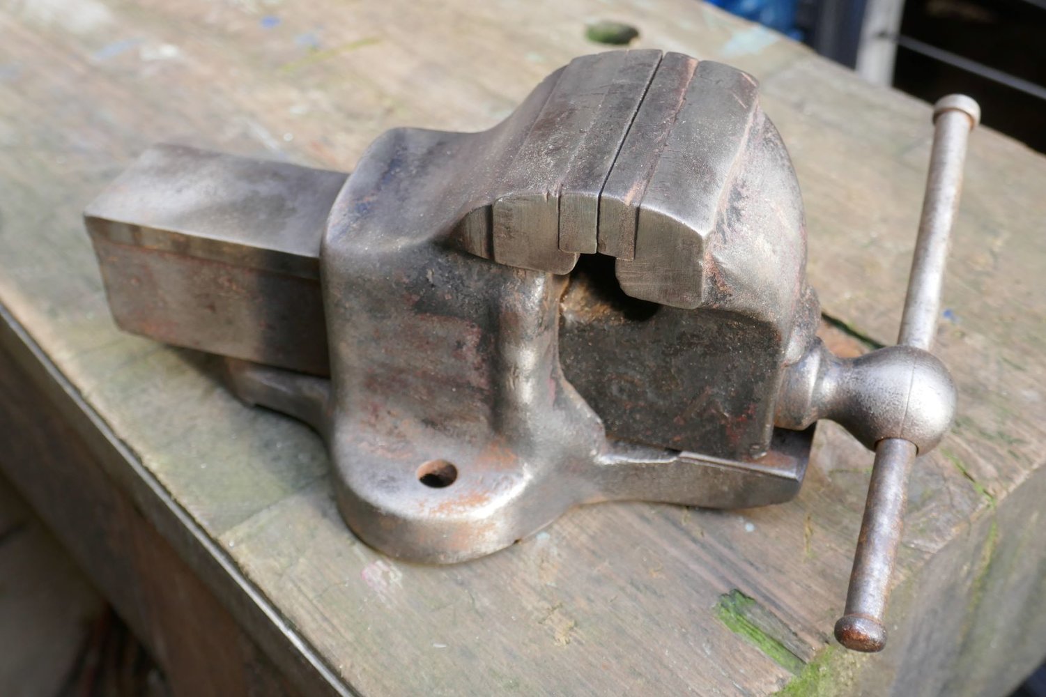

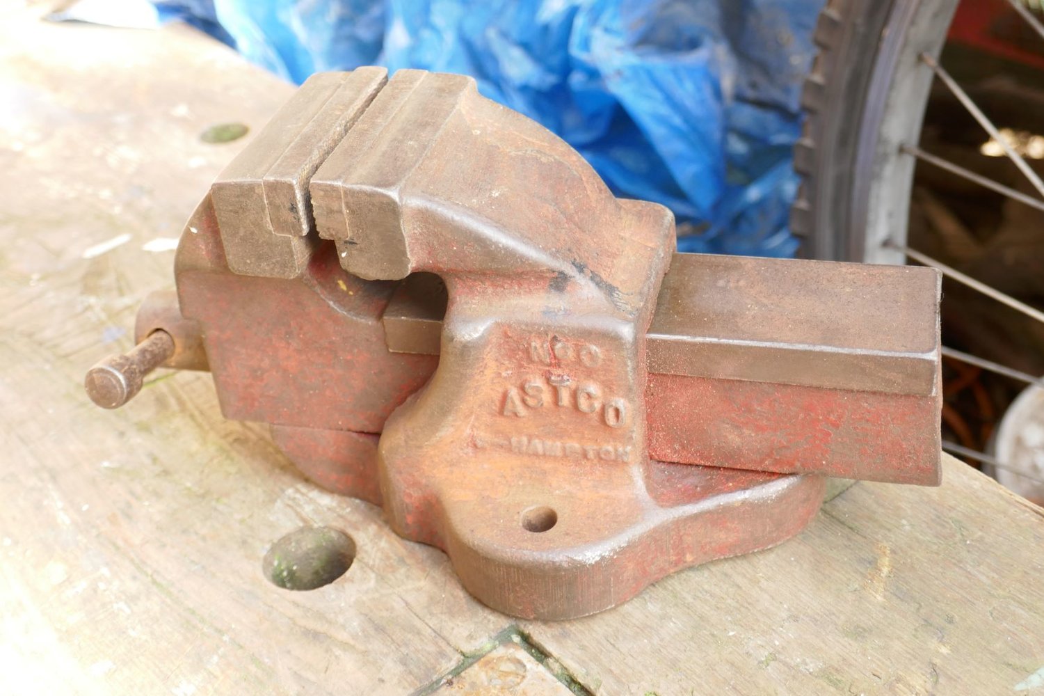

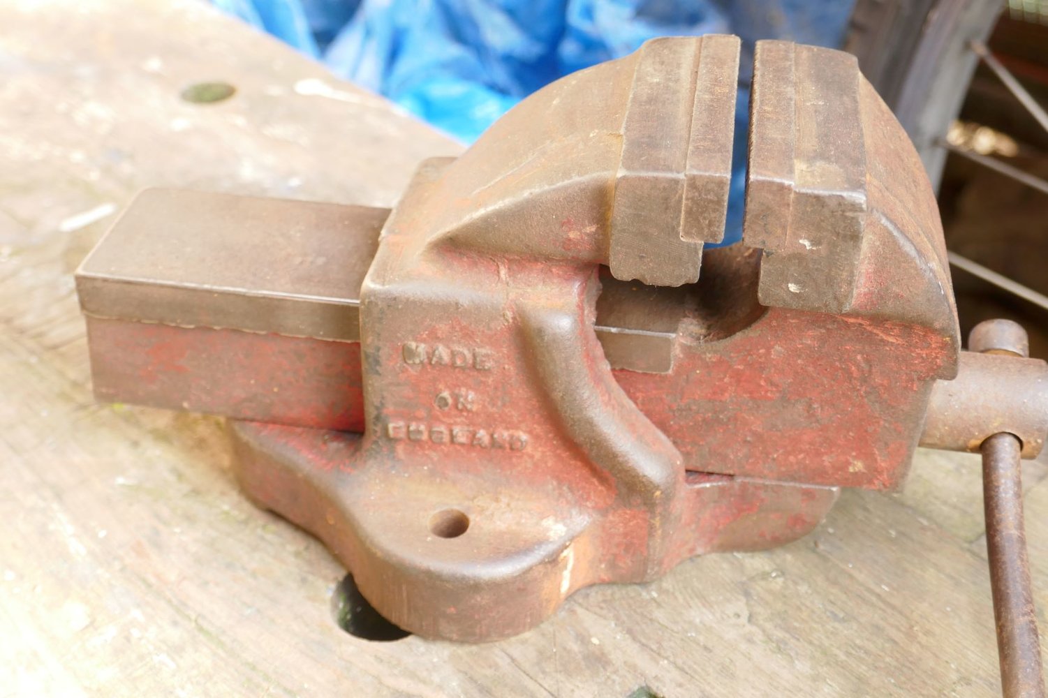

An Astco no 0, from W Hampton England - where's that?
New to me.
Look a lot like one of my record no2.A no name no 0 with ball-shape boss 2 1/2in, 7lb - unusual in these 0 or 00 after Parkinson's early versions with 3 main castings as pop to 2

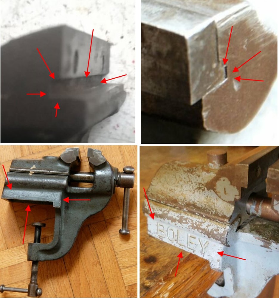

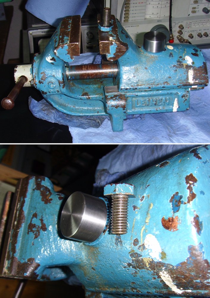

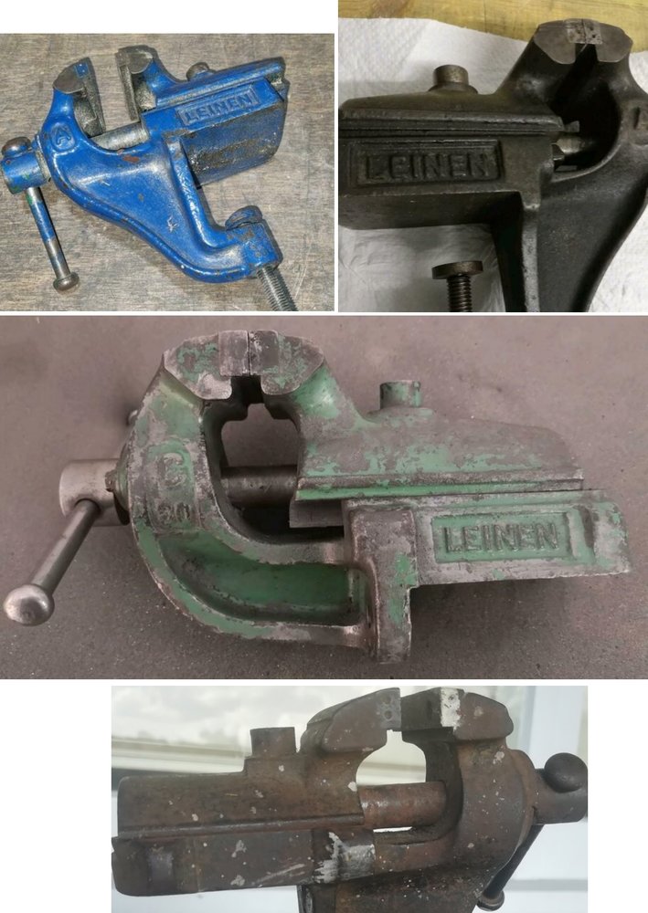

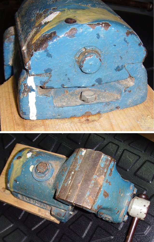

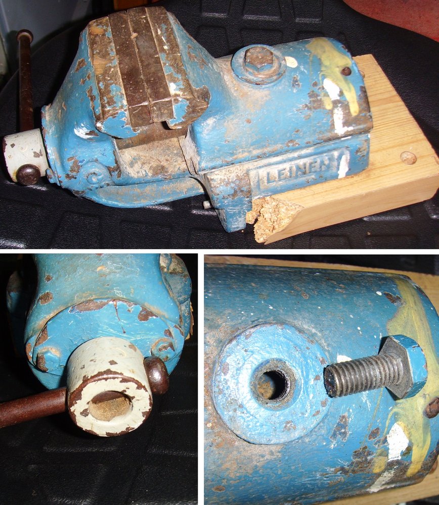

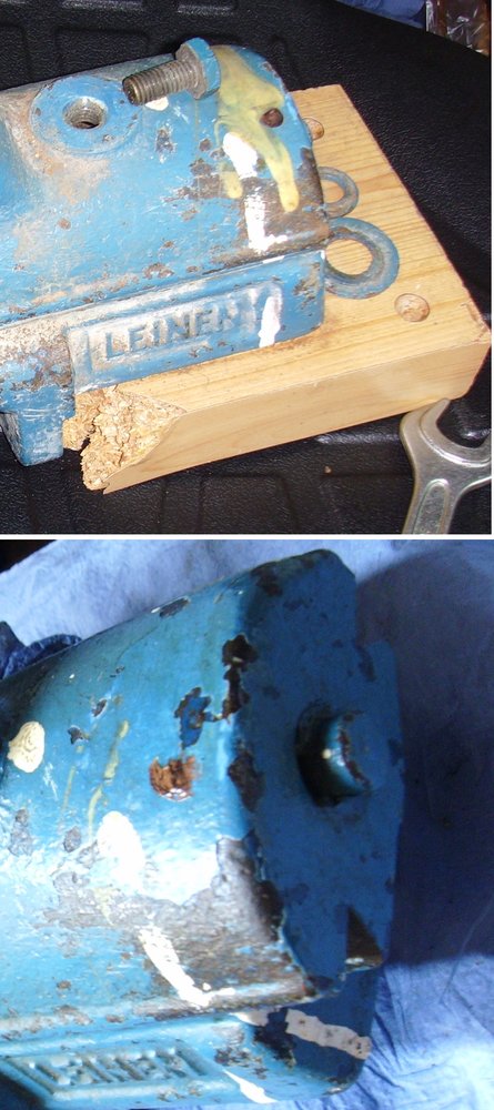

hi David,
The story of @ranger08 David's nifty little parallel vice to clamp begins with Gustav Adolf Boley (*1835, +1891), whereby it is irrelevant whether it is an original or a replica .... and what in this story may be called an original at all with justification remains to be seen ...
Gustav does a watchmaker apprenticeship in Stuttgart, goes to Ulm, later to Switzerland to St.Gallen and Zurich, finally to
La Chaux-de-fonds - THE watch capital par excellence, where he takes over a company for watchmaking accessories.
After a few years, he returns home, founds a company, first produces pocket watches, begins to sell tools for watchmakers and realizes that mechanical engineering is not yet developed enough to produce tools and machines according to his quality requirements - at that time, all this still came exclusively from French-speaking Switzerland.
He then took care of it ... and very successfully!
When he died in 1891, his widow successfully continued the flourishing business before finally in 1904 taking on her eldest son and a particularly capable employee as partners. His name: Josef Leinen.
Not long afterwards, Leinen founded his own company and took some of his developments and probably also patents with him, initially apparently on good terms with his previous partners and bosses.
I have gathered all this from various sources, the following section is heavily taken from Tony's fantastic site lathes.co.uk.
Among his own developments, which Josef Leinen successfully built and marketed, were in particular his parallel vises, which in all their properties outshone what had been available up to that time.
One day, to his horror and immeasurable disappointment, he discovered that the G. Boley company, to which he had been so loyally attached for so long, was also building and selling his development under their own name.
It is not exactly handed down what was done or omitted in the following settlement attempts, if there were any at all, but it is known that he looked for, found and persuaded an impoverished widow to act as a partner in his company, Boley was her name and he changed the name of his company to Boley & Leinen!
The man was obviously pretty ****** off ...
So there are very similar vises of the name Leinen, of the name Boley and those that look exactly the same but have no name - it gets quite confusing after a while of dealing with the subject ....
.... and to make the confusion complete, there is still today a company Gebrüder Boley (like Boley brothers) in the same area, completely independent of the whole previous story, which exclusively supplies companies with tools, equipment and machines for watch and jewellery making and repair - with whom I am also a customer - and they still supply, among other things, vises of the Leinen brand.
I focused exclusively on the small ones with the button anvil.
These seem to have existed as A, B and C, with jaw dimensions of 50, 60 and 80mm, often referred to as a watchmaker's vice.
The features that apply more to Boleys and suspected Boleys are the groove in the jaw mount, the sloping shirt in the back and a rather improvised or missing name mark.
The small vices of Leinen often have marks at the end of the jaws, the jaws sometimes (little used? factry option?) form a small roof together instead of a surface, the groove is missing, the name is very succinctly placed in its own field, virtually framed by columns, often the model is mentioned, sometimes the jaw width in mm.
The specimen of Leinen are - across all sizes - currently much more common to get second-hand in our country, Boleys are offered much less and somewhat more expensive.
David's specimen seen in the first and the last partial picture now bears characteristics of both companies and again also differs.

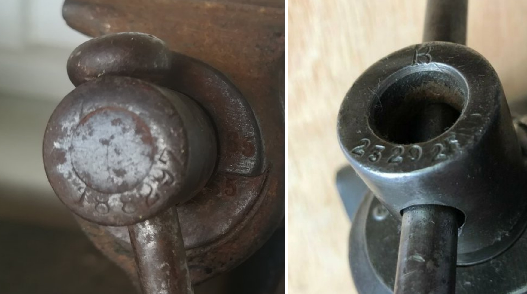

It should be quite old, but whether we can let him have the 1882, I don't know - I found this mark on the meatball here on a Leinen:
And here is my Leinen C80, which I had sent to me exclusively for research purposes:
First, of course, the nasty chipboard had to be thrown in the bin,
then I had to deal with the disgusting yellowish stuff that had run down the back of the poor thing.
The yellow stuff came off quite well, the whole vice lost quite a bit of weight during the initial cleaning and got it back again, because it didn't work at all with such a hexagon head screw instead of an anvil.
This one got a little bigger than the original, I wanted it to be inviting to use.
Then I might have discovered a piece of the original paintwork and a casting mark that I wasn't able to decipher.
Let's see what else can be found out....
Carsten
So mine could be a boley copy of a Leinen? I hope I think?, or were there other companies ripping them both offHi all,

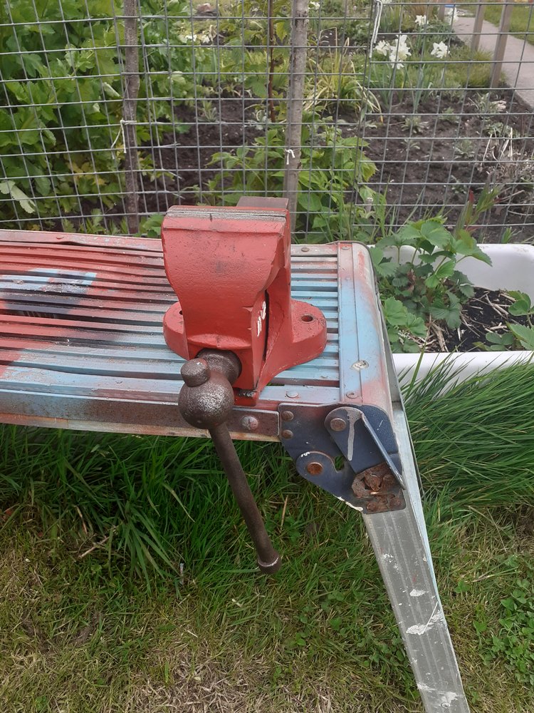

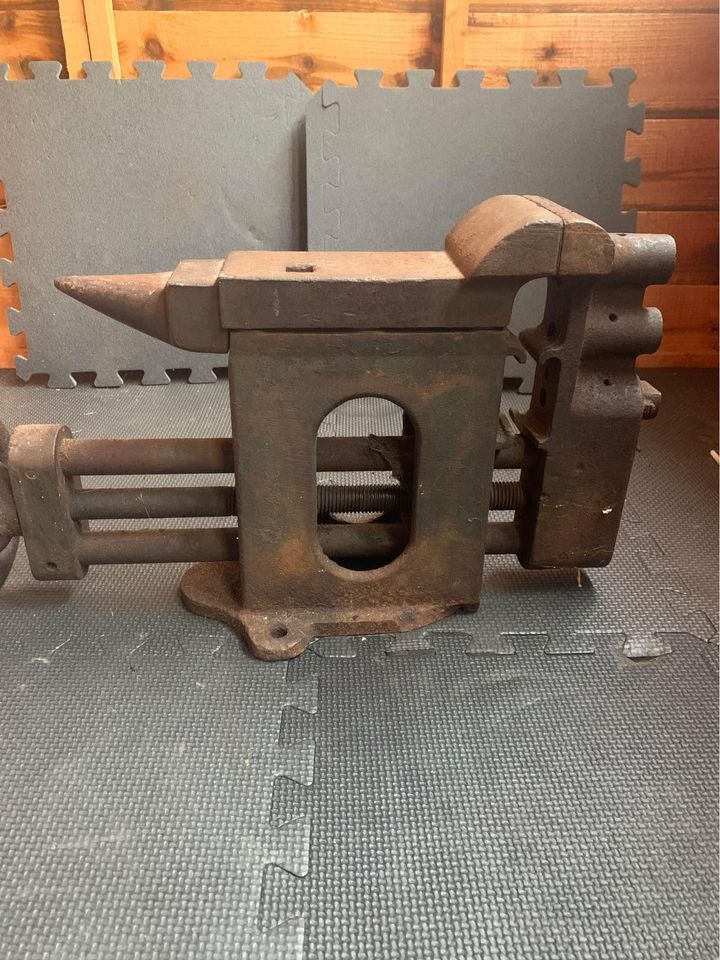

An interesting vice on FB. Mounted on a ball and cup base. £25 from Southampton area.
