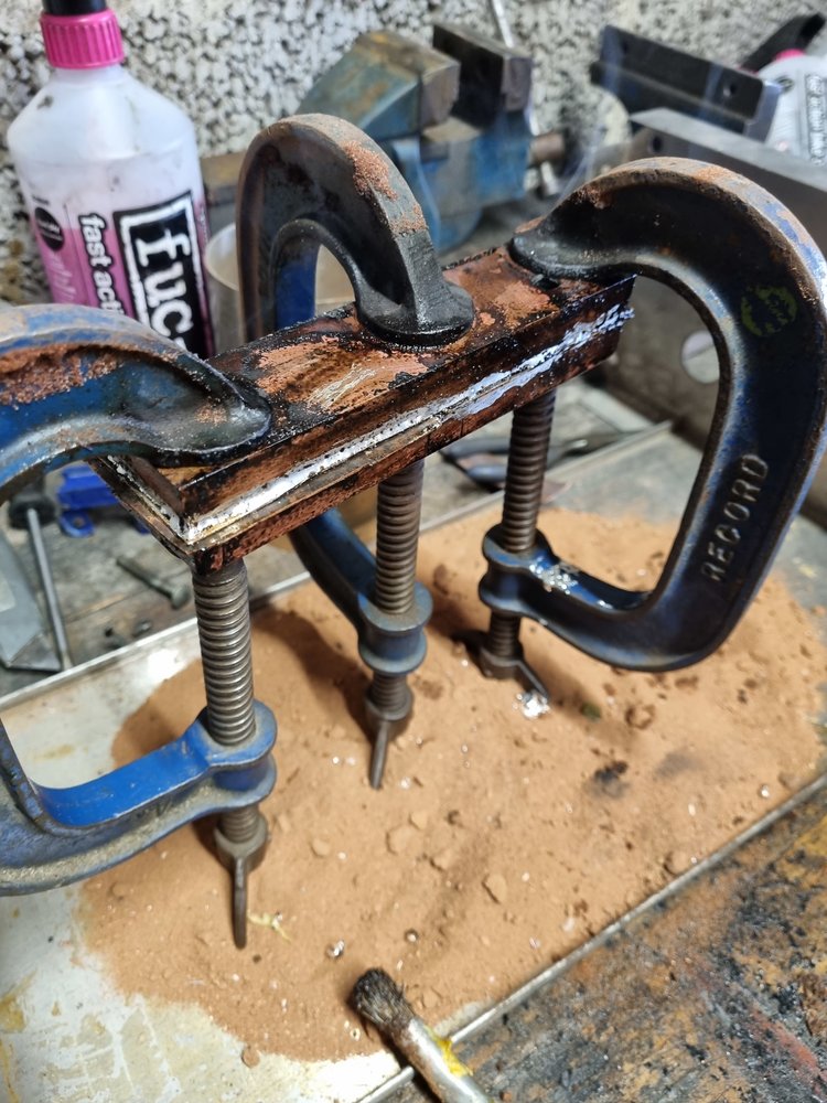

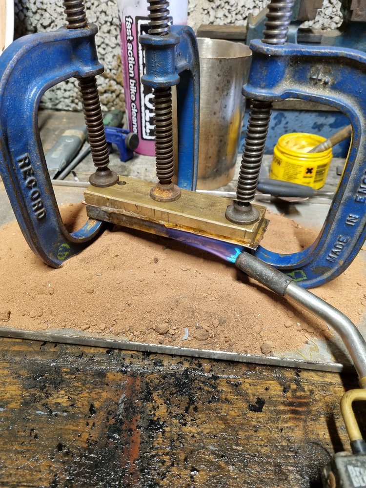

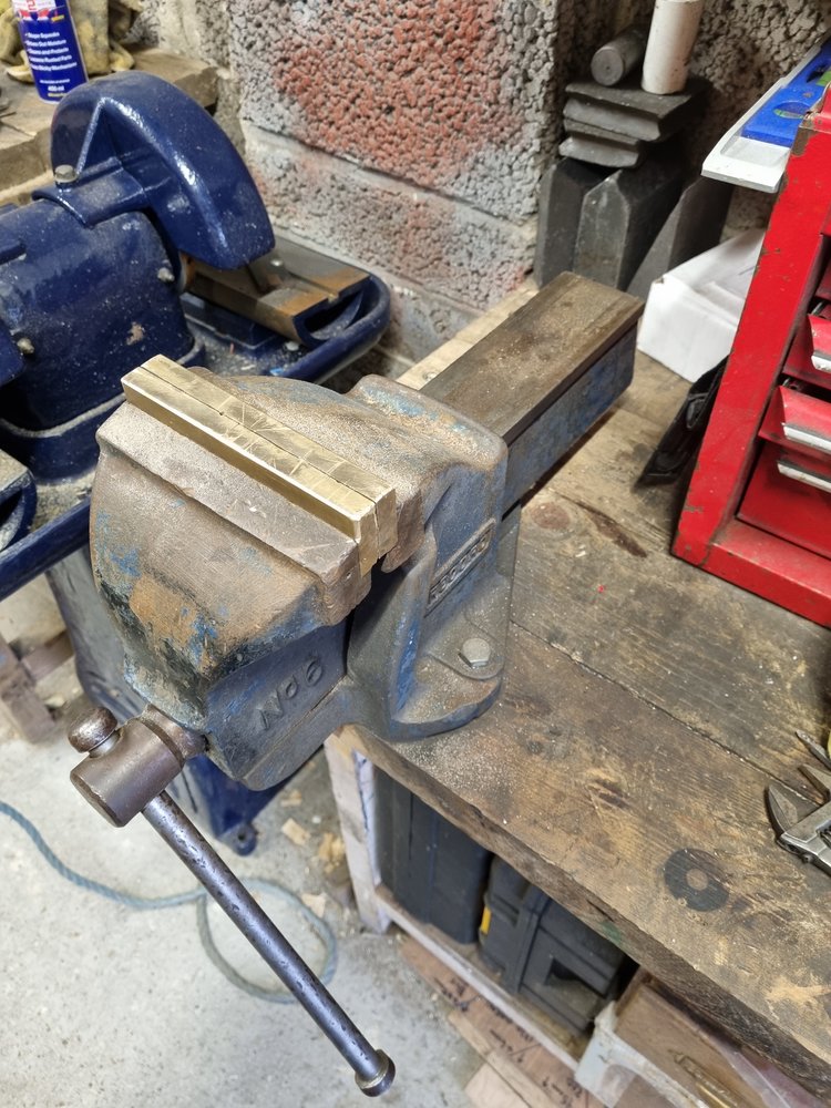

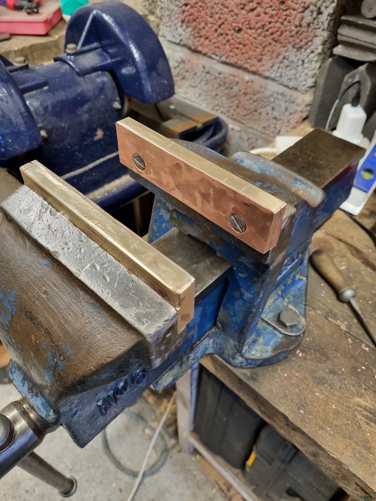

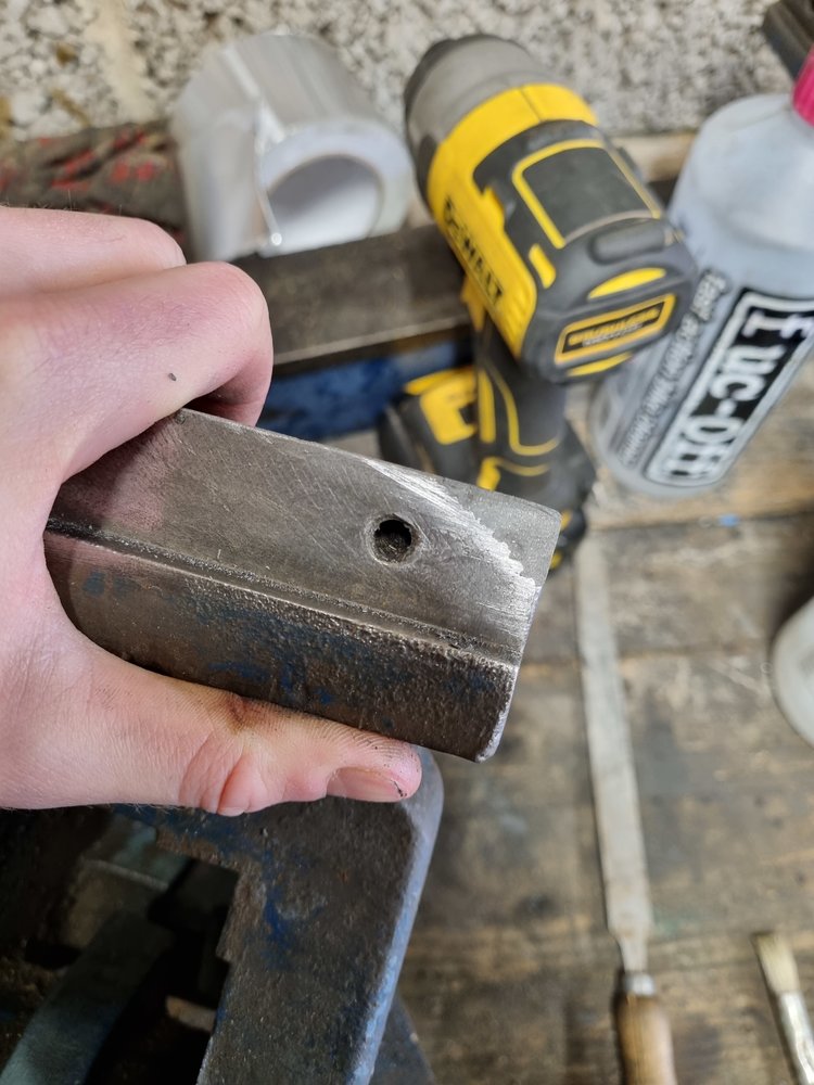

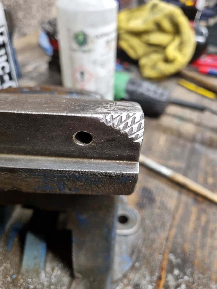

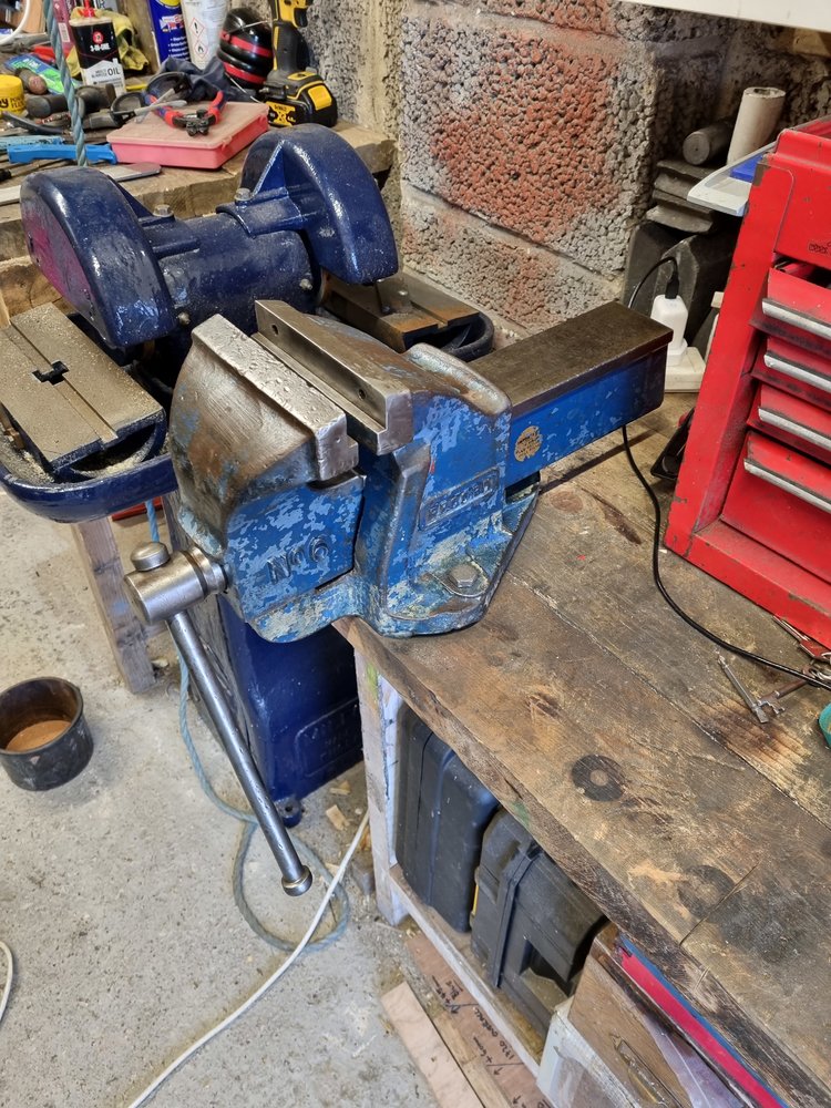

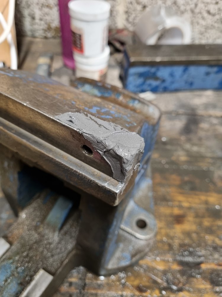

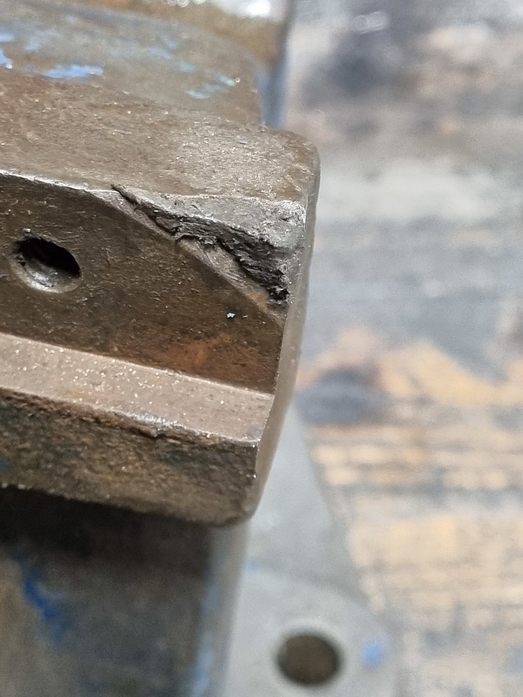

Jaw inserts weren't fitted in the last post because they were still cooling...I've been giving my Record No.6 some love, the moving jaw sticks closed then jumps on the spring. I've had it getting on for ten years so maybe overdue a clean.
I cracked the corner behind the jaw insert ages ago, I filled it with Tigerseal which was still stuck very well but I can do it properly now. Gave it a good key, covered it with metal filled epoxy, and filed it back flush.
Looks pretty good I think. The painted bits were scrubbed with Muc-off, I'd quite like to get rid of all that silver-blue but I don't want to damage the original blue underneath, plus I can't be bothered. If anyone asks I'll say it's Arctic camo.

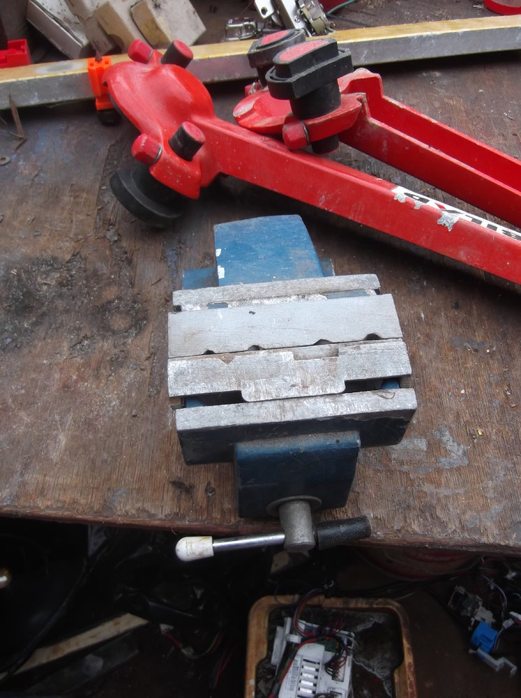

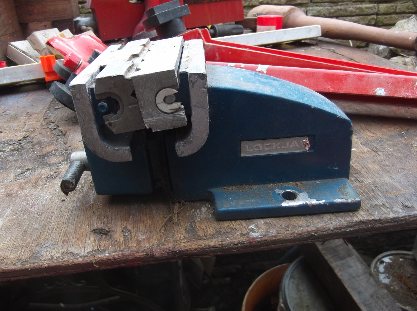

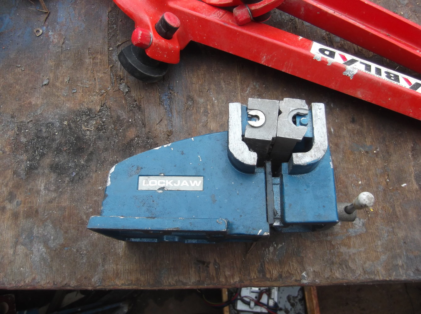

Last weekj end I was donnated a large amount of workshop stuff.
Today I had to sort sorting the good from the bad.
But in one of the box's was thus nice odd vice. When I can I will be googlin the information on it.
In the mean time here she is.
