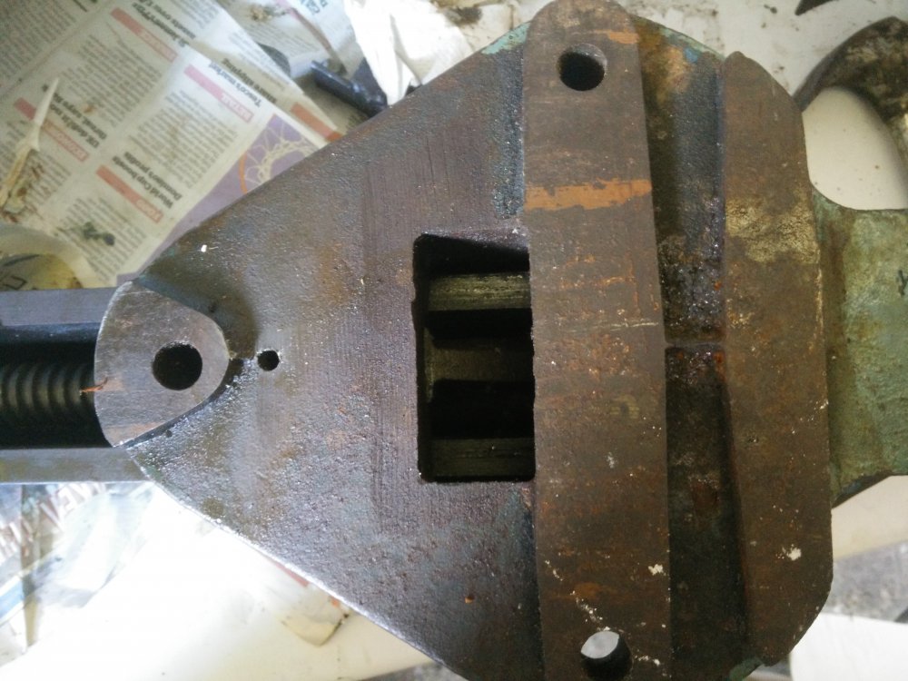

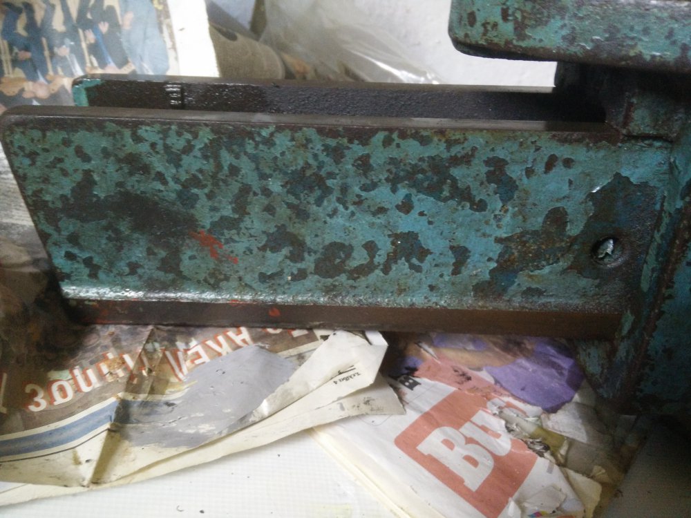

I recently took the same vice apart, this is caused by the nut being loose so when you turn the handle, the nut moves over before the jaw moves. With it upside down, the nut can be seen through the rectangular hole, if you wind the handle, you'll see the nut move, then the jaw will move.
