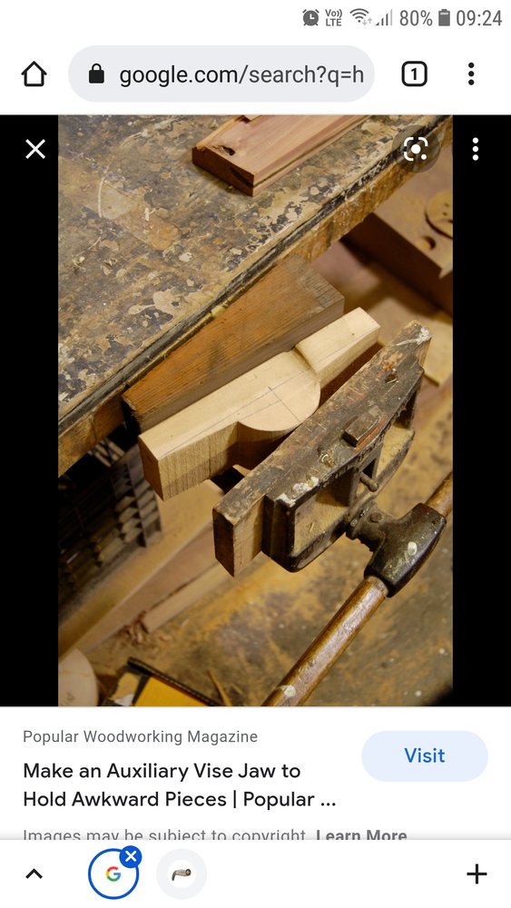

You could cut a piece of round bar in half ( length wise ) and weld it onto the back of your new jaw to simplify fettling...................................................I want to make a wobble jaw type thing to allow holding triangular pieces in a vice. Like this, but not wood.
........................... I'll have to cut and shape it by hand as I have no mill!
