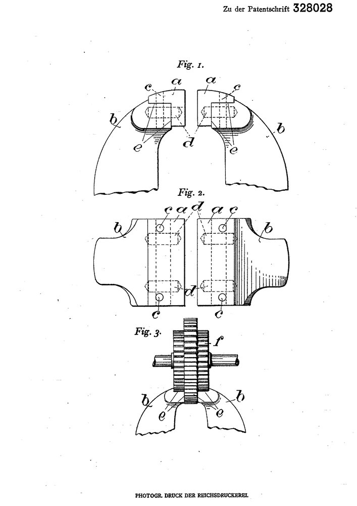

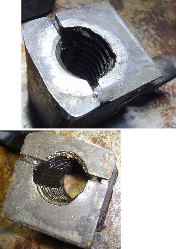

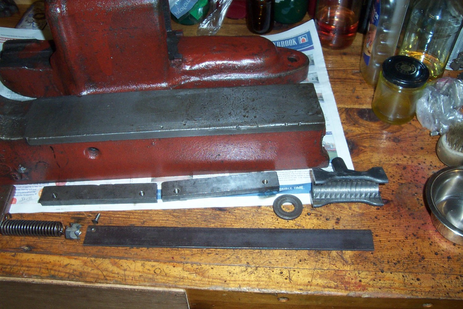

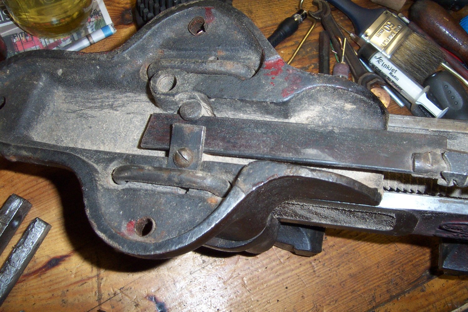

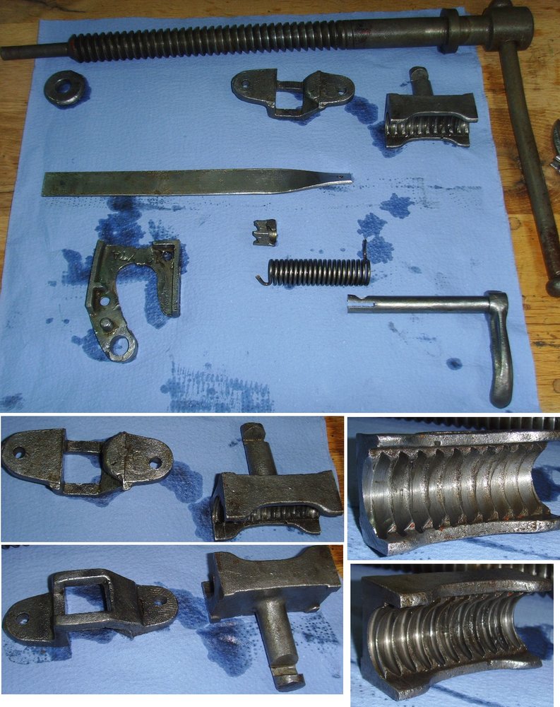

Does anyone perhaps have a drawing or something similar for me, from which the difference between only a half nut and the two-piece nut of the Parkinson specific solution becomes clear?!?? Many thanks in advance!

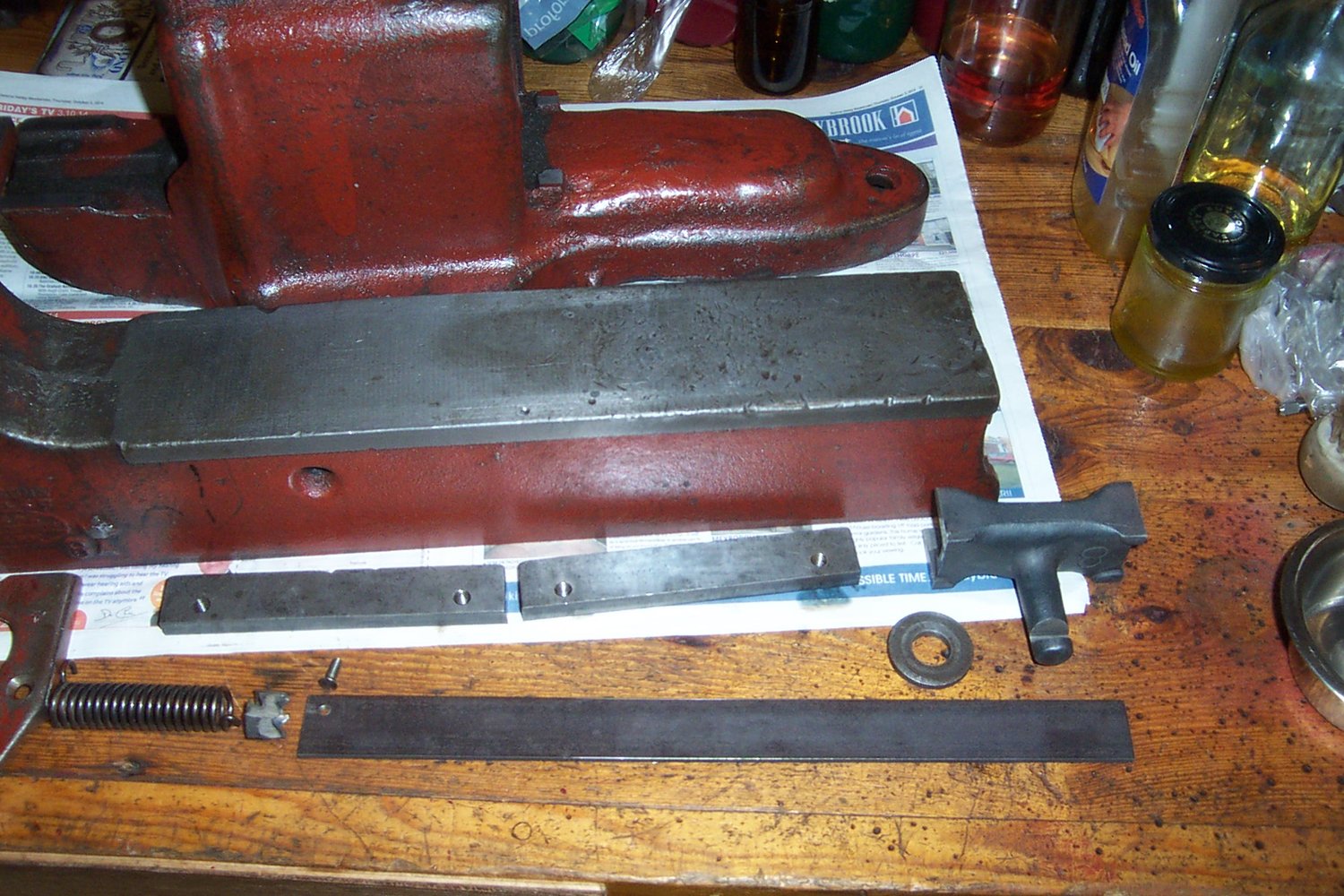

You can also see the adjuster nut. That's nothing hard to make. Just a sawtooth profile so that the flat bar will rise on the angled face, & latch/press against the flat face. It has a notch in the other face for the spring hook to locate into. Nothing you can't readily recreate with a saw & a file.

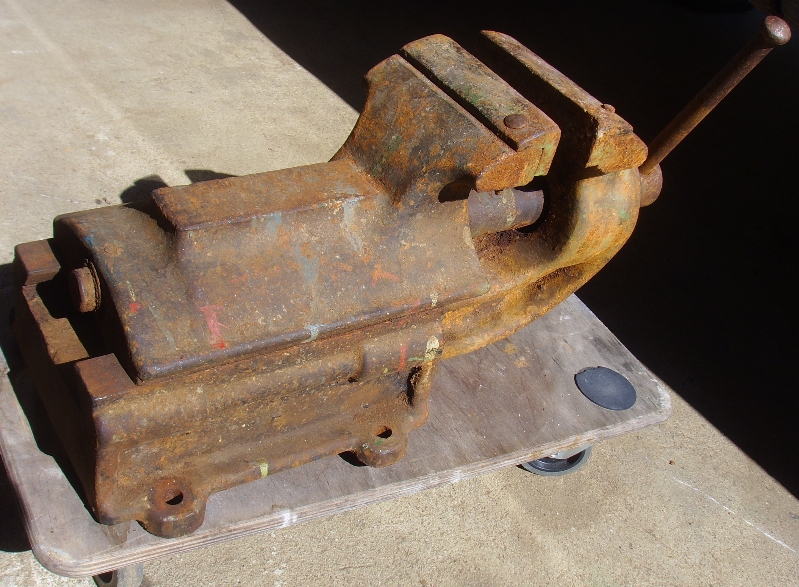

Metric or Imperial, which to work in? When I was about 10 and at primary school we had our foot rulers taken away and we were given 30cm replacements and told that we'd never need to use feet and inches again!. As an apprentice everything was metric, day release courses measured in SI units and so it continued until after two years at the Dockyard school we went to on the job training where everything was still Imperial. I don't think I used a metric nut and bold until 1982 on the Invincible class carriers, certainly micrometers and gauges were all imperial up until I left in 88.I agree 25.4's vice has characteristics of the pre WWI Parkinson's, but never seen one quite like that, with a more 'modern' look to it. Looks well made.
Is there any sign of markings being filed off?
What width the jaws?
Of course, as well as Russian, Italian, Belgian and Polish makers, there were quality vices from Czech and an inventive Turkish vice maker, which sometimes had a look like this and their own patent quick release. Most of these marked their names.

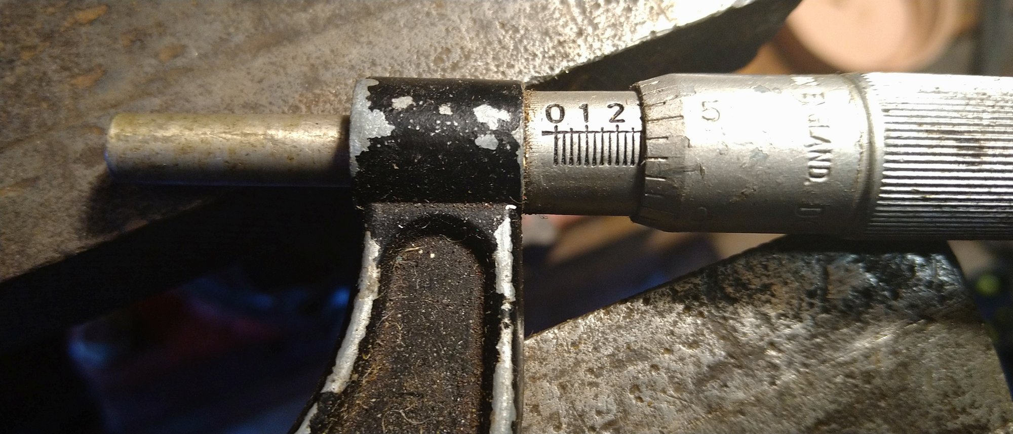

But that's what I'm particularly interested in now: How does a micrometer screw work in imperial units? In steps of 12 or in steps of 16 and doesn't it go down in decimal steps at some point?

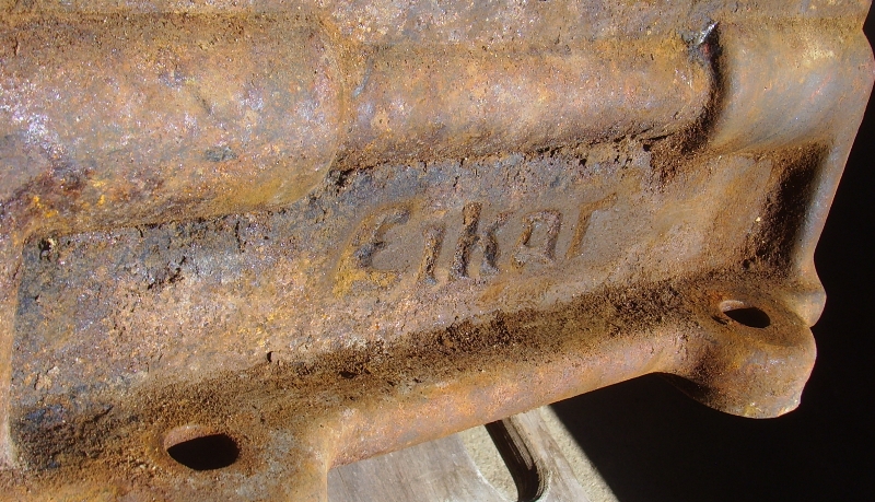

I am currently restoring a 43kg, 6" Eikar from between 1920 (patent) and about 1944 (the Soviets are on the doorstep).

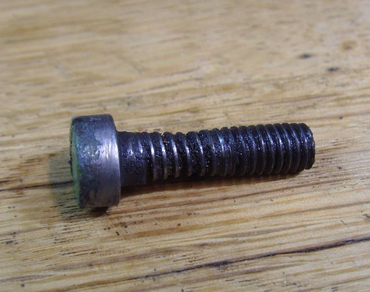

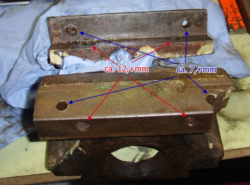

The 5/16" dowel pins (c) and 1/2" holding pieces (d), which were essential for the patent, were apparently made imperially by the German manufacturer Breitenfeld&Scholz ...
What I measure on the parts only allows this conclusion:

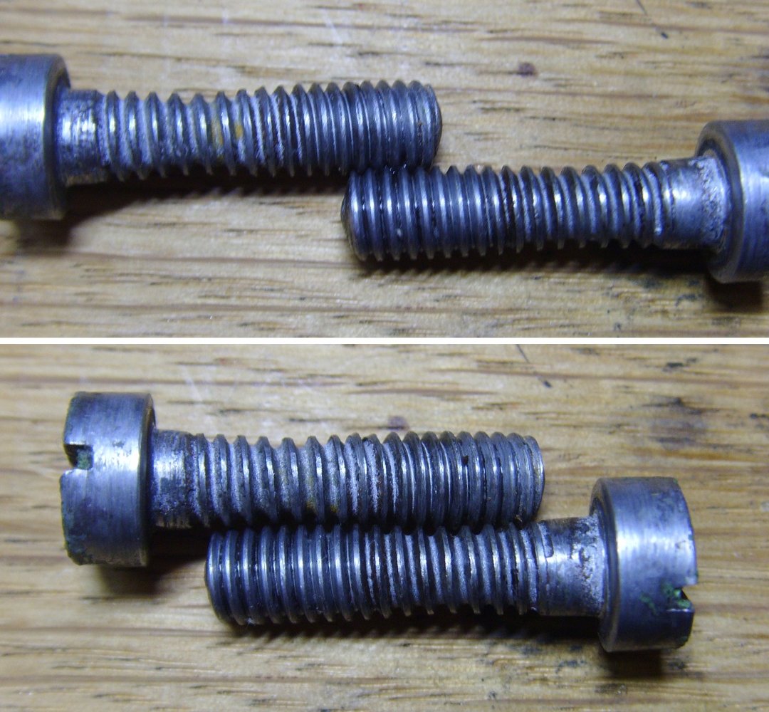

I continue to wonder, however, what the measurements on my perhaps-Parkinson patient mean, for they make no sense either metrically or imperially:
Clamping jaws 156.x_mm or 6⅛" and a bit, fastening nuts of the cover ⅞" wrench size and its thread not yet identified ...
Any suggestion is welcome!

Thank you.The jaws are always a fraction oversize. They're never exactly 4", 6" etc.
That's what I've resolved to do today, go out now and report back later.Threads should be BSW.

Good, so I have a generous 6-incher then.
puuuh, that was a bit shady outside and in the barn, clear sky, the moon very bright and close, that could give the first ground frost this night ...Thank you very much for your diligence, Steve.The large divisions on an imperial mic are in 1/10 of an inch, each is subdivided in to 4 parts, so each smaller division is 1/40 of an inch. The barrel is marked 0-25 and each revolution of the barrel move it 1/40 of an inch so each small division on the barrel is 1/1000 of an inch.
Not bad, nice punch line, Matt.Ironically, after I said they're usually oversize, just checked my 8A out of curiosity, & it's about an ⅛" under 6".

It's not that easy with the Parkinson suspect.
