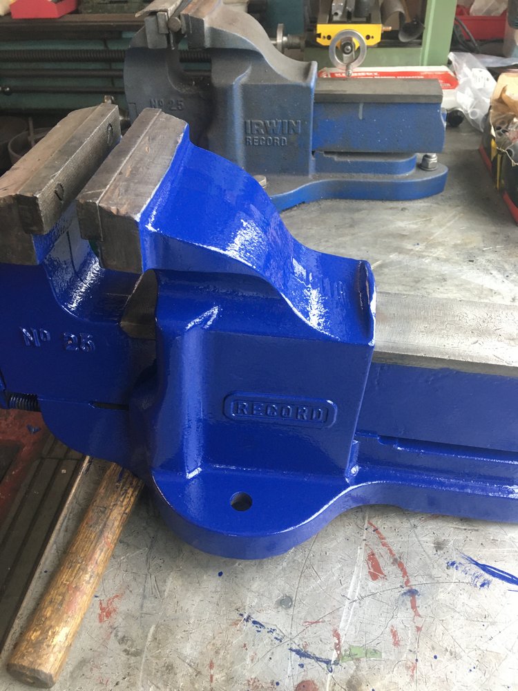

The quality of the casting and finishing is much better on the old one. In use they are pretty much identical, although I haven’t abused either of them!Very nice!
as you have original and new Is there any difference in strength or quality?

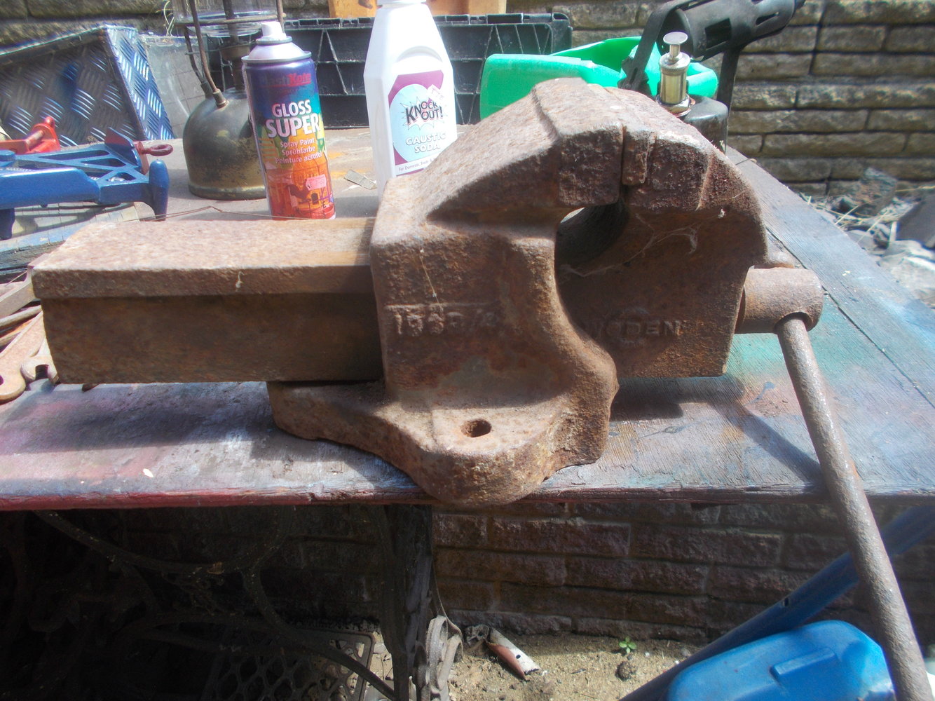

I have finally stripped the vice down but have 1 broken bolt in the vice plate, can someone tell me the bolt size and thread and what type of drill and tap to use, will a b&q drill do the job or do l need a better quality one any tips will be welcome, thanks lads.I have been given an old samsonia perfect vise that is rusted up and seized solid. l have been looking through utube for info. how to free it when l found a link to this website and l was really surprised to find so many people renovating old vices. I have come to the conclusion that I could never make anything of it I have no engineering skills at all, I was a truck driver all my life so only basic mechanics and stuff learned at school. If anyone wants this vice let me know through this web page. I live in Worcestershire. The lettering on it says no. 38A model j samsonia perfect vise.
That's hard question to answer. The quality of B&Qs drills, or so I've discovered, is variable, even from the same set. Some will cut iron/steal without problem while others will merely spin and snap. As to for a tapping drill without knowing what the size is it is difficult to say, I'd have to get my Zeus book out.I have finally stripped the vice down but have 1 broken bolt in the vice plate, can someone tell me the bolt size and thread and what type of drill and tap to use, will a b&q drill do the job or do l need a better quality one any tips will be welcome, thanks lads.
More than not it will be UNC..I have finally stripped the vice down but have 1 broken bolt in the vice plate, can someone tell me the bolt size and thread and what type of drill and tap to use, will a b&q drill do the job or do l need a better quality one any tips will be welcome, thanks lads.
I have got a bolt to fit the plates and it has got unc on the head but its the diameter of the actual bolt hole that I need so l can get the relevant drill and tap, but that website will be useful.You might find this link useful, if you don't have a Zeus book. https://www.coastalfasteners.co.nz/tapping-drill-sizes
Easy enough. Measure the diameter of the bolt, easiest done by measuring the unthreaded shank, let's say it's half an inch. Looking at the table shoes that you'll need an 11mm drill.I have got a bolt to fit the plates and it has got unc on the head but its the diameter of the actual bolt hole that I need so l can get the relevant drill and tap, but that website will be useful.

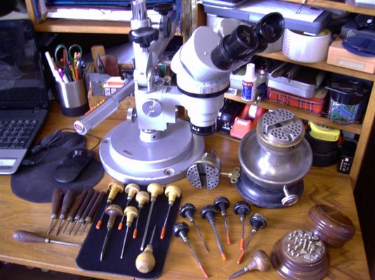

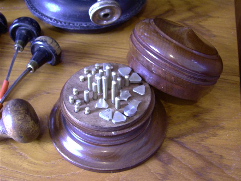

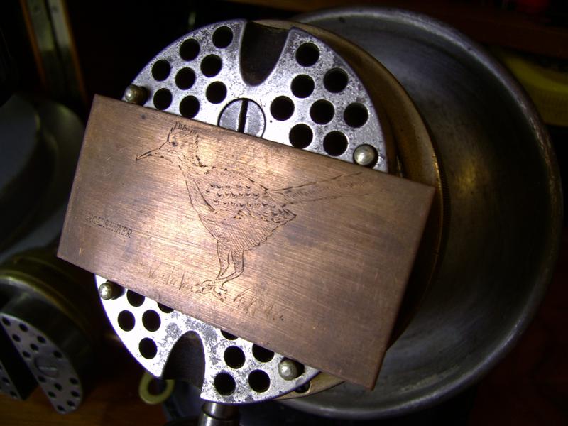

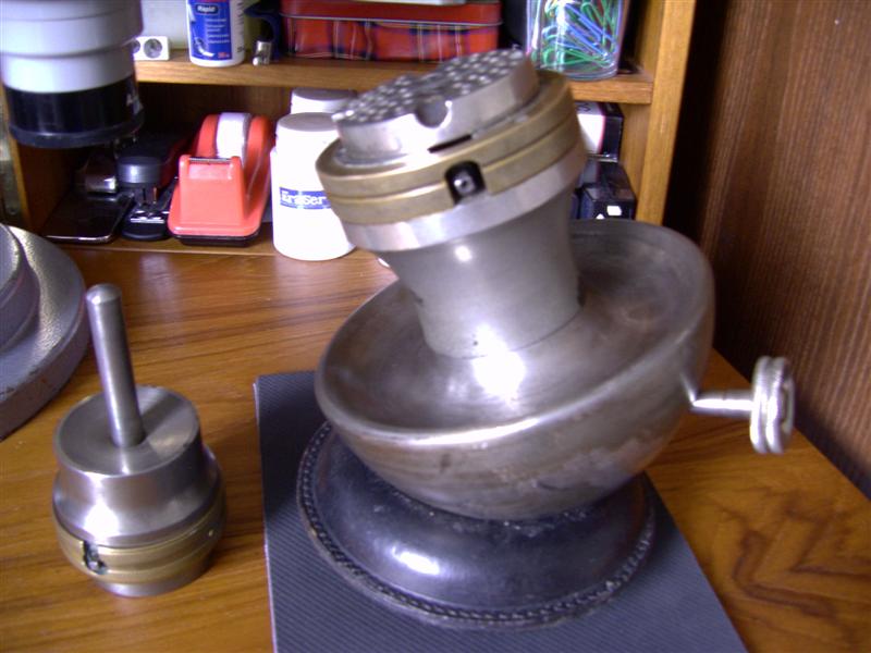

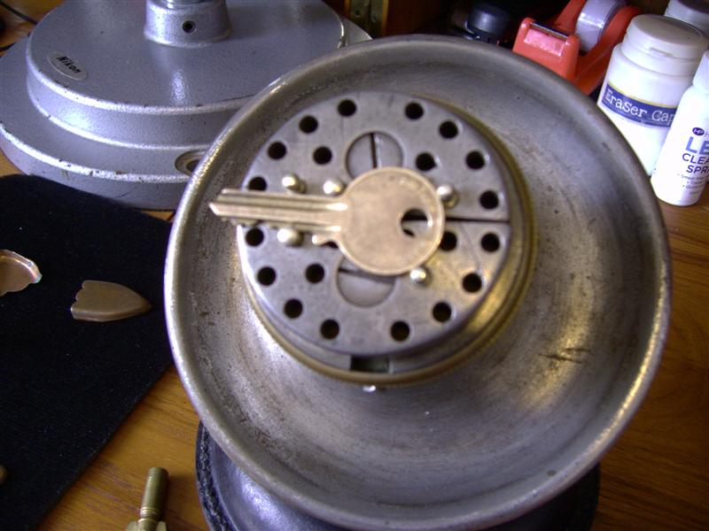

The fractal vise proposed might be good for some intricate engraving work but would be too small for most engineering work. A set of pins for engraving type vices cover just about everything your likely to encounter.
View attachment 298123 View attachment 298124
Apart from the eye bins, that almost could of been lifted from a old Jewellers my dad and I would visit.
