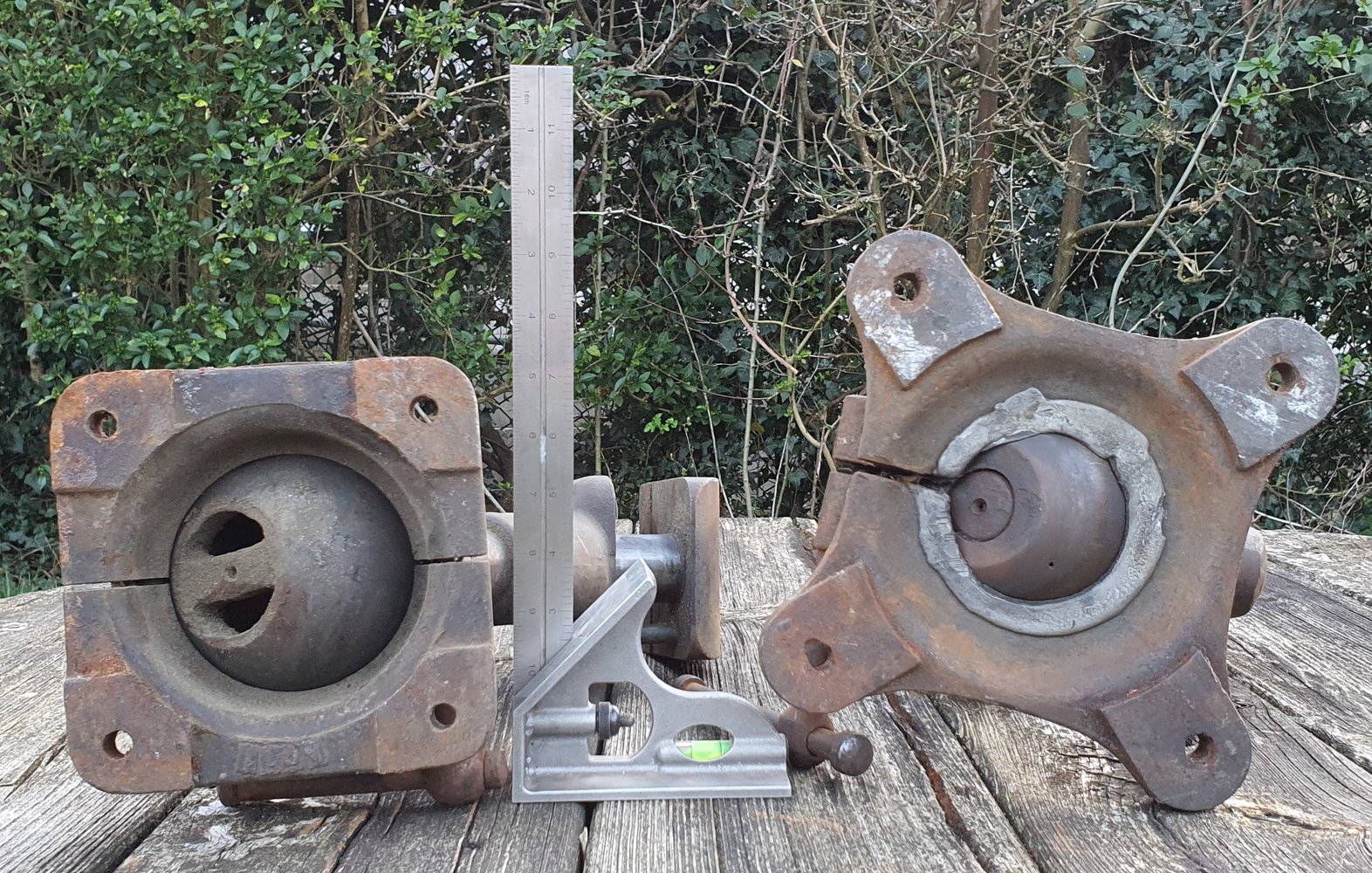

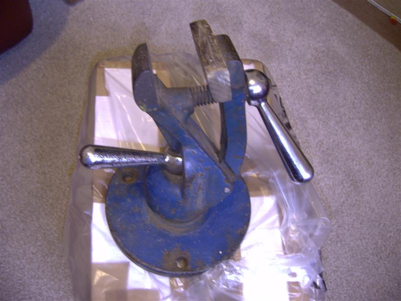

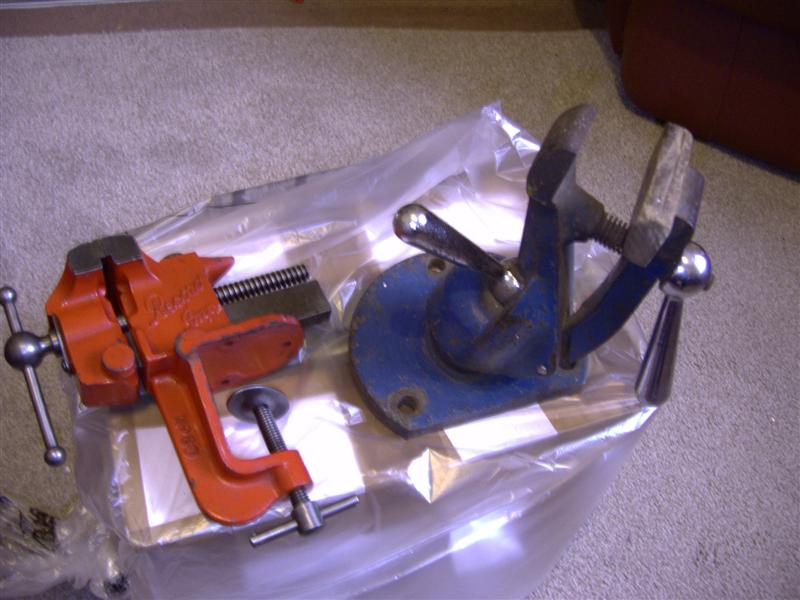

I acquired this ball mounted vice not long ago, and haven't been able to find out who made it or what it was used for; anyone here have a clue ?
One of the wood jaws are missing.

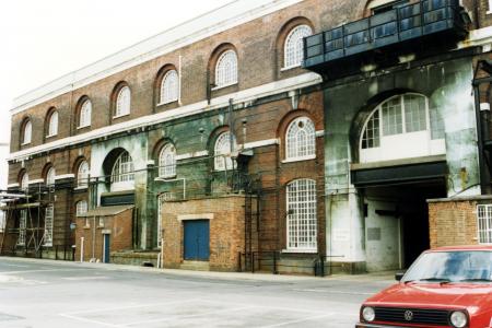

The only one similar was in the rope walk in Portsmouth dockyard.I acquired this ball mounted vice not long ago, and haven't been able to find out who made it or what it was used for; anyone here have a clue ?
Saw setting vice are not normally adjustable and have wider longer jaws to clamp the blade.Could be a purpose designed knife vice, certainly would be a very useful item for that. Chances are though it’s more like a saw setting vice.
Interesting, didn't think about it possibly being wall mounted.The only one similar was in the rope walk in Portsmouth dockyard.
It was wall mounted, the round base was on the wall and the jaws were just above waist height.
The told me it was for clamping the flat clamps in as they cleaned the hole.
But did not demonstrate.
I've got my Dads saw sharpening vice and related tools. The vice above has approximately 2" jaws, and the depth wouldn't allow for sharpen anything larger than the old and tiny "Gentlemen's" saws even with extended width jaws.Saw setting vice are not normally adjustable and have wider longer jaws to clamp the blade.

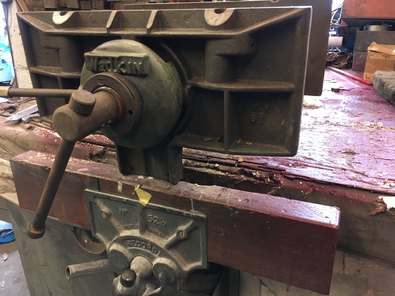

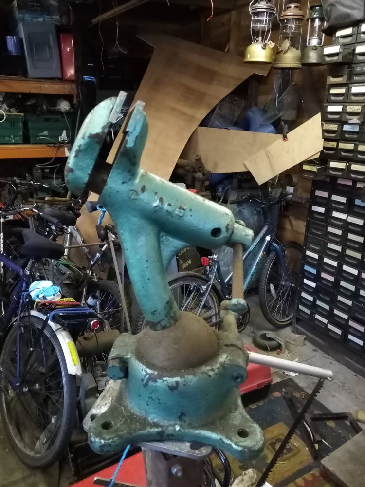

I'm new here but herd a rumour of a wadkin vice so came to investigate. Heres my recently aquired vice. A wadkin pattern makers vice. It came out of the dockyards at portsmouth.

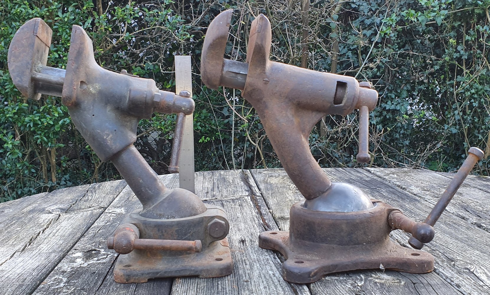

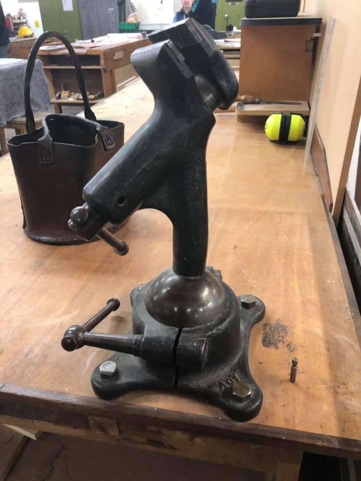

Just in case any of these are interesting to you.View attachment 290607
Had this years great multi angle adjustment and solid lock up. No idea what specific trade it was used in but a handy tool non the less.
