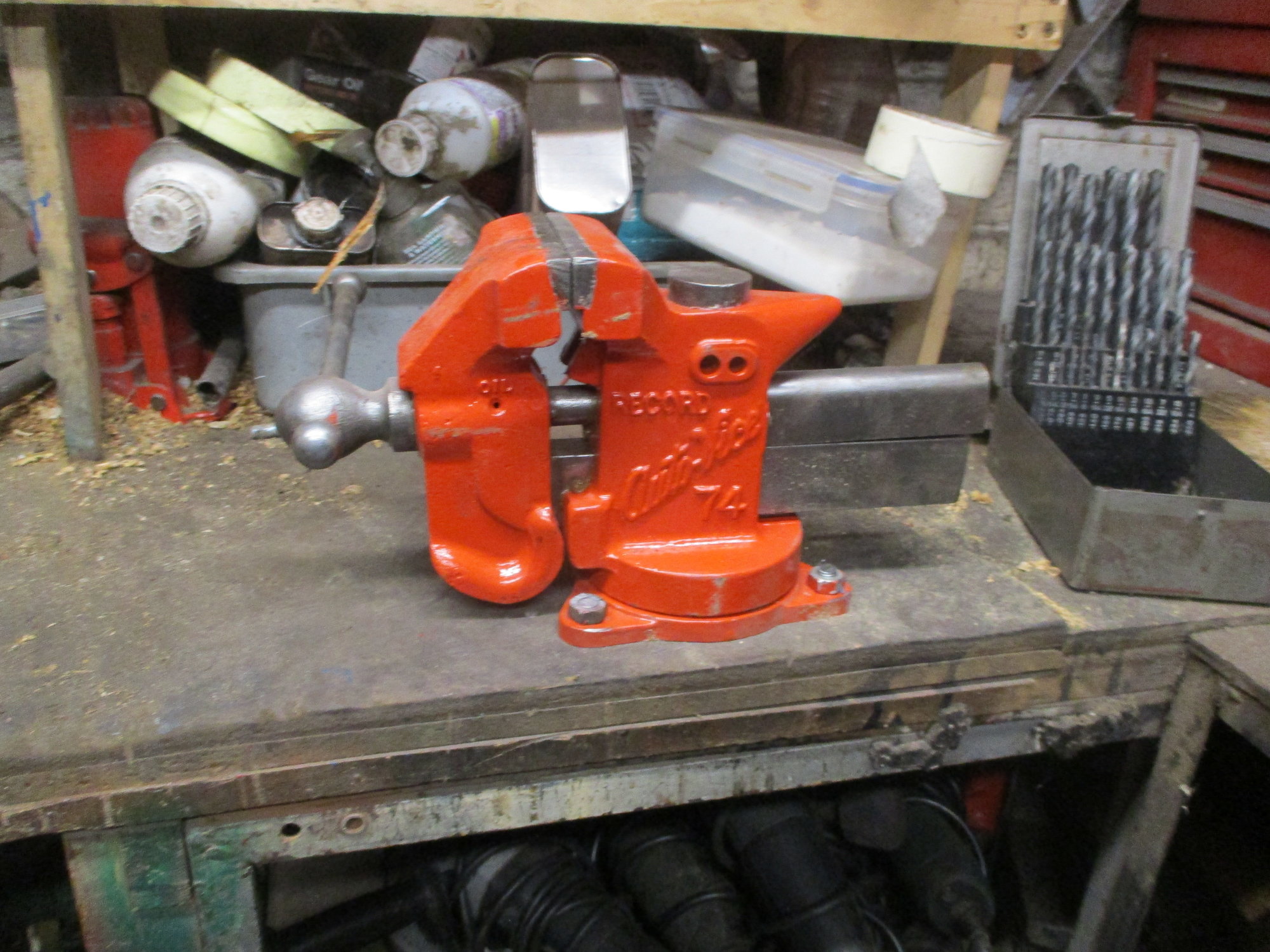

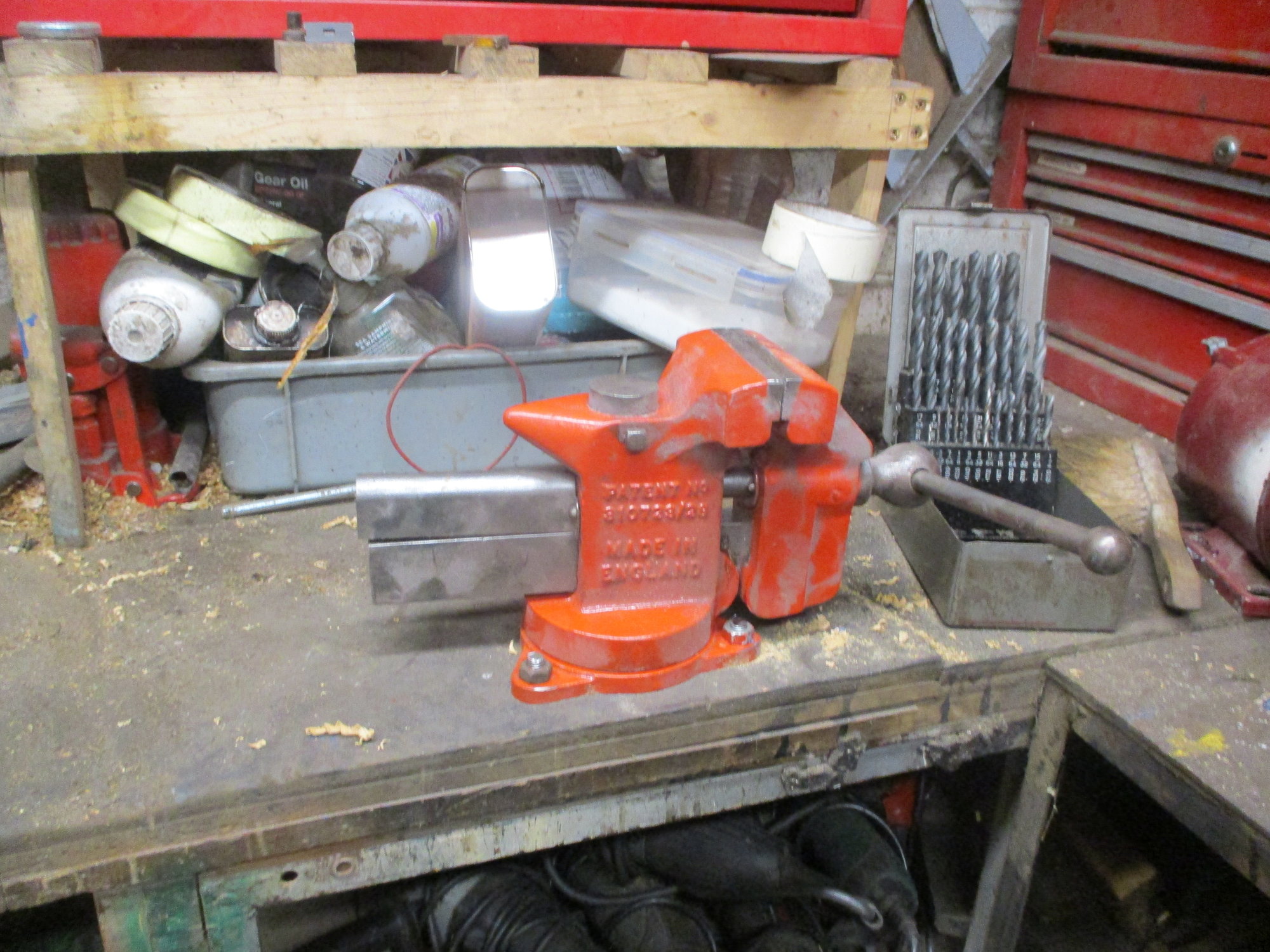

At last, got round to fitting my Record 74 to a bench.
Only been a few years.

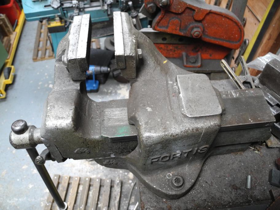

Fortis - range of colours over the years, I have a late model Fortis that looks to have original paint and it's yellow.

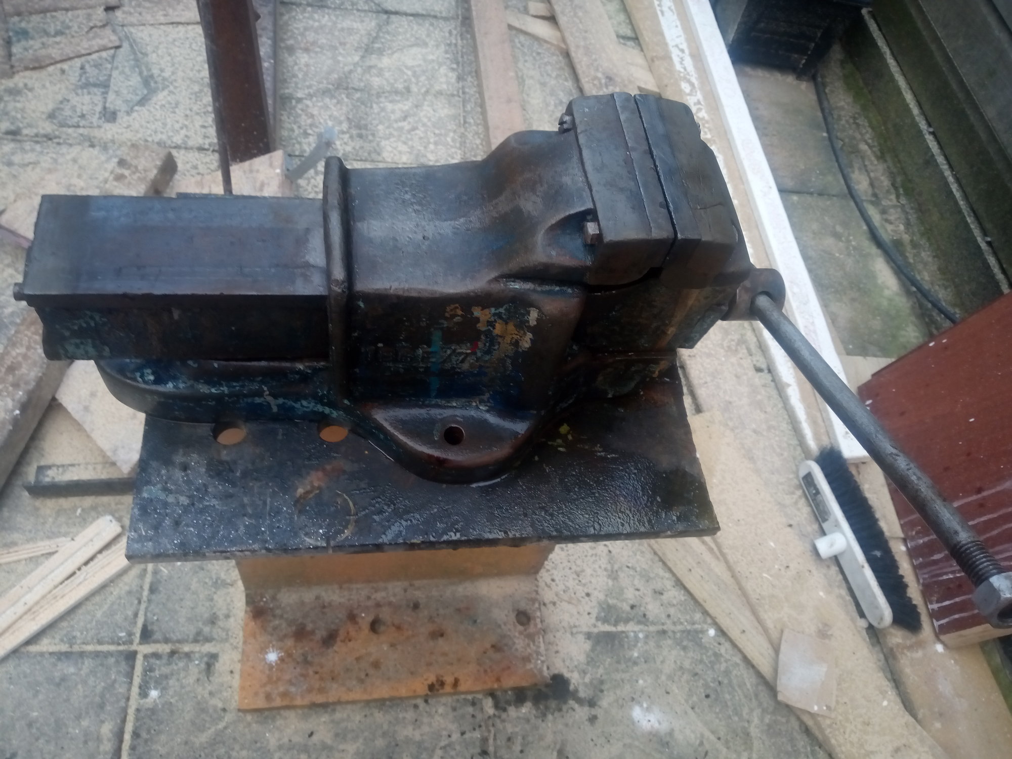

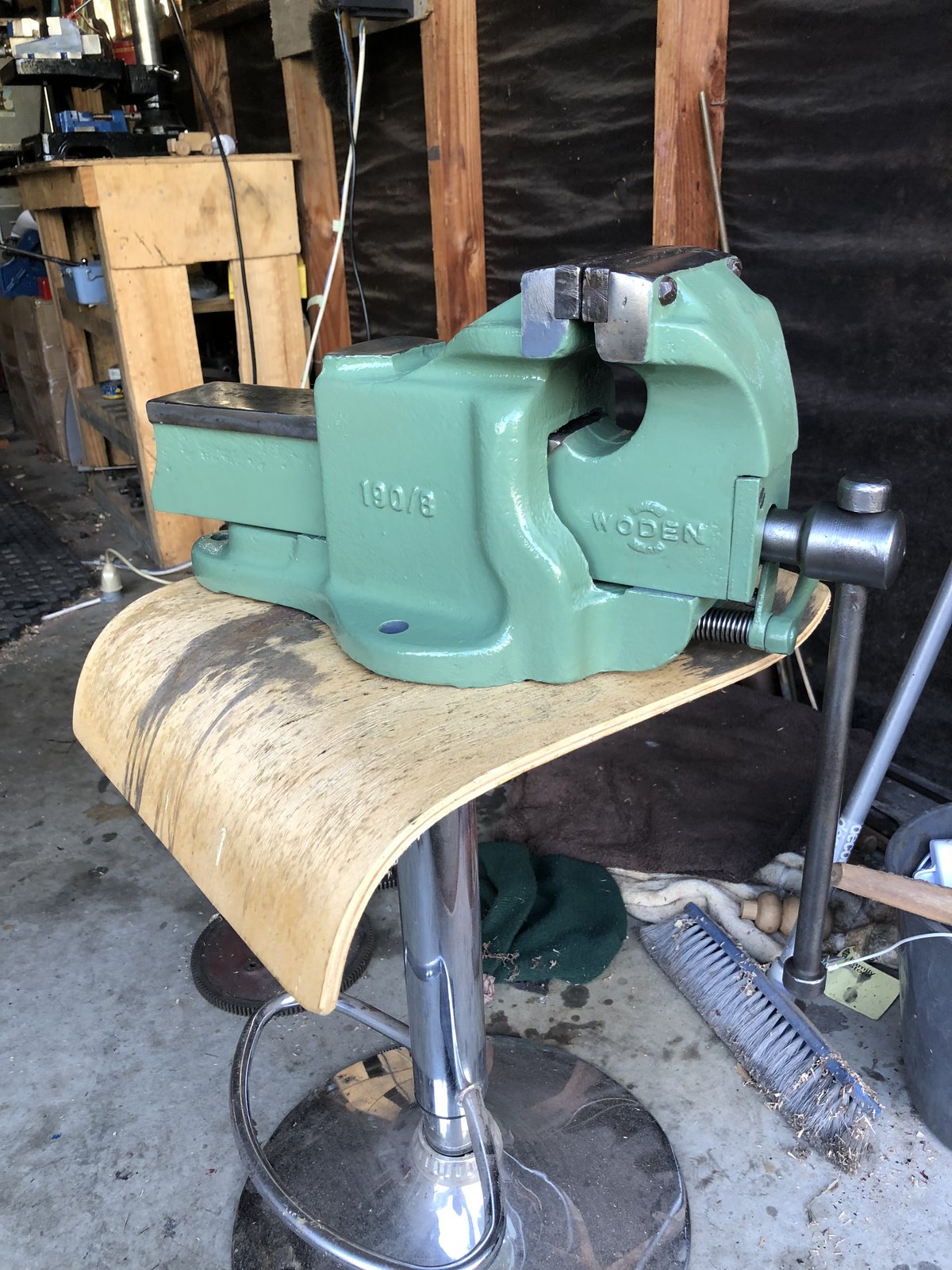

I got this woden 186e/7 for a fiver, probably going to live outside on the peice of rsj.
Best vice I’ve owned; has taken lots of work no hassle.I got this woden 186e/7 for a fiver, probably going to live outside on the peice of rsj.

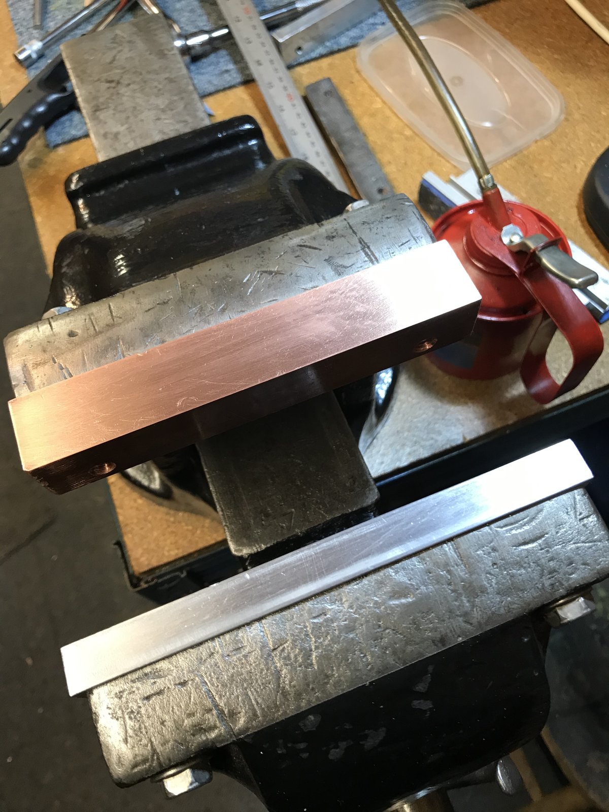

Knocking up some copper jaws for the Parkinson, 1" square stock was a mistake, I asked the loafer to take it to work and cut bar down the middle, not happening so I changed the wifi code - petty but satisfying- losing an inch overall opening is no big issue but should have got 1 x 1/2" - tapping all the way was probably unnecessary..

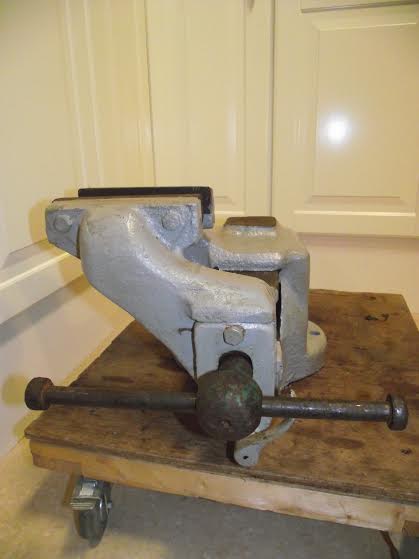

i just googled vintage jewellers vice and it looks like it may well be - well done.Removing Boy Scouts from horses hooves......sorry.....coat >door.
Possibly a jeweller's vice, given the size of the anvil?![]()
